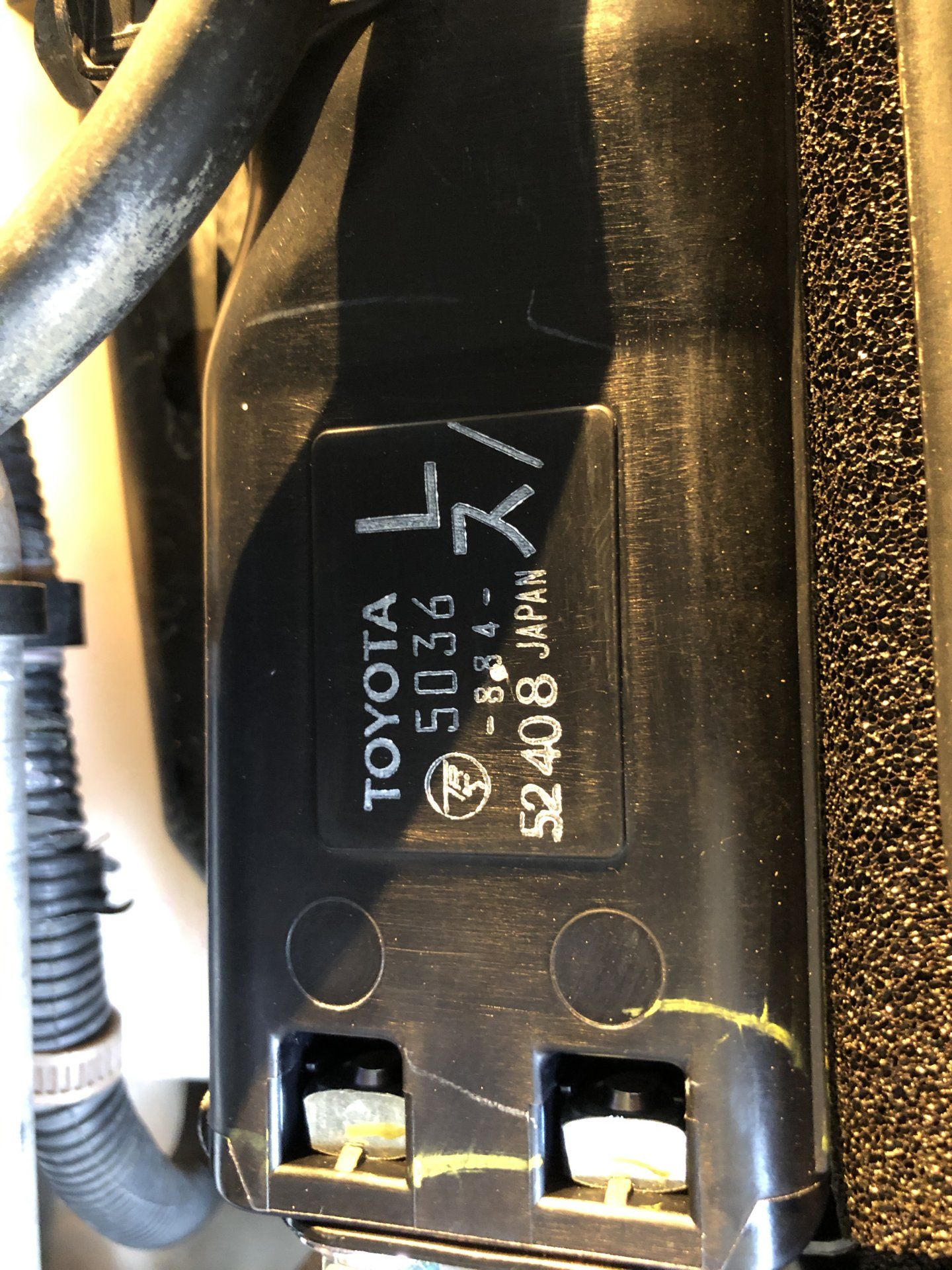

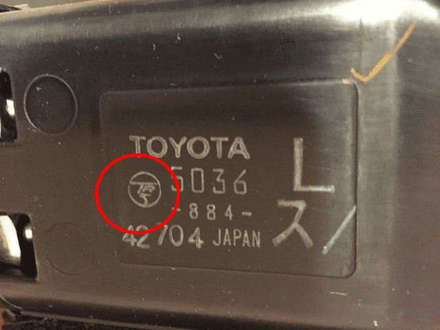

How can I know, is there a label or engraving on the original radiator that won't be on the replacement?
Look at the thread above with the OE radiator labeling. If yours is different than this it may have been replaced. You could also have your local dealer pull up the service history...this would only account for work done by a Toyota dealer. It would not account for a shade tree mechanic replacement. When in doubt, swap it out! Simply not worth the risk and its an easy job. #onebanana
Service history on my truck only goes thru first owner (about 60K miles) after that, who knows.
Mine doesn't have the Toyota label on it, but it does have the engraved letters on the right.
so....
I checked my radiator and certainly doesn't look like it's 20 years old, could have been replaced in the past.
This is an OE radiator. Look for the T.RAD symbol. But if 20 years old, yours will be barely legible.
