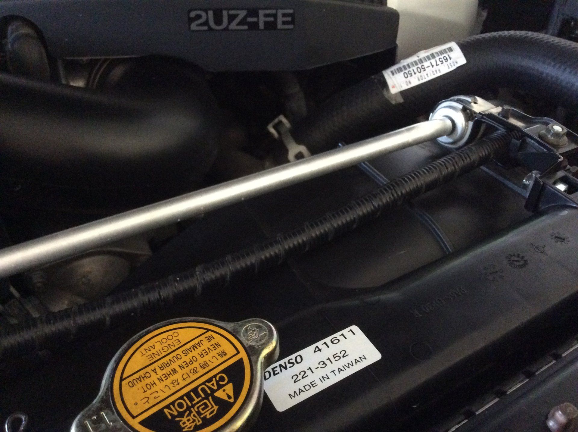

Got mine done today. This is what my independent Lexus mechanic told me was the OEM replacement.
$550 in parts (including t-stat, hoses and coolant). A little more than that in labor.
Not cheap, but it was done right the first time by a professional mechanic. Well worth the peace of mind while driving across West Texas in July on the way to HIH8 with my boys aboard.
I’m sure one could DIY for under $500. I’m busy working. Got no time for wrenching.

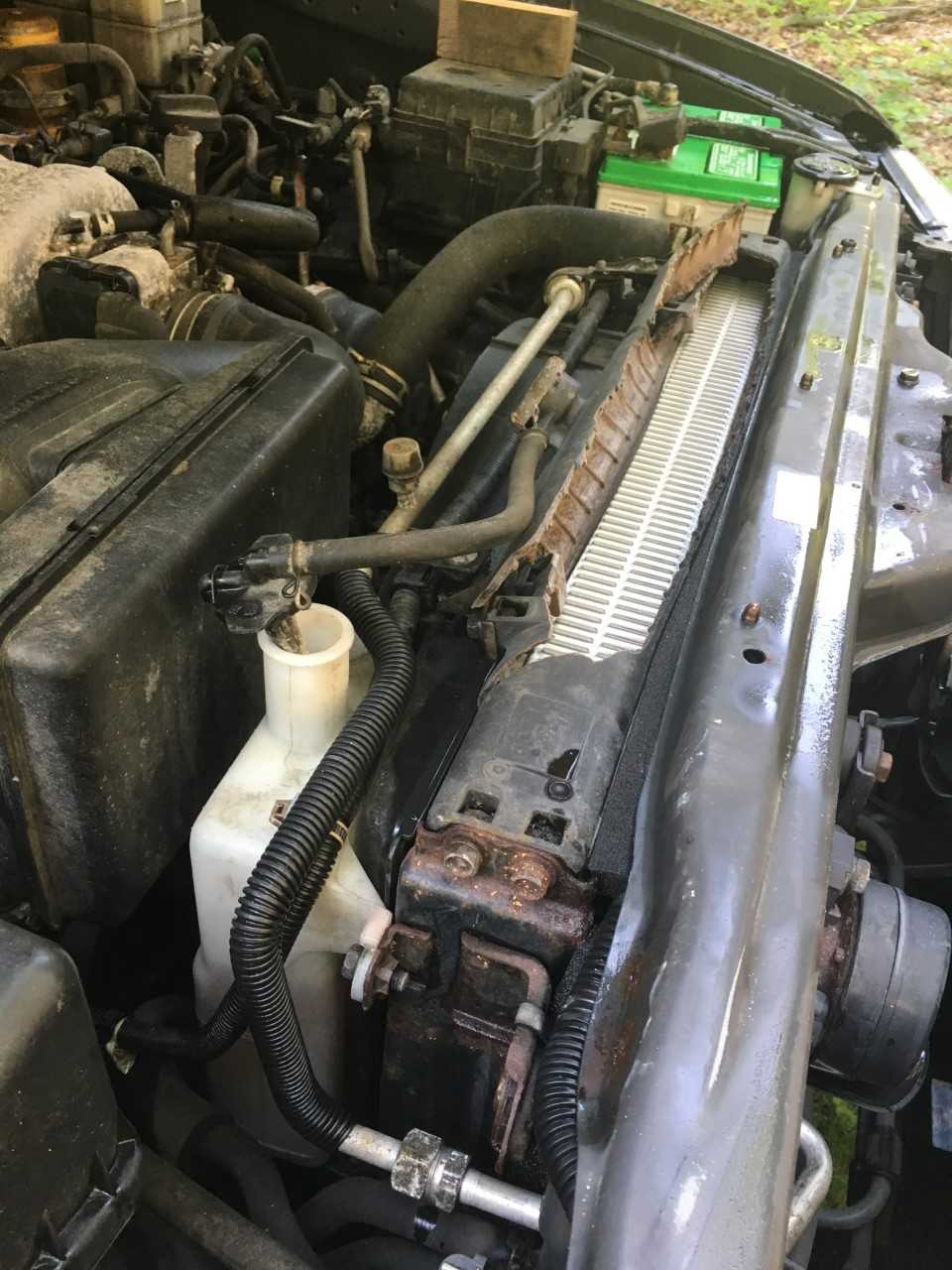

I just responded to an old post about my 05 radiator blowing up this week. This post is newer/more active and hoping you guys can tell me how much trouble I'm in...or send me part 2 of the movie so I can see what happens next. I'm the guy that didn't look at his gauges when he should have. Fortunately, I was only in my backyard. Where do I start and what else should I be concerned with other than replacing the radiator, thermostat, etc? It was running at idle for 30+ min on a hot day while trying to get my fj40 started. I got in to turn it around to jump-start the 40 and the radiator blew up. I did notice the check engine light, Trac Off and VSC lights were on when I jumped in to move it, but stupidly, didn't check the gauges in my rush. (In the moment I thought I'd tackle one problem at a time). I'll be travelling this week, but looking to get as much direction as possible to decide what to do when I get back.
How bad is it??
Prob ok since this happened in the back yard and you caught it and hopefully shut down as it blew up. Start with new radiator, complete system flush since there was a system over pressurization and may be some crud plugged somewhere, change hoses, new T-stat, new Radiator cap, check your heater T's and hoses, replace if older than 7yrs. Get a Scanguage or other OBD2 connected device so you can monitor actual engine temps and see how she goes.
View attachment 1738120 I just responded to an old post about my 05 radiator blowing up this week. This post is newer/more active and hoping you guys can tell me how much trouble I'm in...or send me part 2 of the movie so I can see what happens next. I'm the guy that didn't look at his gauges when he should have. Fortunately, I was only in my backyard. Where do I start and what else should I be concerned with other than replacing the radiator, thermostat, etc? It was running at idle for 30+ min on a hot day while trying to get my fj40 started. I got in to turn it around to jump-start the 40 and the radiator blew up. I did notice the check engine light, Trac Off and VSC lights were on when I jumped in to move it, but stupidly, didn't check the gauges in my rush. (In the moment I thought I'd tackle one problem at a time). I'll be travelling this week, but looking to get as much direction as possible to decide what to do when I get back.
How bad is it??
So did the radiator blow up when you went to move it? Or while you were away from the truck and it was running with no coolant for you have no idea how long?
If it is the first one, just replace the radiator and go.
If it is the second one, I'd fill the radiator with water using the garden hose, leave the hose running, start the engine and make sure it is ok before replacing anything.
It blew as soon as I turned it around. I just honestly can't remember if I turned off the car or if shut itself down. It caught me by surprise. Either way, it was off right away.
