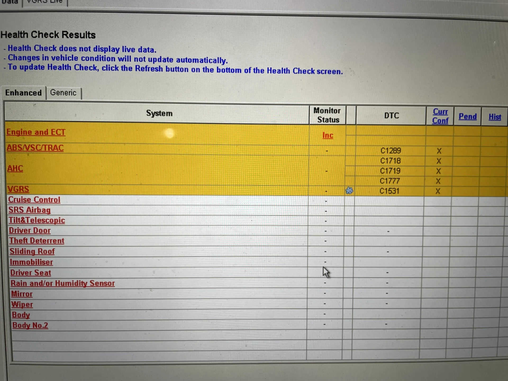

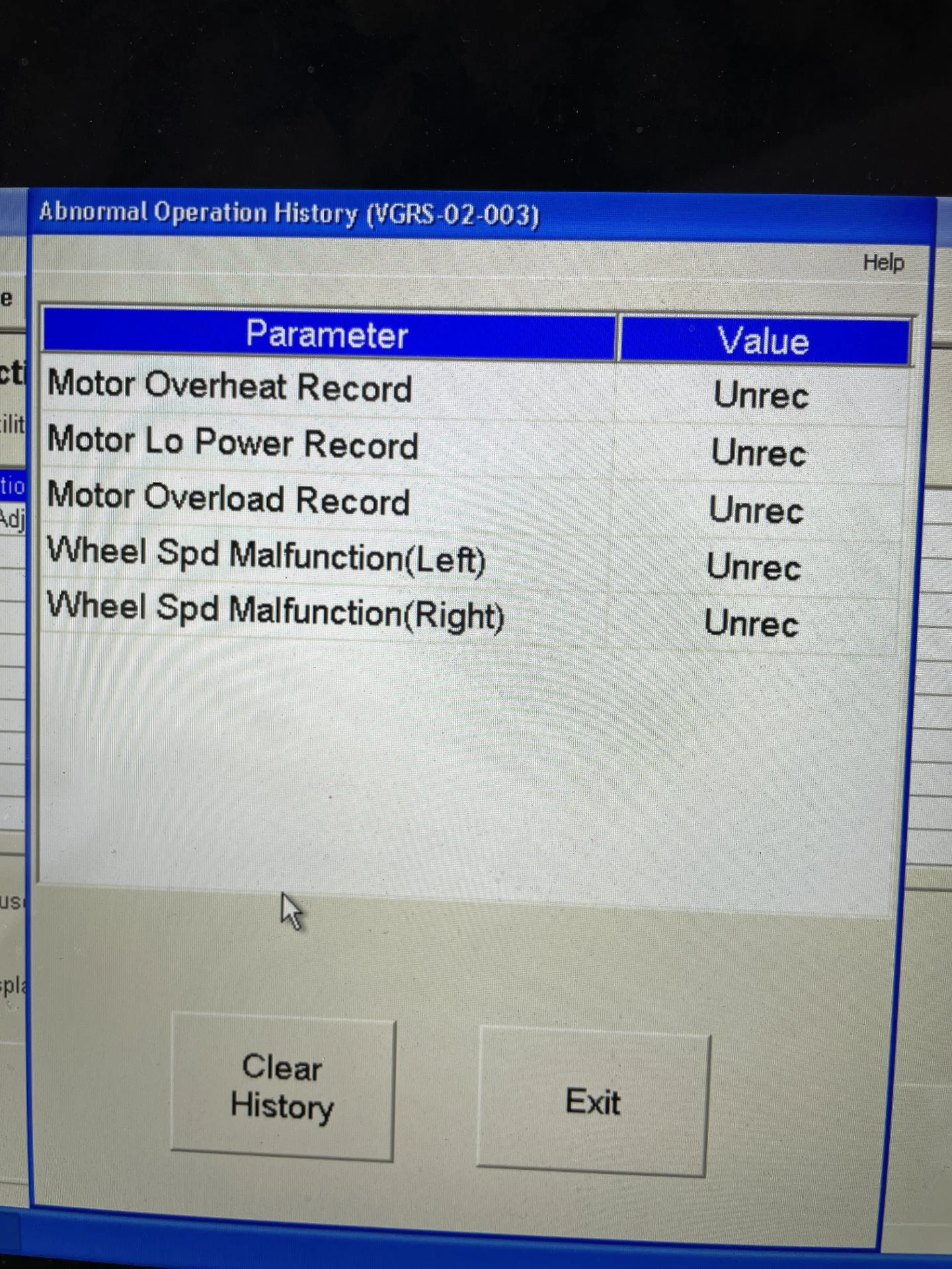

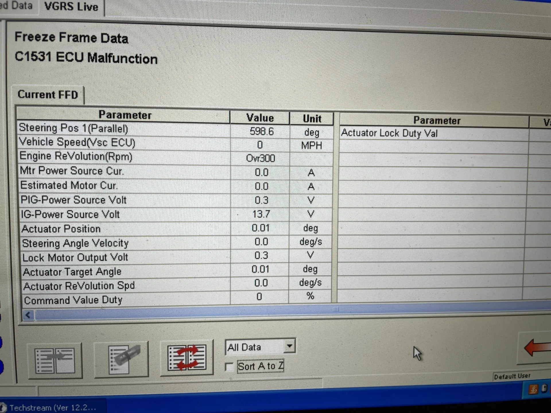

  • Codes from TechStream:
  • VGRS C1531 ECU failure
  • VSC/TRAC C1289
  • Further tests in TechStream give me "Steering Angle Adjust has failed and says DTC except C1515/C1516/C1532/C1568 are detected. Diagnose them prior to the Steering Angle Adjust." See screen shot.
