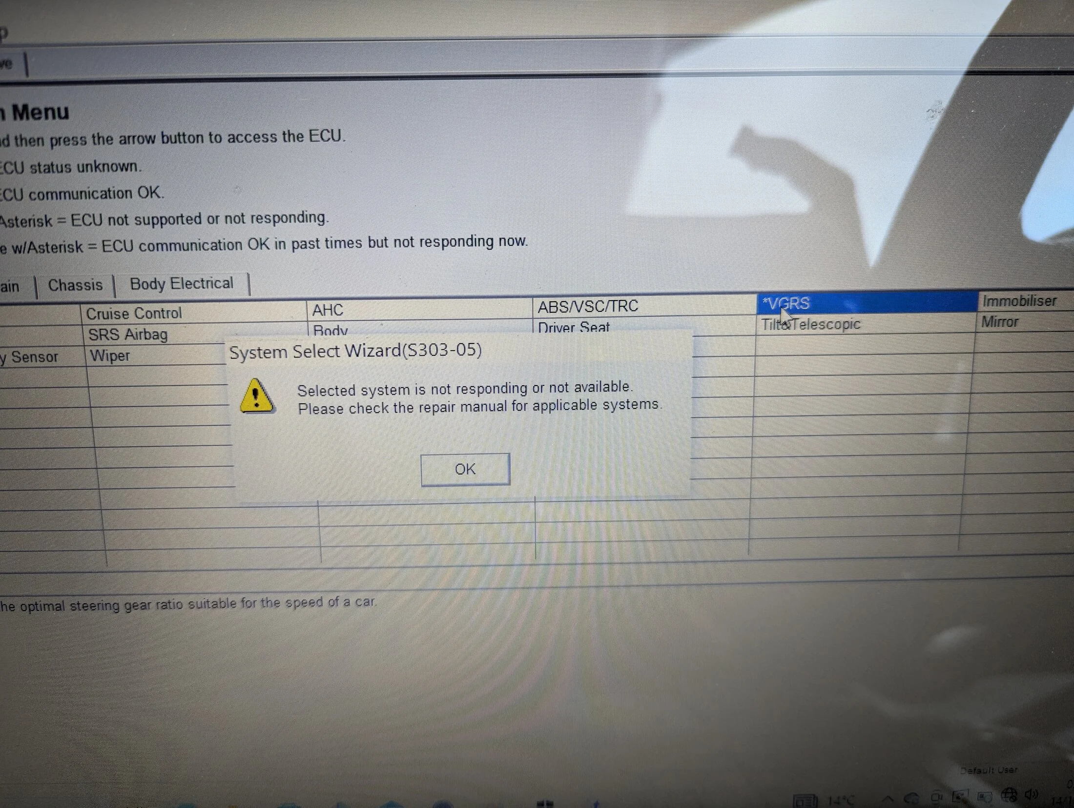

I'm going to plug in tech stream and see if it allows me to check VGRS but curious to hear people's thoughts.

I've checked on techstream, and there doesn't seem to be any connection with VGRS module, so I'm leaning towards it not having VGRS fitted. Any other insights welcome! I will say it seems like regardless of speed, it's not super easy to steer, so I'm thinking that's a combo of the rack being done and no VGRS being fitted to it.
Thoughts?

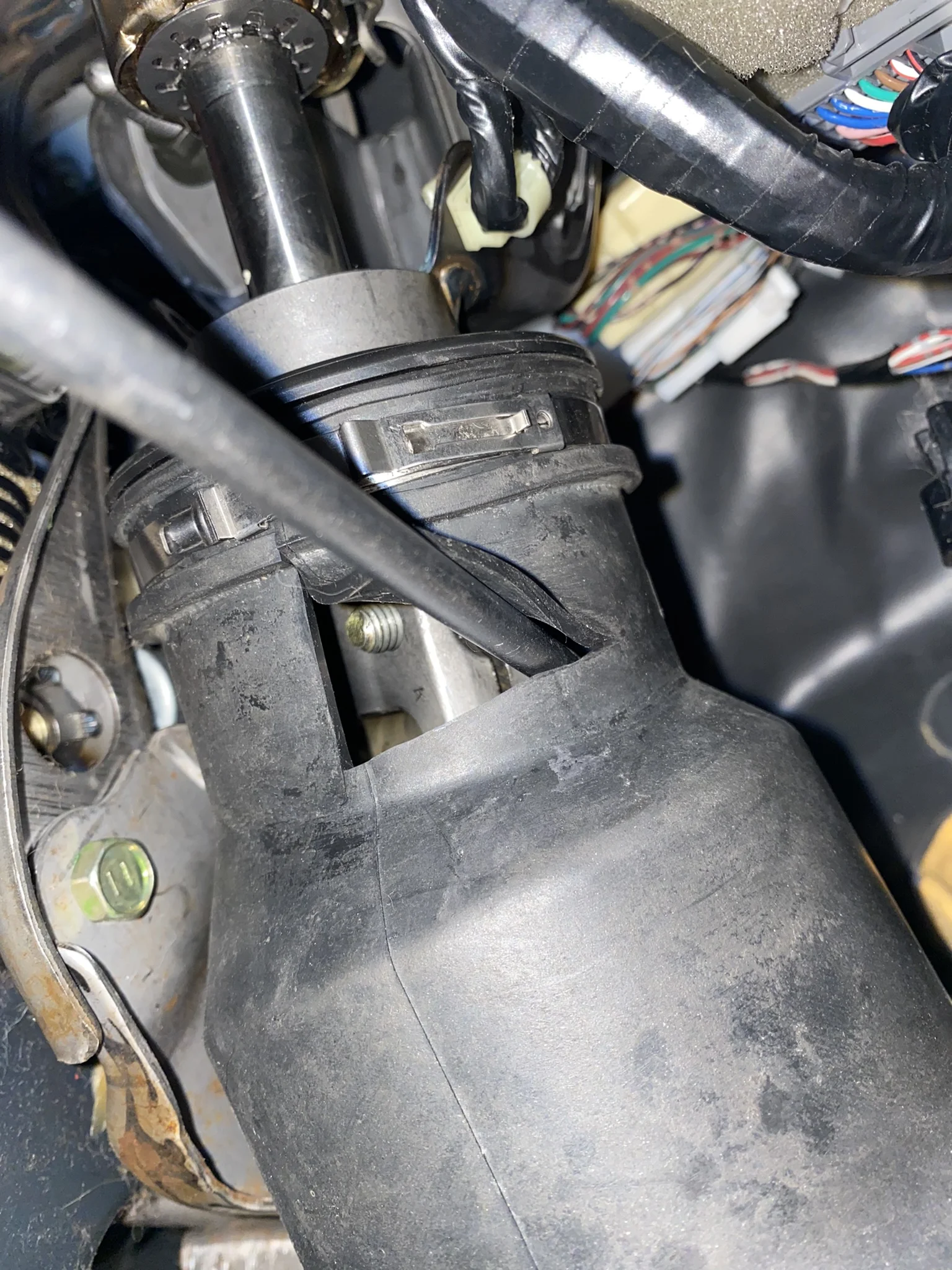

Easy to tell is VGRS system:
Large boot attached.
Note: Above is a VGRS system, steering column. Where we see the snap ring has come loose and slip down the steering column shaft, sitting near VGRS boot of VGRS actuator. This was before snap ring recall service done!
The below picture shows where a Lexus mechanic. Did a hack-job during the VGRS recall service, cutting boot of actuator (#1 intermate shaft in VGRS system). Which was only "tip of the ice berger" in making vehicle unsafe to drive after recall service.
After snap ring recall service. (boot should not be cut)

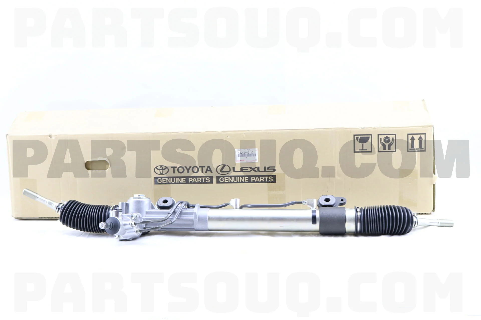

Also Rack & pinion, have idenfing paint marks
VGRS R&P, have a black line painted on them.
LC 03-07
98-02 LC or LX

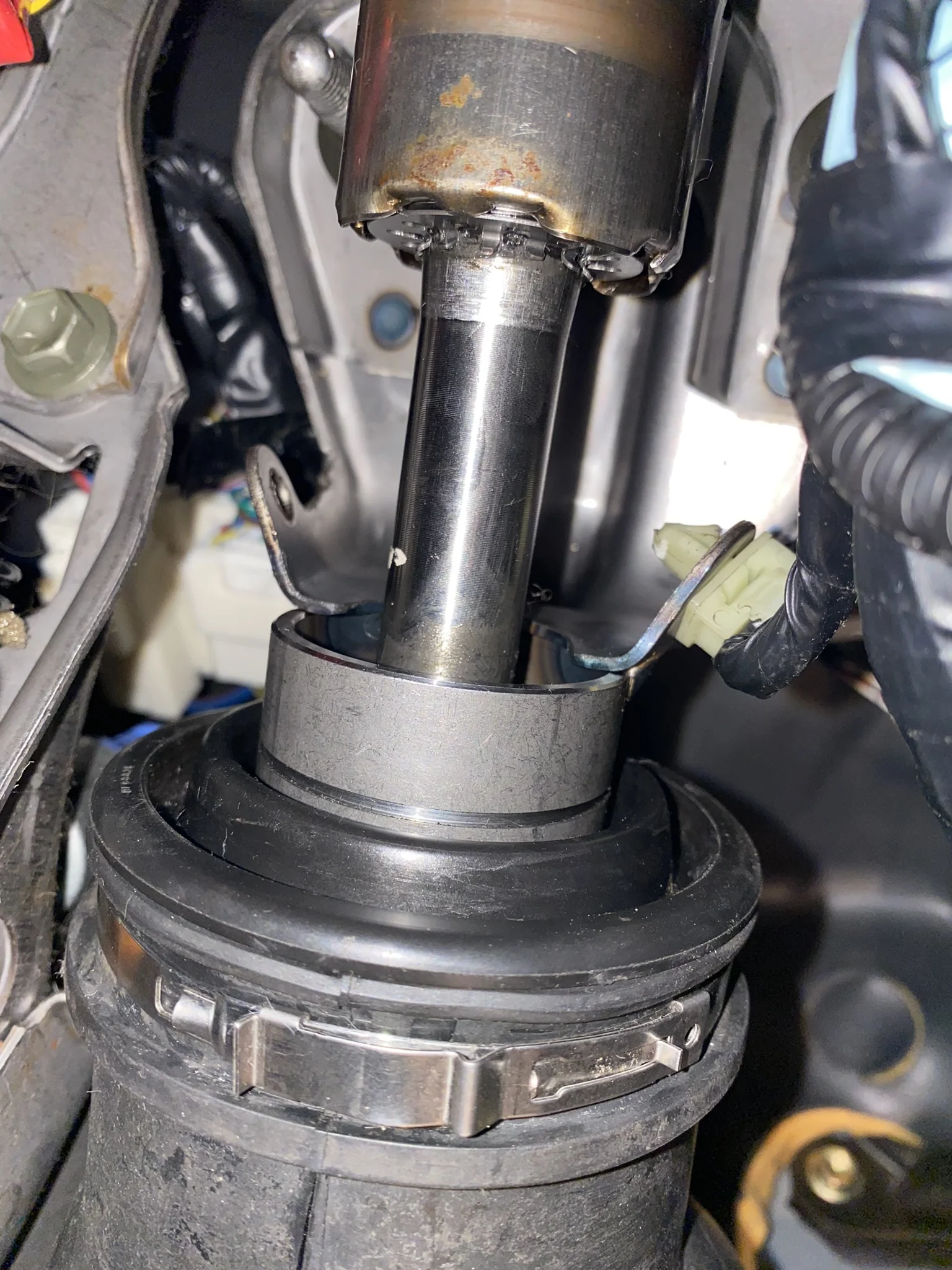

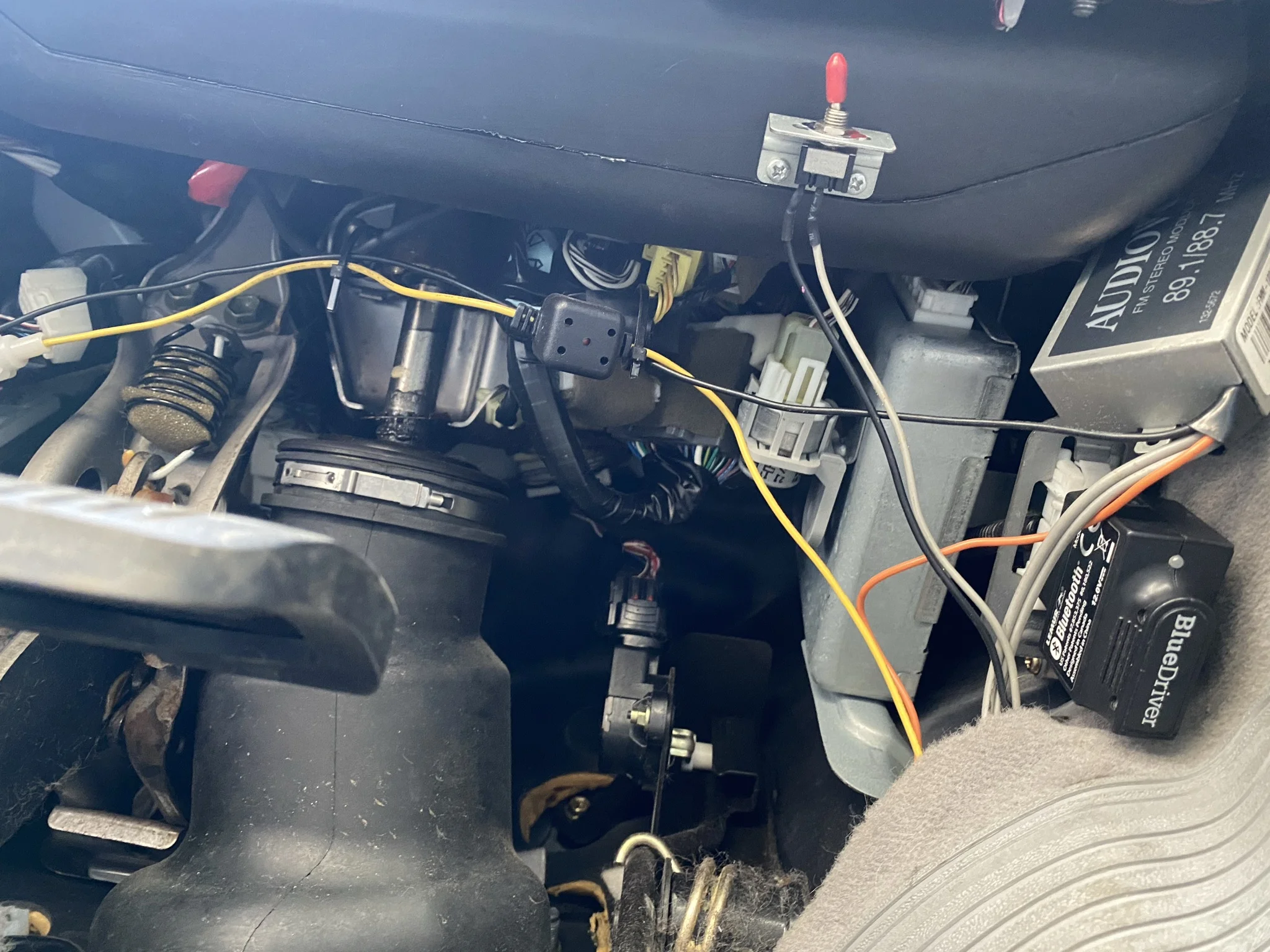

I opted to check in the drivers footwell (different side to you lot over the pond!) and based on the pictures you kindly shared - it doesn't look like mine has VGRS (no big boot).
Would you agree based on the below pic?
Thank you
Yes! Standard steering. No VGRS actuator.

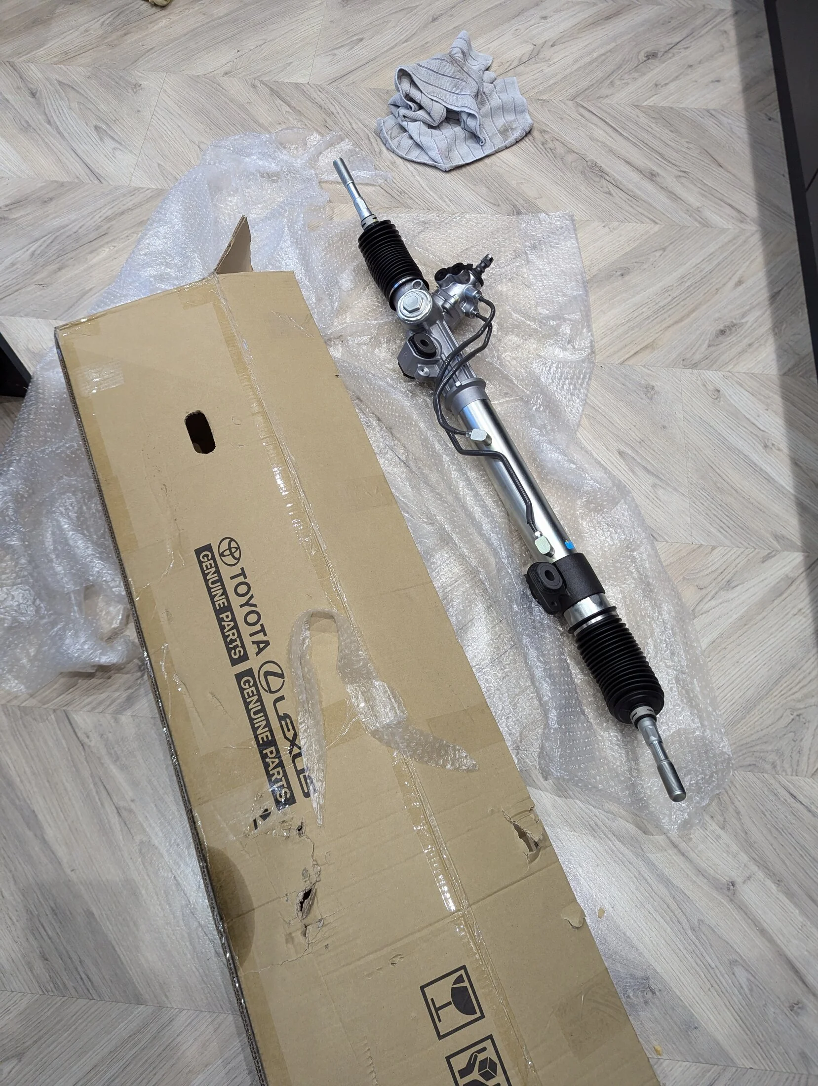

Dear @2001LC or anyone else familiar with these:
Received my new steering rack today from Japan but not sure if I should be concerned, and I'm interested for you take.
44200-60090 is what I ordered (green mark, suitable for my 2004, RHD, non-VGRS).
44250-60090 is what I received
I assumed it was a direct replacement of that original part number, but it has a blue stripe on the rack vs the green on mine.
I googled the part number and I've been presented with legitimate sites suggesting it's compatible (98-07, non-VRGS), and came across another which refer to it being remanufactured (which I obviously don't want).

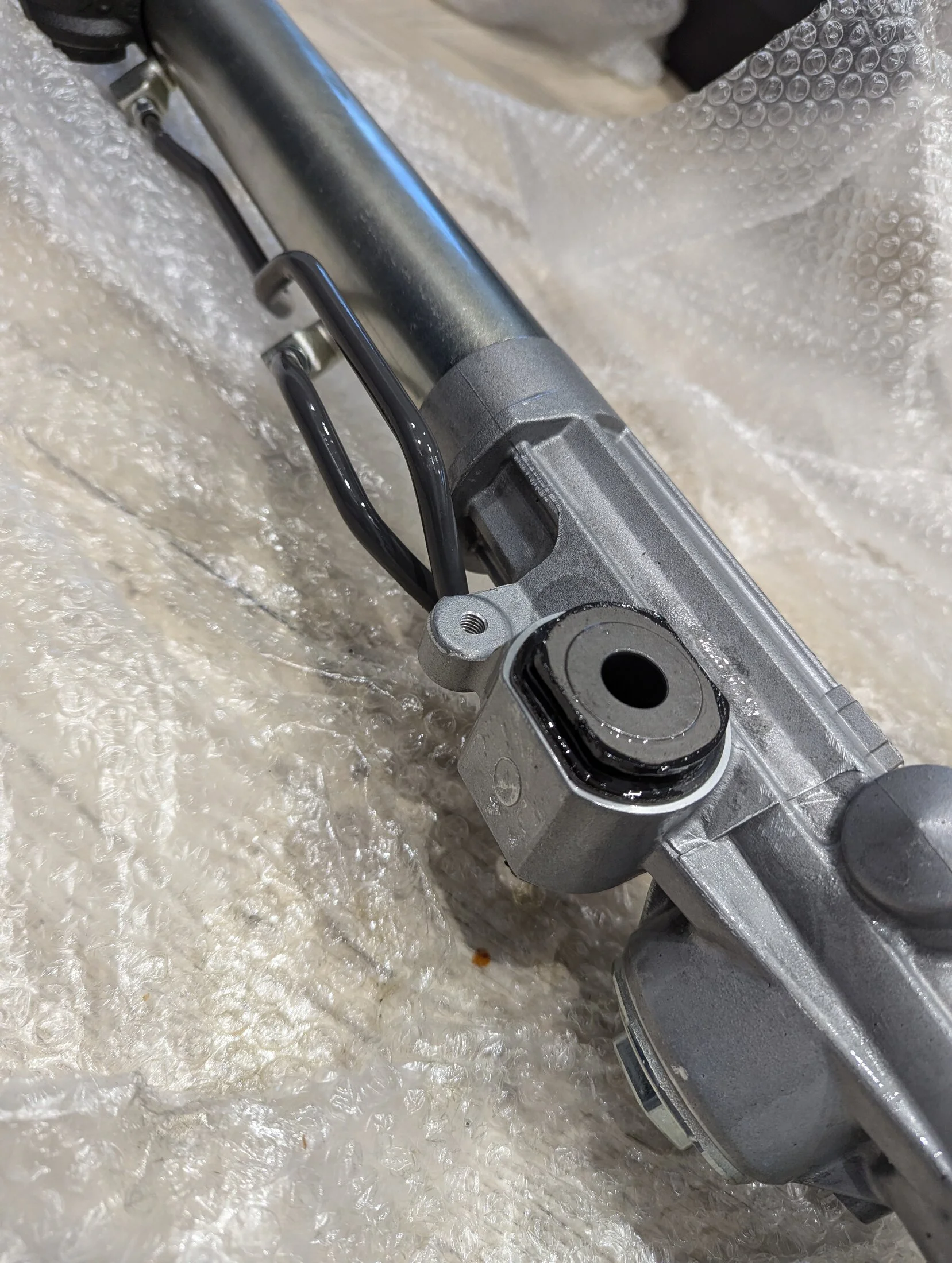

Excuse shiny-ness in pics on some components, the bung didn't look secure so fluid has leaked a bit during transit.
Anyone shed any light on this?
Thanks!

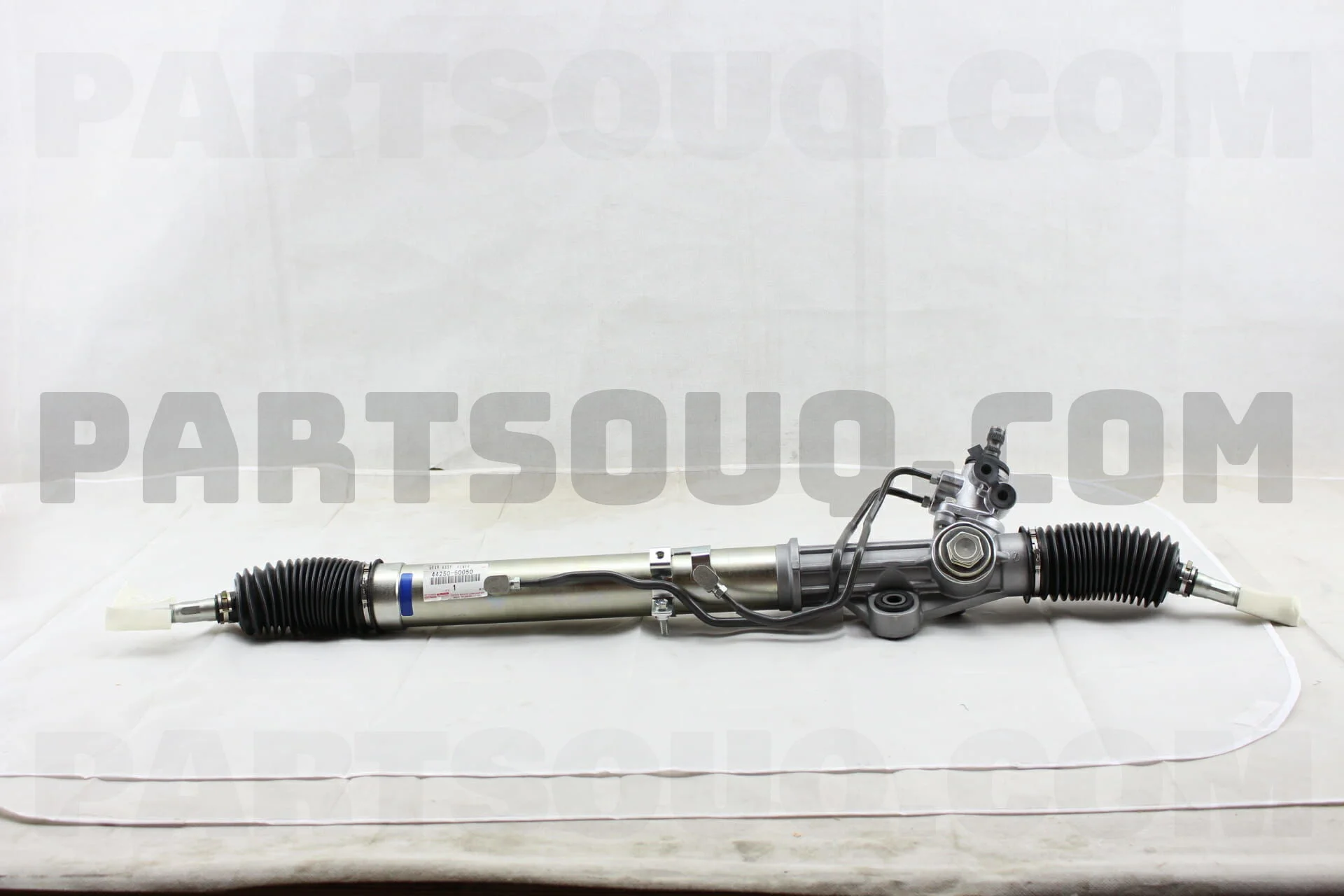

I can't say, as we've LHD. But blue in LHD older type .. They mount differently.
Looks darker blue.
Go to www.partsoq.com with VIN# drill down on part. See if it subs.
Looks darker blue.
Thanks, partsouq suggests it's a substitute so hopefully all okay.
The older type blue has a bracket pictured which the green type and the one I have been sent doesn't, so I'm hoping all of this combined suggests it's good to go.
Am I right in assuming these come with some steering fluid in them already and then bunged with the rubber grommets?
Thanks
No fluid. Just light coating of assembly oil. The plugs, keep clean and protect threads. Keep them in until R&P install, and ready to hook up lines
The color marks on pinion input shaft, boot and pinion housing. Are Rack centering marks. They work very well..
