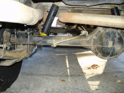

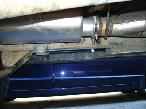

I don't have any pics of the muffler but I'll see about taking one or two and post to this thread. I do have a 2 inch body lift which give me a little more room. Basically I have rams horn manifolds...driver side exhaust runs straight back into one side of "y" pipe, passenger side runs back from manifold to rear of transfer case and then goes up and over rear area of transfer case/driveshaft into other side of "y" pipe...Y pipe mates to front of muffler. Muffler is generally in the same stock location as Toyota OEM. Muffle is a singe in, dual out. Then dual pipes come out the muffler and one exits up high just below the frame on the left and one on the right to keep the pipes from being crushed in the rocks. Again so no confusion...my truck has a 5.7 vortec and shares the similar layout on the engine as the 5.7 family of engines.
not the best pics... some of my exhaust has been modified here and there...but on my truck the muffler does not hang down below the frame rail, but again I have a 2 inch body lift. I need to fab up a little protection for the tail pipes but for now everything seems to be good..of course things get bent and beat up off road. And we had to rig a little on the crossover behind the rear of the transfer case the last time 001.webp 002.webp 003.webp

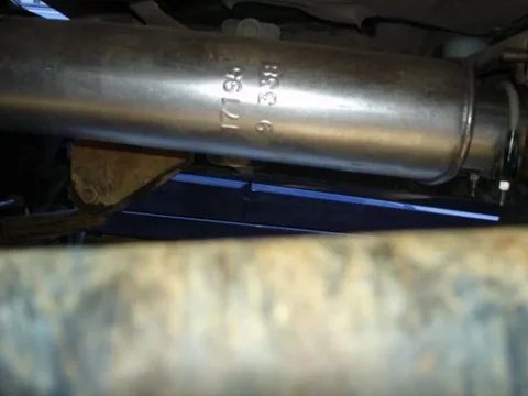

I read the part # in the pic: 17195, the SoundFX Universal

its a little hard to see but look closely at pic #1 above and at the far right you can see a portion of the magnaflow y pipe and see it welded to the front of the muffler.
Looks Like I have a Walker 17195 muffler.... engine side is connected to the single pipe, exhaust side it connected to the dual pipes. Not sure how long this muffler will last...but I think you would be good with any OEM type muffler for a GM pickup with 5.7. My muffler looks likes its the universal fit type thing and it appears that there are other similar mufflers in size and configuration that might be of better quality. I had to get mine fixed with what he had in stock that day. When my exhausts takes a hit or whatever...I'll replace the entire thing and look for a similar muffler but probably one out of SS steel or fully welded. So while i like what I have...I think there are better quality made items from Walker and others of similar configuration.
