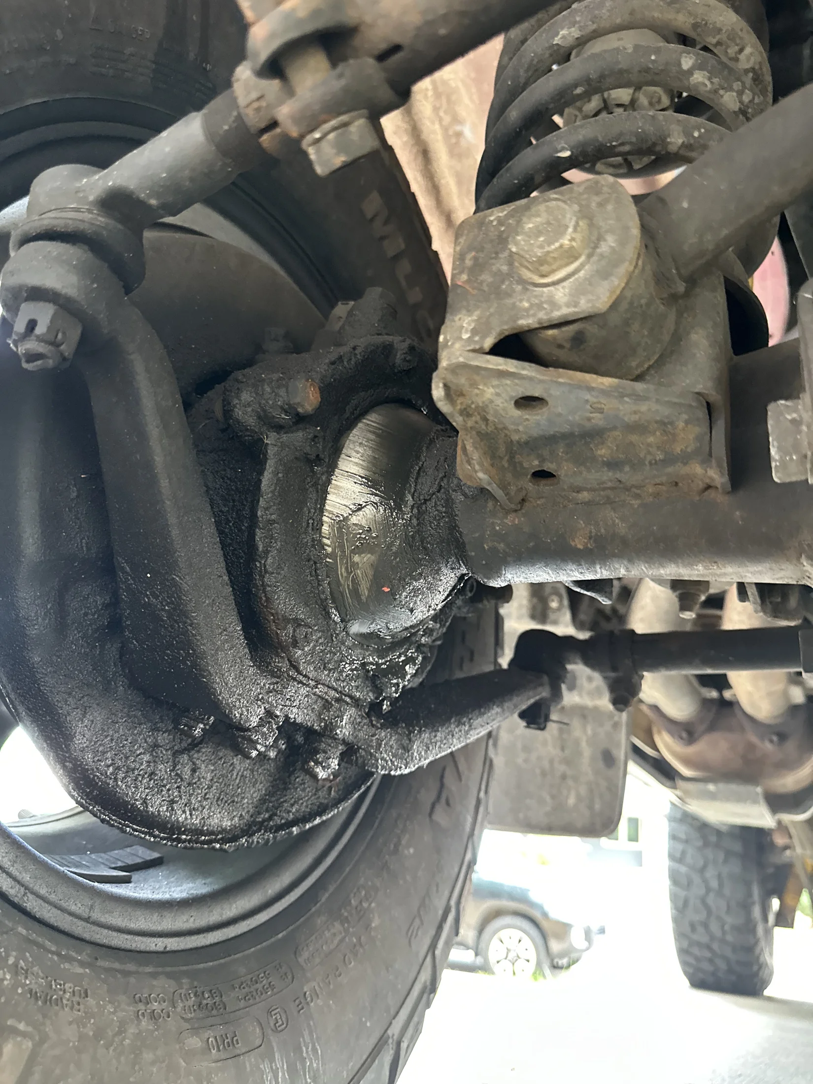

Hi all - prospective 80 owner here that’s been shopping for a couple months now. Curtis to get this groups take on this birfield. The consistency was liquid like a light grease than something heavier. Was wondering if this indicated axle seals are done. Just trying to assess quality of this rig.
Yep, time for a rebuild but that wouldn't impact my interest if all else checks out. I'm probably going to do a full axle (plus other baselining) service soon after purchase in most cases anyway to confirm that everything is right (steering arm studs/nuts, kingpin/trunions, etc. etc.).
Use the required rebuild as a bargaining chip if it's useful but if everything else is up to snuff then I would just plan an immediate post purchase knuckle service.
Birf soup. The good news, no rust.
Yeah Im really considering this one. Zero rust, engine and trans seem to be tip top. Interior is intact and all electrics work. Has a couple aftermarket mods. For 15k.
Doesn't look all that bad, ie: still drive-able until you can get it fixed.
IMHO it's important to not get focused on that leak (which is very common but not expensive to fix) because the biggest ticket potential repair on this model is a leaking head gasket. That repair could run from a few thousand up to $15,000 if the engine needed replacing, and that does happen.
You could ask the seller if the head gasket has been replaced and/or if he/she suspects it needs replacing, they may not know but either way don't take their word for it.
If you are serious about buying that 80 Series IMO you could take it to an experienced Land Cruiser mechanic and have them perform a complete inspection including tests for a leaking head gasket.
