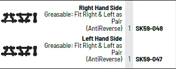

I just got a Dobinsons 2" lift Leaf kit and I am not understanding the difference on the anti-inversion shackles. I reached out to Dobinson's and their answer still left me scratching my head.
They supply 2 pairs of shackles - each pair with a different product code (047 & 048).
I reached out to Dobinsons. They said they are side specific and sent me an info-graphic:
#048 labeled Right Hand Side & #047 labeled Left hand side ---- But then the description says they "Fit Right & Left as a pair" under each item code.. that seems to suggest they're front/back specific?
Can anyone help me understand the difference between these shackles?

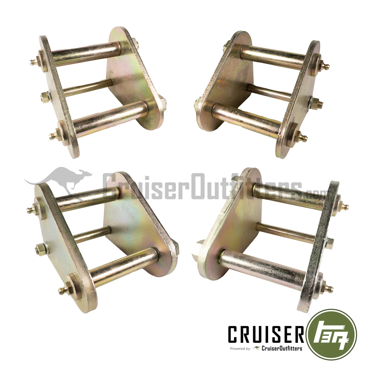

The orientation of the zerks is the difference between left and right pairs. So you do need two pairs, one zerk orientation for the left hand side (front/rear) and another for the right hand (front/rear) side.
