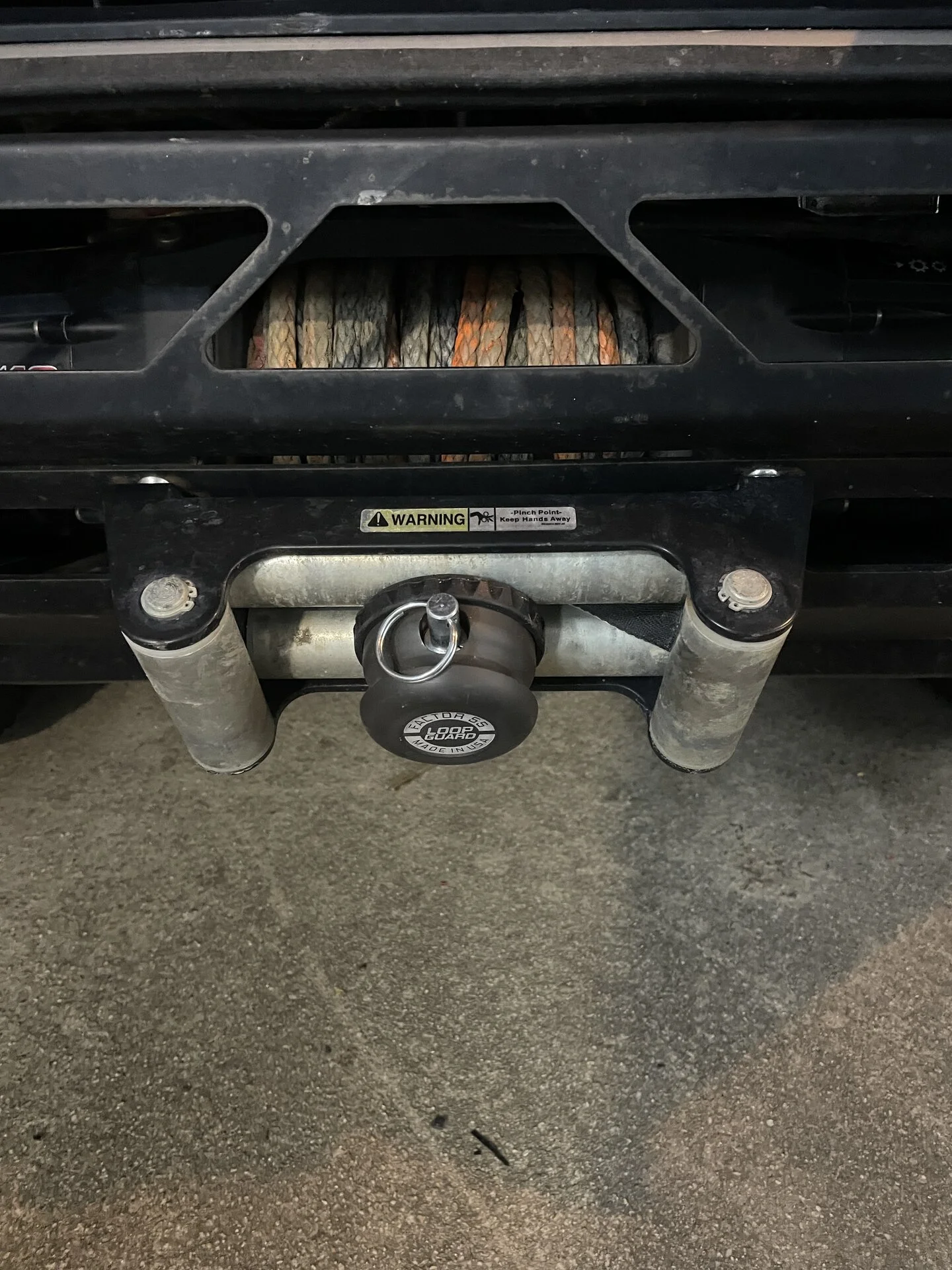

I am using a Xeon 12, Safe Xtract Line (60'), Roller fairlead, and a F55 Loop guard.
I used it yesterday in fact..

For those running a winch line w/o a hook or flat link (just the eye on the rope), are you still using the metal rope thimble or have you deleted that too. My existing Spydura Pro Synthetic rope would need to be cut and a loop spliced back in to take the thimble off. I'm not excited about doing that but in theory, that should be fine if done properly. Also not sure I can find a replacement winch rope w/o the thimble. I've seen extensions with soft loops on both ends but not replacement winch line, though I haven't looked hard for it.
Edit: The Safe Xtract Line (60'), linked above by @rlynch356 has a soft loop on the end. I think that answer's my question. Seems like the way to go. Still curious how many folks run this way.
That thimble is there for a reason. The synthetic line needs the larger radius for full strength.
