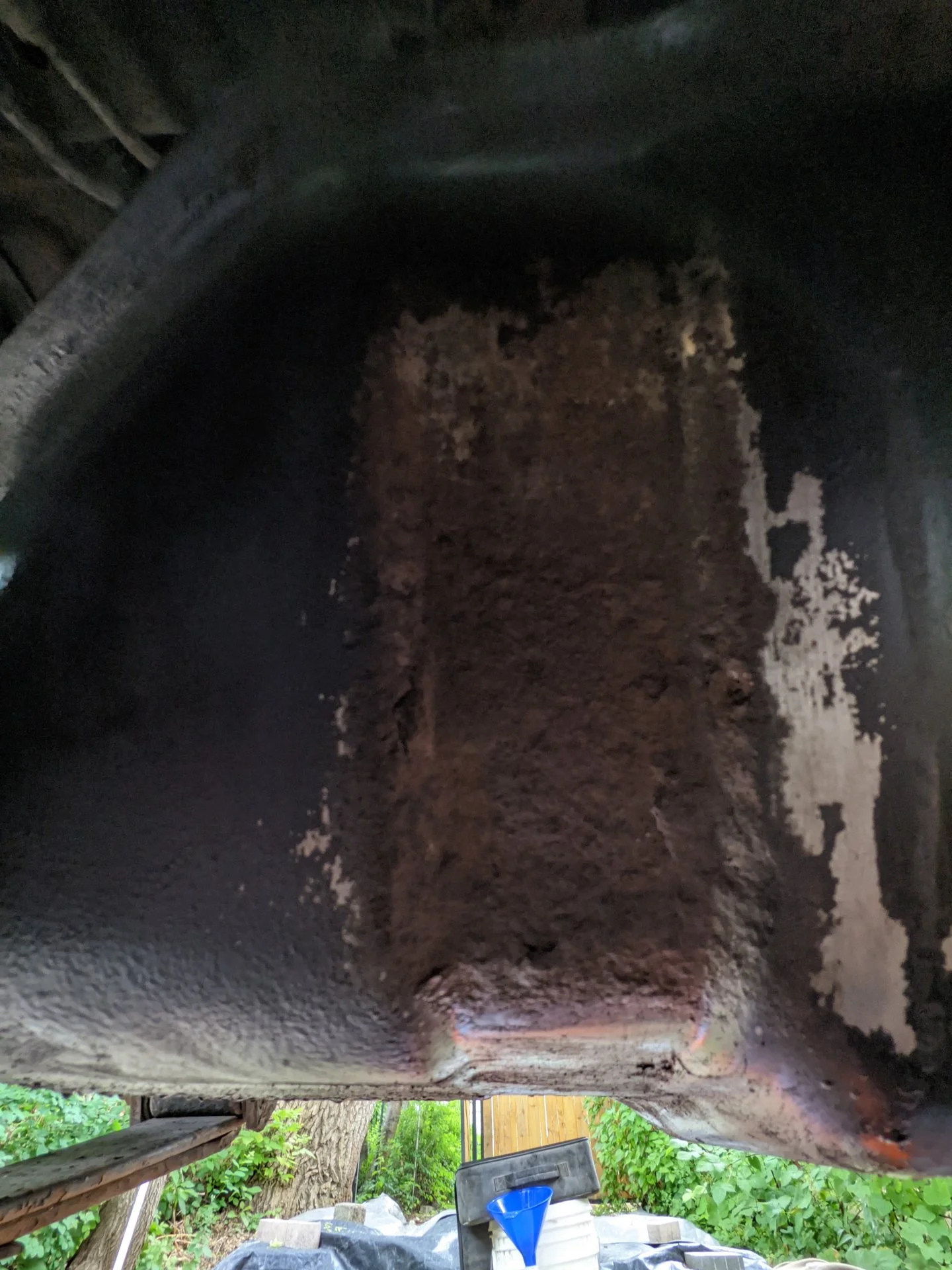

Hi there,
I've had a small leak under the tank for the last month or so and finally decided to empty the tank, remove the straps and shield to have a look underneath. Overall the tank is in pretty good condition but in one area where mud/water has accumulated between the rubber pads and the tank there is a severely rusted patch and I can see diesel is seeping through the rust. I'll attempt a temporary fix using a Permatex tank repair kit (epoxy clay similar to JB Weld) as I'm leaving soon on a trip.

I had a similar situation, far from civilization and used seal-all and blue shop towels to stop the leak. It wound up being a permanent fix. Even with the diesel washing the seal-all out it was able, with a few reinforcing layers of towel to set up and eventually fill the hole. I always keep some in my toolbox now.
