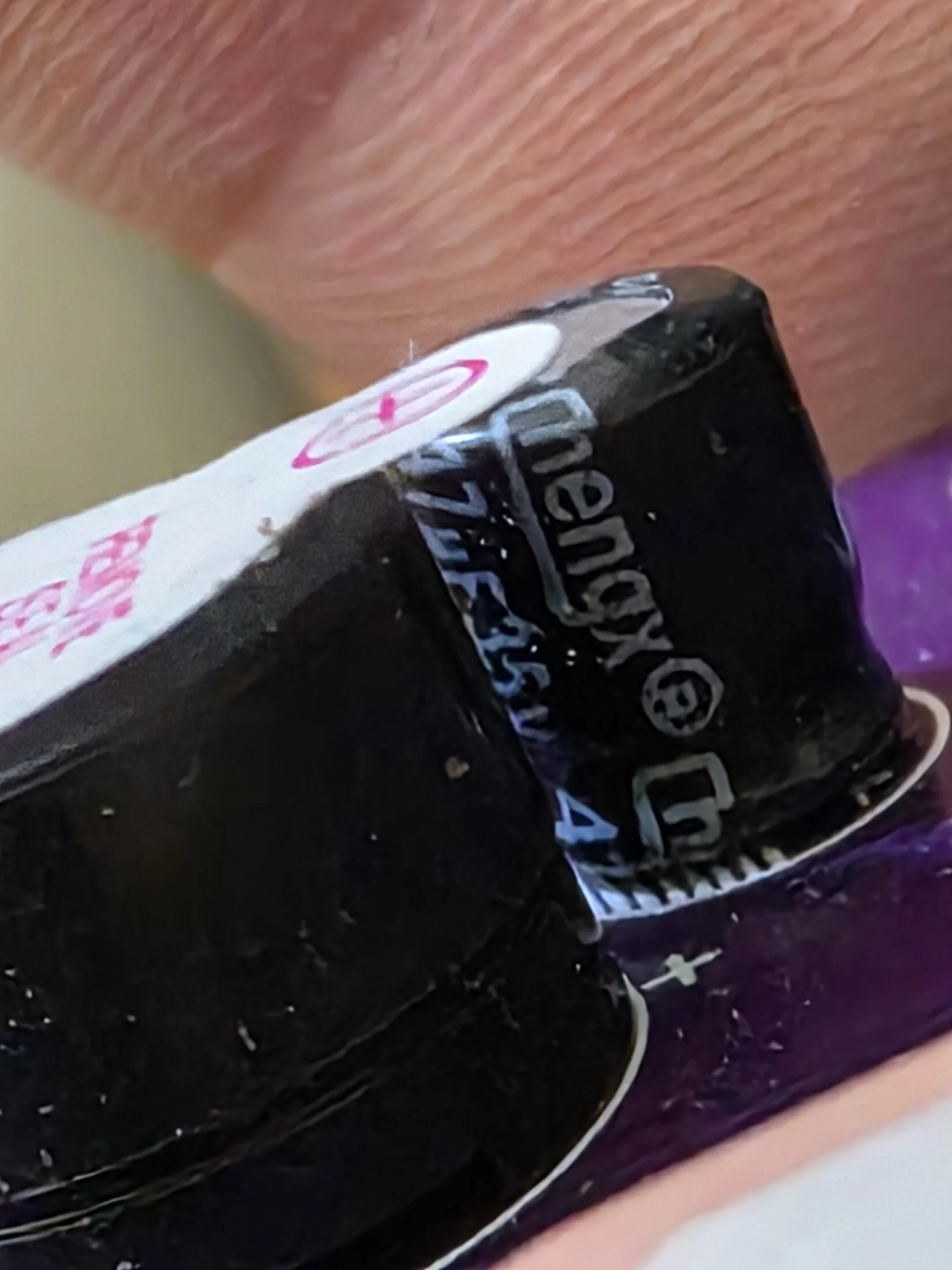

I had mine ready to go, but reversed polarity and blew the C5 capacitor.
Can anyone post a pic of C5 with specs so I know what to replace it with?
