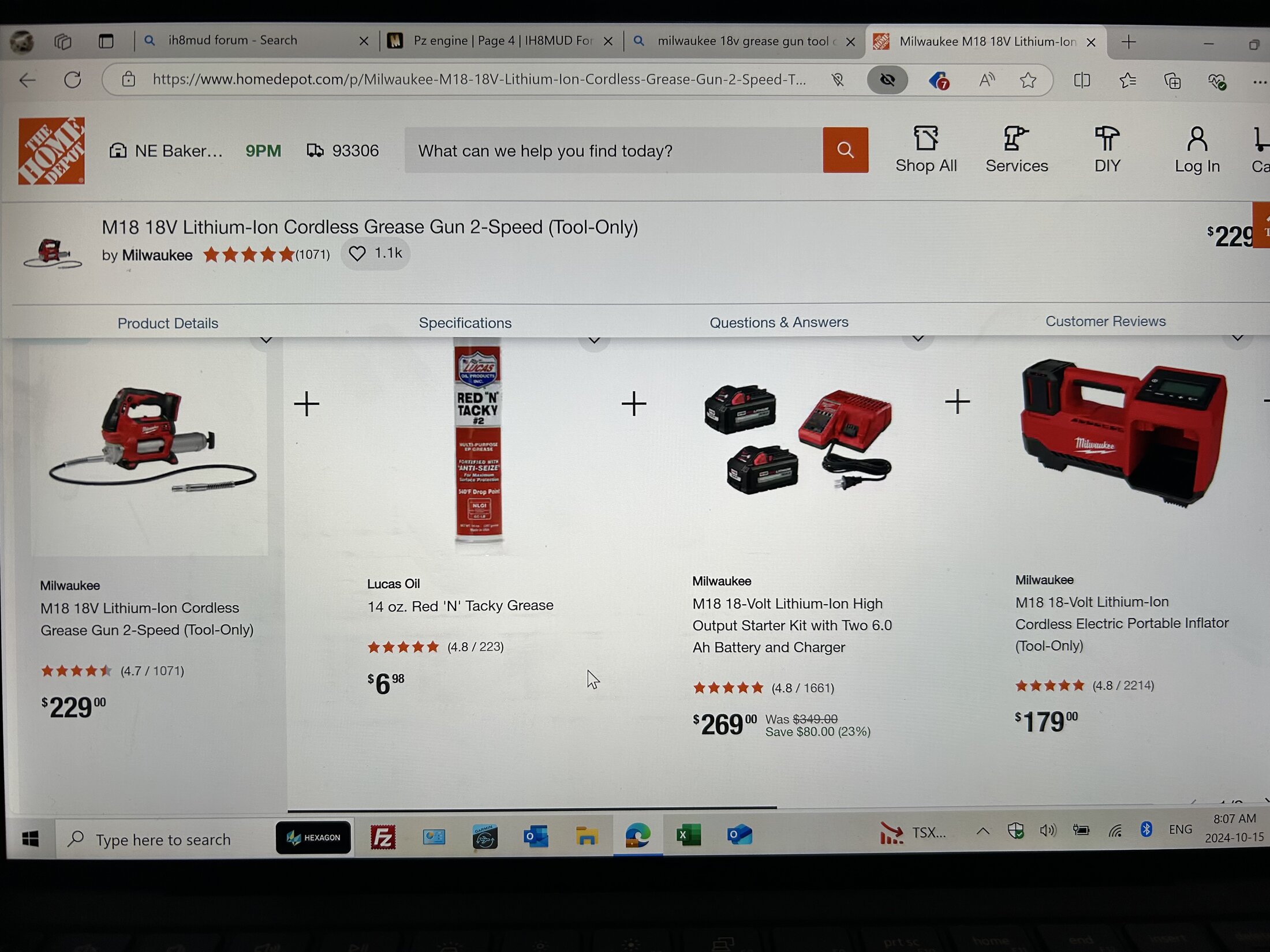

Price at HomeDepot here in US. Good god! $229. I like they link it to the Lucas Red N Tacky that I think a lot of us use. But the Lincoln Electric electric grease gun is $156 Canadian at Lordco so if a person can get any kind of account reduction it’s a no brainer. Lincoln Electric wins this one. The Milwaukee is 7.7 lbs without battery! Too much.
Price at HomeDepot here in US. Good god! $229. I like they link it to the Lucas Red N Tacky that I think a lot of us use. But the Lincoln Electric electric grease gun is $156 Canadian at Lordco so if a person can get any kind of account reduction it’s a no brainer. Lincoln Electric wins this one. The Milwaukee is 7.7 lbs without battery! Too much. View attachment 3750297
For the amount I use it the cheap no name one I have is fine... If I used it every day then a nice name brand is probably worth it, but realistically I use it a few times a year and just do everything...
The air powered grease guns are pretty cheap. I could see trying that. I don't think I'd fork out even 150 for an electric one.
Most of my grease points are just one or two shots anyway
Neighbour had a couple crane trucks so I can see why he got the milwaukee.
I got to admit, I have a muscle separation in my right shoulder so I have issues now with the constant triggering the grease
gun, among other actions. So I need assistance. Never thought of air driven. Maybe that Lincoln Electric is air driven? Scott
has one so I've asked him about it.

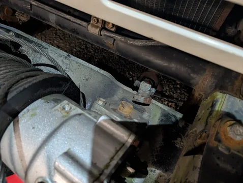

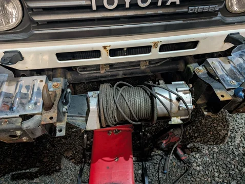

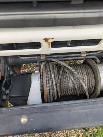

Lost the cable off the side and snapped off the shear pin. But of a pain to get to.
Read online about folks upgrading them with a bolt etc, have sort of mixed feelings, obviously would rather replace a shear pin than the winch... Anyone with personal experience / suggestions for what size to replace it with or a suggested rating?
Stock looks like 5mm steel pin?

I'd probably just get a few regular shear pins. Maybe some tractor pto ones that'd fit and be cheaper than whatever Toyota charges...
Wire off the side is probably a rare occurrence.
Could maybe cut 50 feet off to get it deeper in the drum if it seems like it's gonna be prone to happen a lot?
Looks like that shear pin did its job to perfection. I agree with seapotato just try to find a few to keep in glovebox. That looks like 150’ of wire there? What were you doing when it happened?
Yep agreed it did what it was supposed to. Just when i searched for part numbers I found lots of people replacing them.
It's in a quite inconvenient spot, directly on the back of the winch, which would be rather difficult to get to if properly stuck yourself. I had to pull the winch to get access to remove it.
As for what I was doing, pulling out a stuck forklift... Approx 4600kg stuck up to the axles...
Pull was a little off center and I didn't notice the cable had built up and popped off the winch
You might be able to monkey with your linkages and have the shear pin at a different ujoint.
Although under the truck might not easier to get to :lol:
