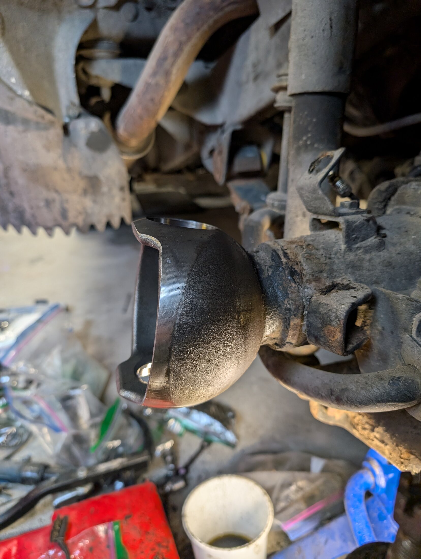

Well finally stated working on the truck some, decided to do a knuckle rebuild with wheel bearings, brake disks, and all new new tie rod ends... Have been having a bit of a wobble when driving which is annoying.
Honestly inside the knuckles looks pretty decent, probably wasn't really needed but now that I've started it's getting all the new parts...
Bit of an interesting wear pattern... Can't remember if the last rebuild had a similar pattern but I guess that's pretty normal since that's the part that would be exposed to the element while turning.

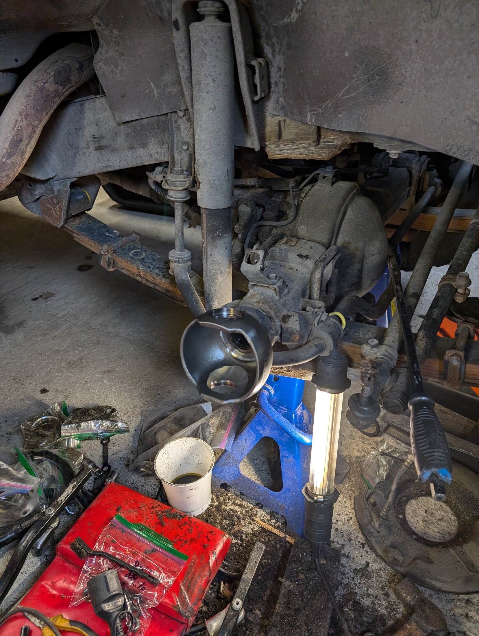

also pretty sure I spotted the steering wobble problem while working... can anyone spot it?
My best guess would be worn TREs.
Not much else left in frame. The spring bushing look ok. Sway bar isn’t needed so it probably won’t cause a wobble. Not much else to look at. Loose u-bolts or spring plates… but they appear ok in the pictures.

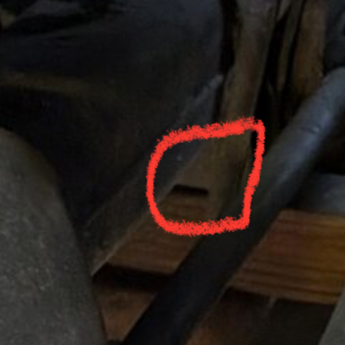

Is there a gap here or is it just a shadow?
I had assumed the same and ordered tre kit... I will still swap them since I've got all the parts and feel they've got a tiny bit of movement.
But om pretty sure these clamps should be on the split part of the tie rod so the ends can't move / change alignment...
I’d seen that clamp there, but it hadn’t occurred to me that someone had left it like that. Someone must have had a few too many wobbly pops while working on it. If you’re going to partake… best to give it all a good once over the next day.
WTF… who’d leave it like that? I at least have the clamp over the split before going for a test drive… usually tightened up also. Why tempt fate.
Always good to realize your truck was previously worked on by a moron. Gives you so so much confidence in the other work they may have done. 😒
