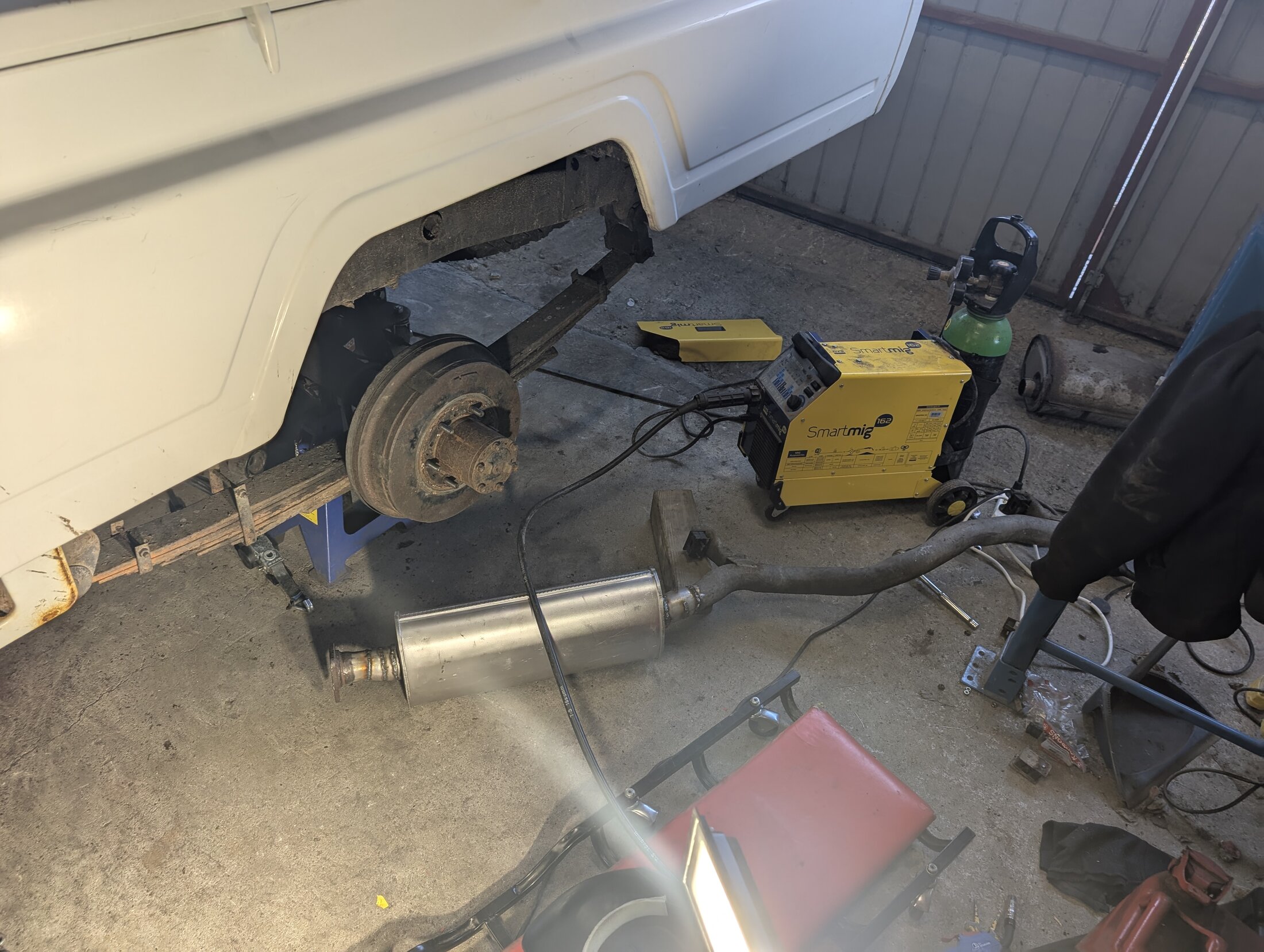

Truck is through the inspection, good for another two years.
Found bleeding the front was a bit of a horror show... Apparently you need to disconnect the load proportioning valve on the rear axle in order to force all the fluid forwards to bleed it, once I did that it was easy enough...
