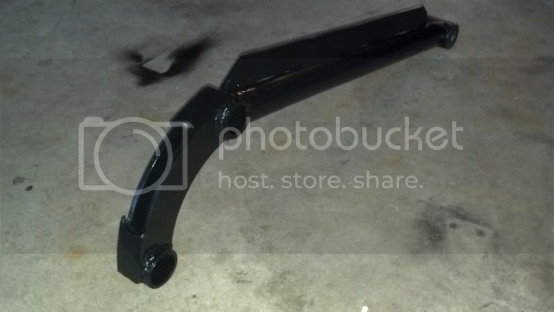

Once I re welded Marks anti-wrap bar, I mocked it up to find that I don't have any room for a conventional anti-wrap bar....:frown:
So I made an unconventional one...
Then I mounted it up....
Then I went for a nice Easter Sunday drive to my parents, and broke it....
So now I must make ginger bar 1.1 strong enough to be able to handle driving around town....and hopefully humping a 10ft waterfall in 11.4:1....:rolleyes:

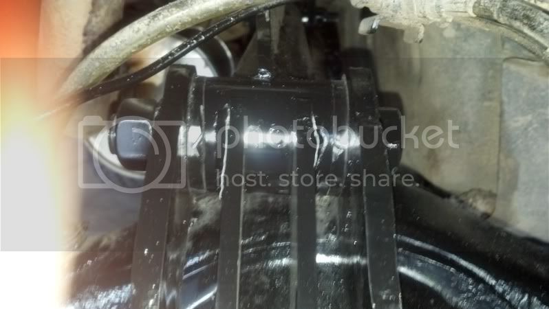

John, I hope you beef up that anti wrap bar pretty good. I saw one guy break his s*** just driving down the road into the badlands. Nasty place...
Russian Roulette
I did indeed.
I added beef to ginger bar 1.1. I added scab plates to bridge the joint top and bottom. I also redid the welds with man welds, and welded both sides. On ginger bar 1.0 I was thinking about the forces in reverse, and laid lil welds...
Not the best pics....
Ill drive her to work tomorrow and see what i can break.
Got to work....Its still in one piece! So I know I can get groceries and cruise the mall for high school chicks, perfect.
Once I get home Ill put it in low low low and romp on it. At this point I'm concerned about the diff cover that I'm welded to. They aren't as thick as most people think. I don't want to rip the welds out of it, and I also don't want to deform it, I may just brace it up to the housing tubes with some DOM, as I originally planned.
