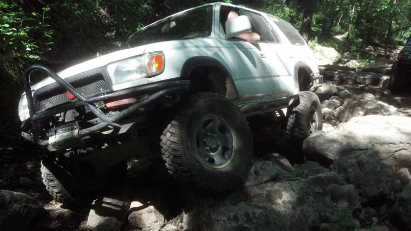

3" lift front, 4" lift rear (land cruiser coils), 33" M/T, 1.5" front wheel spacers, Marlin adapters and dual cases, fuel tank relocated to rear with f150 tank, rear tube bumper with skid plate for f150 tank, 4x innovations original prototype front bumper, HF 9K winch, 4x innovations sliders, Lock right rear locker, reinforced rear trailing arms.... I know theres more but that's what I recall right now.
The 4runner was generally good to us. I used to tow a pop up camper 7 hours down to Flat Nasty or Washeta, wheel the s*** out of the truck for a week and pull the camper back home. Even after smashing in the factory fuel tank and denting the trans pan on one trip it got us and the camper back home (with a lot more stops for fuel and topping the trans fluid off occasionally). Someone that used to wheel with us called me careless for that stuff. Almost tried to lecture my like a displeased parent. **** em. I wheeled the truck and occasionally daily drove it for about 10 years.
Here's a few pictures of the 4Runner in it's prime

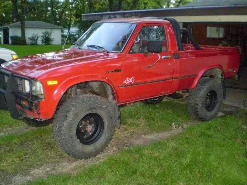

During the ownership of my 4Runner there were vehicles that came and went. For a while I had an 83 pickup that I sort of stumbled upon and picked up cheap. It took some work finishing up an aborted motor swap by the previous owner, re-locating the crossmember for a newer trans, finding the correct driveshafts, putting the interior back together, and some hours with a buffer. Found a used set of tires. Repainted all the black parts black again.
I always thought back to this truck. I wanted something simple to wheel and I had that. I have no clue why I sold that truck. I didn't need the money, but sure, I could use the money. In my mind I think I just figured "I found this thing cheap needing work and I can find one like that again" Wrong. I sold this truck back around 2008. Prices have obviously skyrocketed since then. But this was my pickup that I kept thinking about.

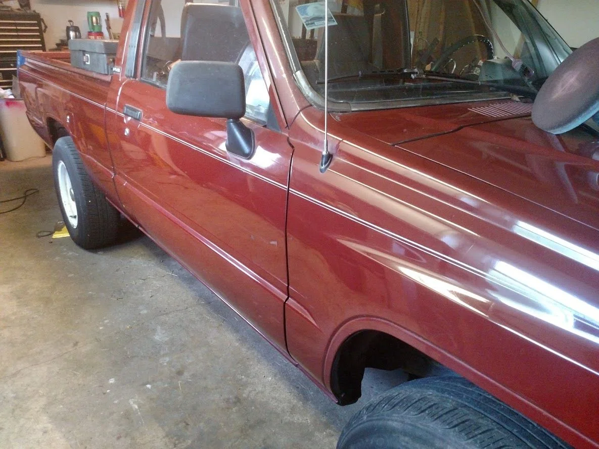

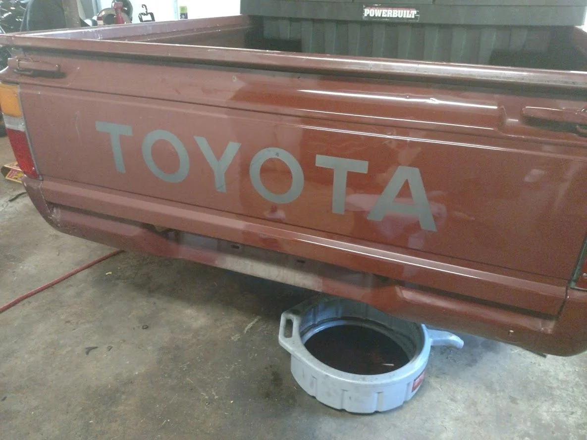

The truck did clean up well. Turned out the truck is not brown- actually "wine red"
I took a picture of this side by side comparison of what a little bit of polishing compound did for this little truck.
And the passenger side after some compound
Wow, that thing cleaned up and buffed out nice, looks really good! I've always wanted to SAS a 2wd, I hear the frames are nearly identical to the straight axle 4wd trucks frames so you should have plenty of clearance for high steer. Look forward to your updates!

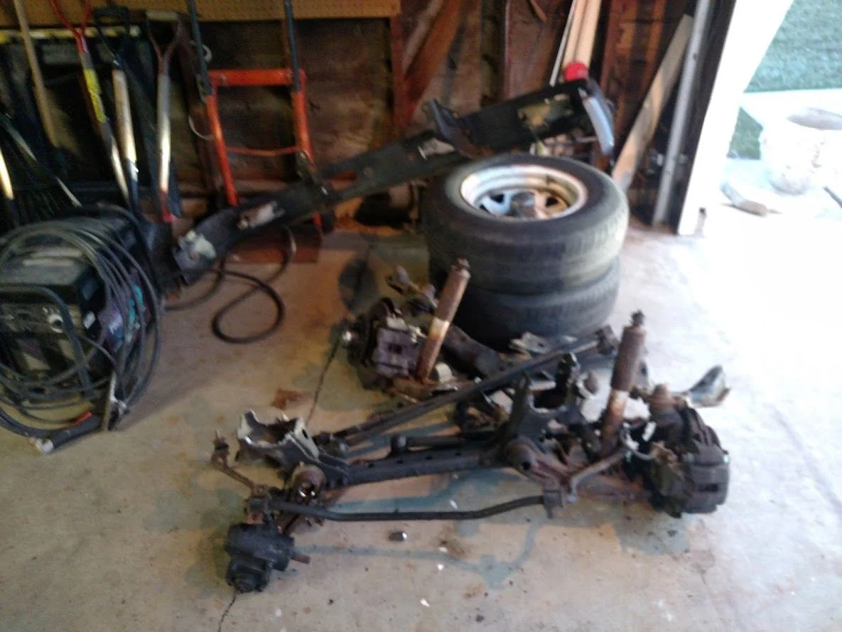

I ended up with a pile or two of scrap initially.

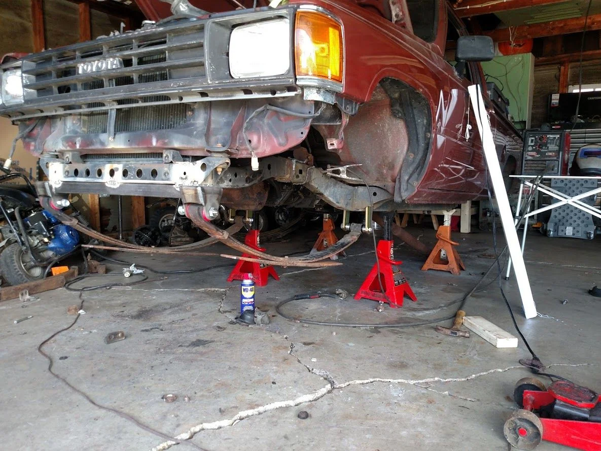

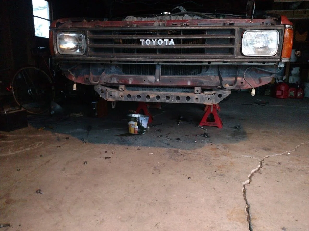

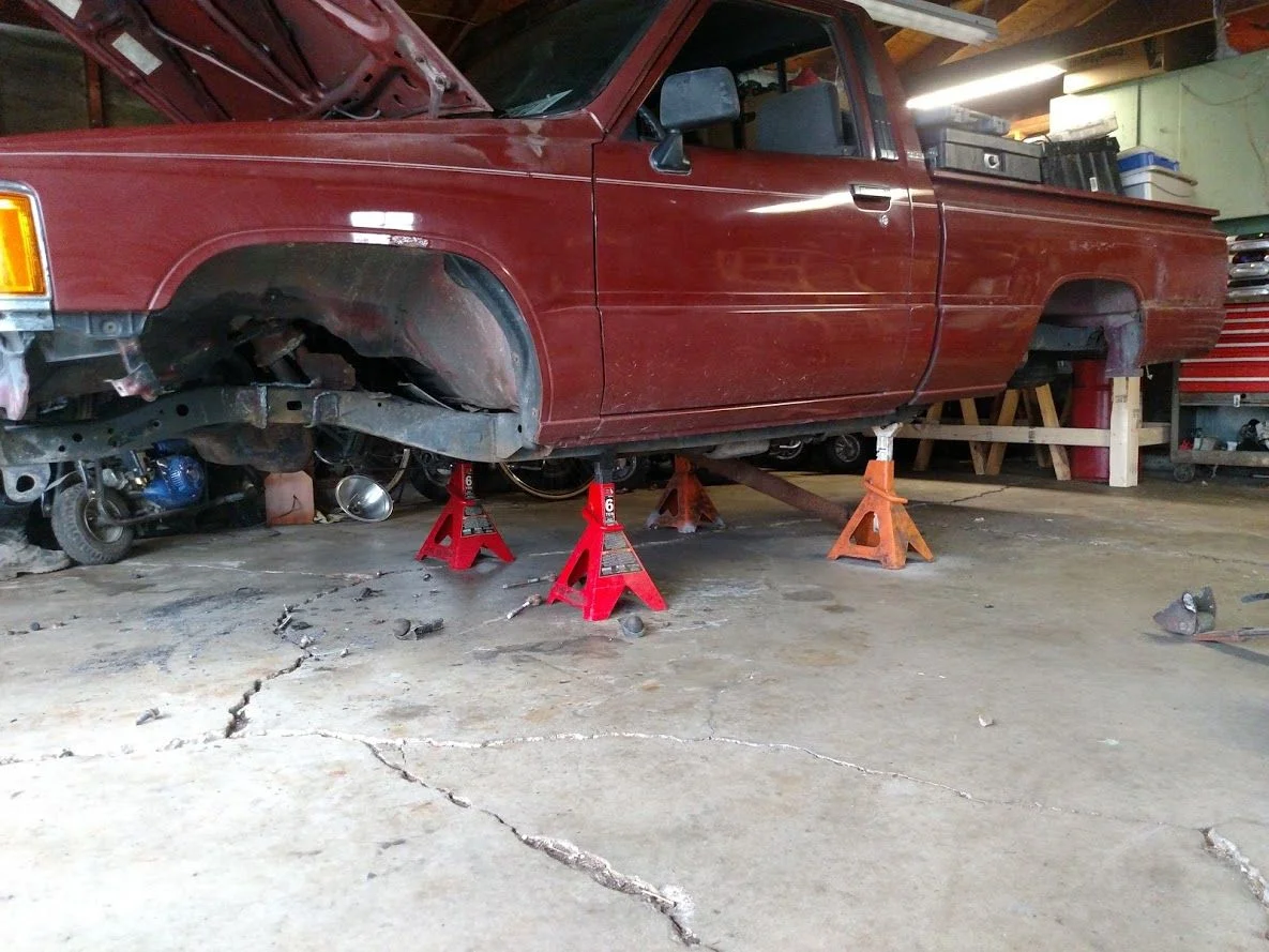

Once I got all the 2wd stuff out of the way I was left with a decent looking clean slate. I did get the rest of that stuff off the front frame section eventually. It's still on there in a lot of pictures until I cleaned it up to install the front shock brackets. I was just to excited to be making progress.
It was actually quite a bit of relief to get to this point. You know damn well that you can only go forward from here... or it ends up on craigslist after sitting like this for 9 years.
You can see how the 2wd frame has a lot of room with the way it travels upward in front of the cab.

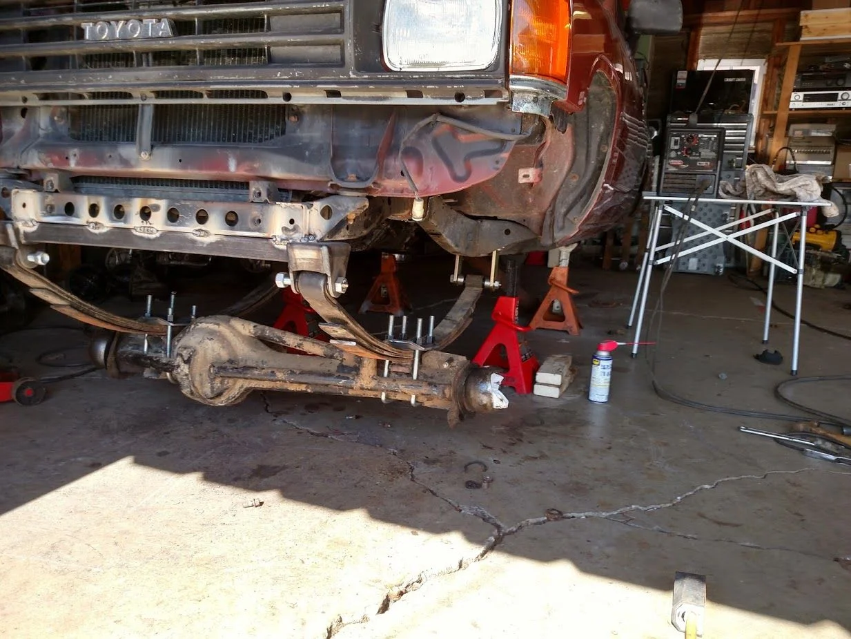

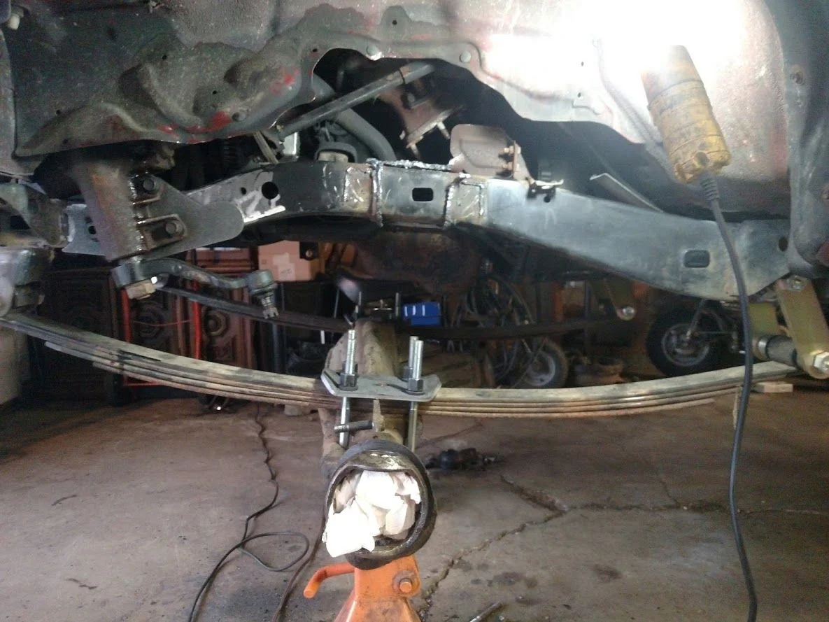

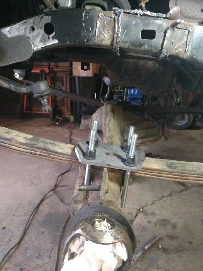

I started with getting the front axle under the truck. The front spring hanger kit is made by trail gear and I just had to hope that it all works out on a 2wd truck. I couldn't find any information that any SAS parts will work for this frame. I'm pretty sure the frame reinforcement kits would not work so I never ended up purchasing them.
Turns out the fitment of the spring hanger and frame tube jigs are pretty dead on. For anyone curious- the frame tube jig is just a thin piece of sheet metal that you place around the underside of the frame near the mount for the front cab mount. It has a hole that you trace out to cut on both sides of the frame and then you slide a tube through the frame and burn it in place. This is now where the upper bolt for your shackle goes.
I thought I had some better pictures but must have lost them through phone upgrades and downgrades. If anyone wants to see any particular pictures how things fit or were done just let me know!
As far as the garage floor goes... our house is a brick ranch built in 1957. We were lucky enough to purchase it from the original owners who kept it up and updated important things like efficient HVAC, water heater, new roof, etc. The garage is detached behind the house and was built in the 60's. It's not my ideal setup and it sometimes sucks having concrete like this. Normal things like rolling a floor jack or welder cart across this floor can stop you really fast. I have to pick my route carefully when sweeping the floor. We'll be a little more picky about things on the next place we move. We do love the house but we would prefer more privacy with a larger lot and a nice size shop/garage to fit our 5 vehicles with room to work and hang around with friends. Illinois keeps giving us more reasons to get out with every law and fee that goes into effect. But back to the truck....

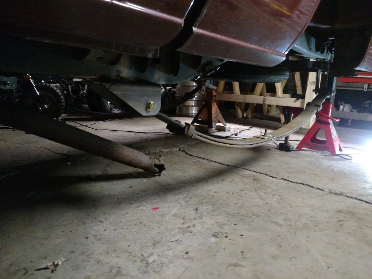

So first I burned the spring hanger and shackle tubes into place. The springs in this picture are the rears from this truck. They measure in around 47" if my memory is still working.

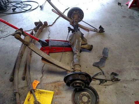

After hanging the front axle housing under the springs I realized the trucks old rear springs were not going to work for me. I thought people were running these and the issue wasn't anything to do with the 2wd vs 4wd frame. These springs located the axle waaaay too far forward and there was no way I could mount the IFS steering gear box even if I cut into the front core support and mount. Turning the springs around put the axle at an unusable location close to the cab. The leaf spring center pin was just too far off center of the spring. So a friend came to the rescue and gave me a set of old all pro spings he wore out. He was running them for years on a SAS 92 4runner and I figured my little ole mini truck wouldn't care. These springs put the axle right were it needed to be.

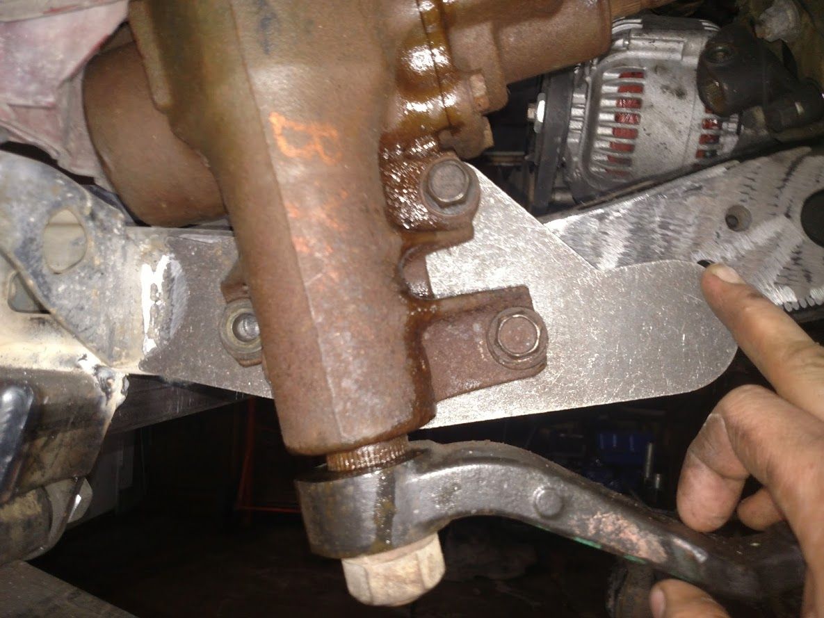

This location is roughly where the IFS gearbox bracket went. I'm not sure if the factory 2wd gearbox would have been any help to have since this truck never had power steering. So this gearbox I installed is just your average run of the mill 4wd IFS box. I was able to get a power steering pump, brackets, tensioner and pulley, and reservoir from a friend who has been through a lot of toyotas. It all bolts on to a non power steering setup just as you would hope. The power steering pressure line is just a stock one from rock auto and the return line is bulk hose off a reel in the parts room. I did need to get the extra pulley that bolts onto the crank pulley and ads an extra groove for the power steering belt.
The brackets I used for the IFS box are from Slag Fatory in Chico, CA. I had never heard of the company and found them listing the brackets on ebay. Their price was the best and both inner and outer brackets are 1/4" (Most kits have a 3/16" inner bracket) and they were generous with stickers. They make some good looking products and builder parts.

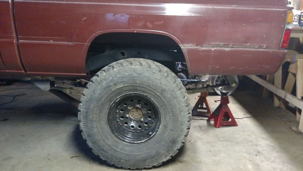

With the jack stands now under the axle housing and the weight of the truck on the suspension I could finally see what my shackle angle was going to look like. I'm pretty happy with how it sits.
The front axle was as far as I could go with the parts sitting around. The front axle has a factory 4.88 3rd with lock right locker.

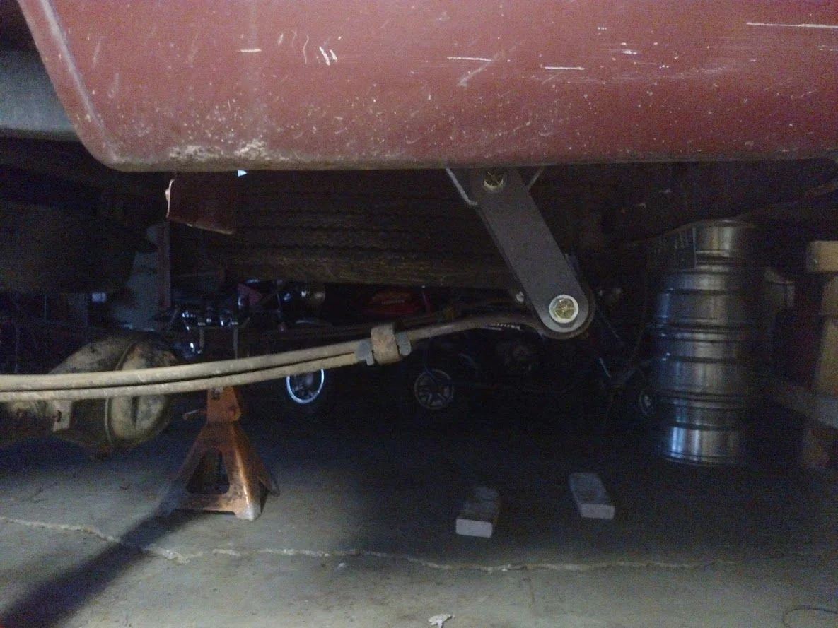

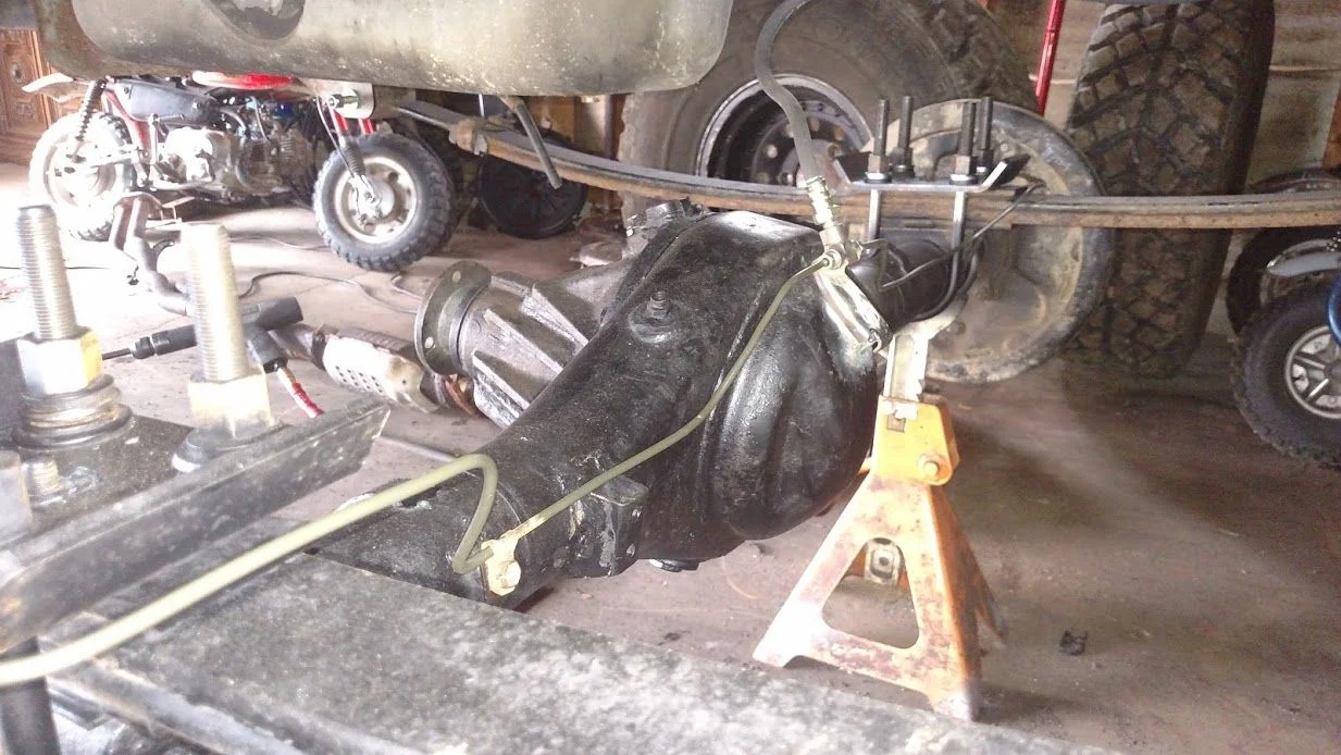

I moved on to the rear suspension since I was waiting on the front axles, knuckles, high steer, arms, etc. For the rear springs I figured the 63" chevy leafs were the way to go. The springs are cheap and plentiful, they ride nice and soft, and companies make kits to install these pretty easily. I went through Sky's Offroad Design for this kit and it included all the parts needed besides the springs. I went off somebody's write up for the measurements to install the hanger and shackle mount. The front hanger is installed forward of the factory one. If you go off measurements it's a good idea to leave the factory one on the frame until done. I think the usual recommendation is 8.5" forward eye to eye for the bolt.
The rear shackle hanger has a measurement to install it at. It turns out, on my truck at least, that the mount just butts up behind the factory one at that measurement. Now on my frame the boxed section ends right after the factory shackle mount so I cut out some steel and boxed it to the end for reinforcement. Otherwise the shackle hanger would be installed on a section that is just "C" channel. Everything is "tacked" in place and the springs are hung. Some chevy trucks had these spring packs of just two leafs with an enormous overload leaf. I did remove the overload leaf before this picture. There are pros and cons to either leaf pack and I figured I'll just see how this works out. Easy enough to change them out if i need to .
The rear housing is in and I can see where I'll be with rear shackle angle. I opted to run the brake lines over the leafs to keep them out of harms way. The center brake line is just two factory ones to double the length. I searched around for braided stainless steel but couldn't justify the price at the time. I ended up finding that helpful hint about doubling up the rear line on someone's youtube video. I did the same for the front lines. You just add a factory rear brake hose to each front. $7 extended brake line! At that price you can just carry spares or find them at an auto parts store. I figure If you are going to travel 8 hours to go wheel for a week, I don't want to try and get special order parts shipped and be down for a few days. I've watched others go through stuff like that and it can make an awesome fun trip turn to something miserable. It's nice if you can just run factory Toyota parts or at least something common from a parts store or junkyard.
So anyways.... I got the rear housing installed and I am really happy with that shackle angle. The rear 3rd is also factory 4.88 with lock right locker. The rear wheels went on for a test fit and to get the truck somewhat on the ground. The tires are 35X12.5 and were a good price after a friend upgraded.
I used factory rear brake lines to lengthen my fronts when I sas'd my 86' 4runner. I was on a tight budget and couldn't justify the cost of those spendy braided extended lines. They worked out well, and like you said really cheap and easy to find replacements. I like how your build is coming along, nice work!

Are you gonna grind all that crap off the frame from where you torched off the IFS? A lot easier to do without the axle in the way.
Cool project!
I think I figured out your problem. :p
Cool project!
lol. Yes I got it all off of there. I initially cut everything off with an older plasma cutter that needs some help. An air hammer with a chisel bit eventually peeled that off the frame and an angle grinder smoothed out the rest.
