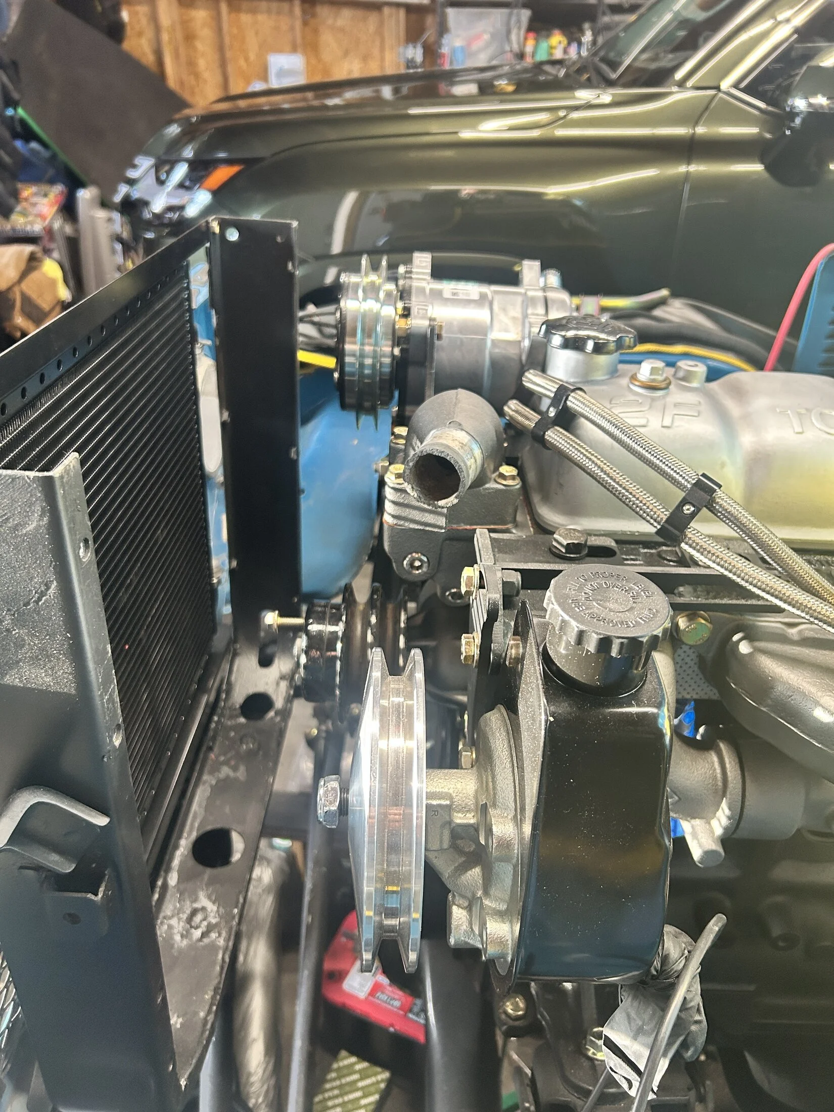

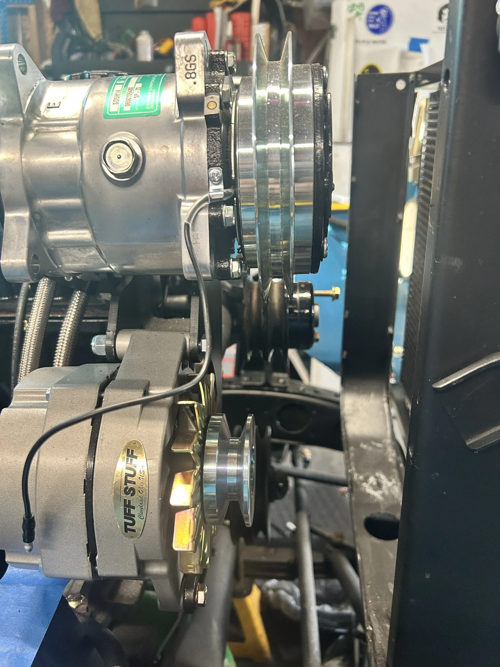

Hi friends. On my South American 1982 FJ43 project, I am adding a Vintage Air AC system. I have to do some work to bring all the pulleys into alignment. I had to move the alternator to the passenger side to use the cool mount for the AC pump that vintage makes. That forced me to move the Power Steering pump to the drivers side. I’m curious if anyone know of some different pulley options for either the main pulley on the crank, or a different pulley on the water pump that I could loop three different belts around. I also heard about an option to get a lower profile water pump that would bring its pulley in closer to the block face. Any insight or references for parts is welcomed as always.
