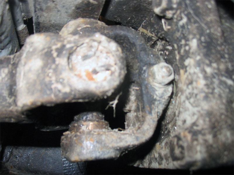

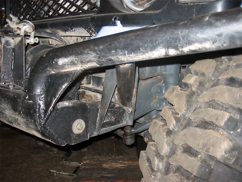

These pics leftmost 2 show my LJ70 with a PTO/ELECTRIC (24votls) from a 80 series hidden behind the front bar. Works very well - not so good when its on its side tho. The engine and the PTO make it slightly front heavy.
Winch has been modified to not let cable loopout off the spool also.
The radiator is in stock position and has an intercooler mounted in the front also.

The Cruiser with blue camo color is mine. I am using BJ-75 radiator, which is bit lower and wider than the orignal. Also I have made a hole going through the front of frame to get the shaft higher. I think I will be changing the PTO winch to electric one some day anyway. Another option would be to add a gearbox to winch shaft so winch speed would be closer to tire speed.

Hi Mate, I put a PTO in my LJ70, not difficult at all, & you end up with the winch a lot further back than on the other 70 series:
I cut out some sheet metal above the bumper & made up a mounting bracket - I made a bullbar at the same time.
I needed to shorten the PTO driveshaft so I ground off the weld on the end of one of the sections, took off the end fitting, shortened & re-machined the shaft then welded it back on.
I had to modify the radiator bottom tank & move the hose to the other side to give space for the PTO shaft which comes out under the front cross member.
