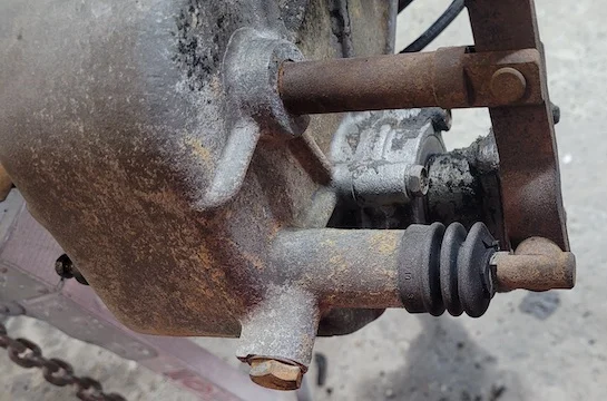

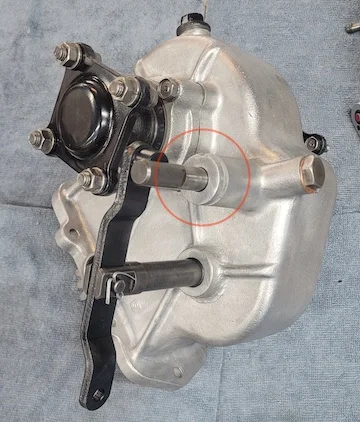

Does any one know where I can source a new or good condition used nose boot for the PTO gear box?

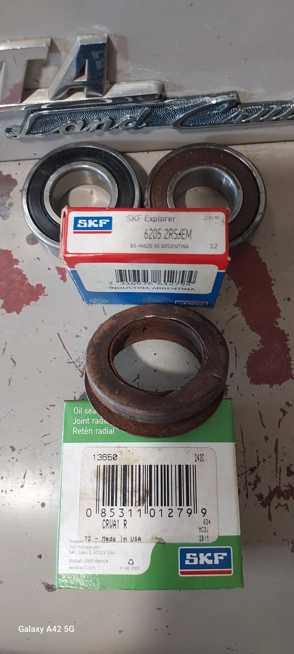

I have the SKF bearing and seal # at home. On the road at this time. I'll get them to you in a couple days.

Pretty straight foward operation on rebuilding the pillow block. Take your time with the snap ring removal. I went with a rubber seal instead of a felt dust seal.
Here are the numbers for the seal and bearing. Old bearing and seal in picture.
