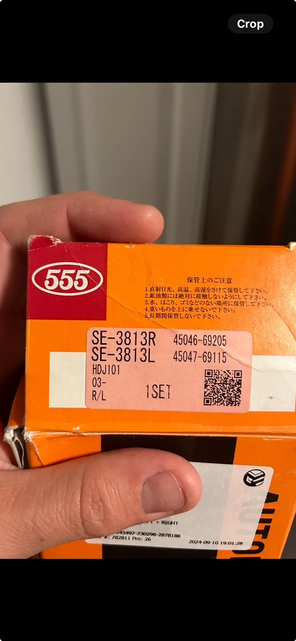

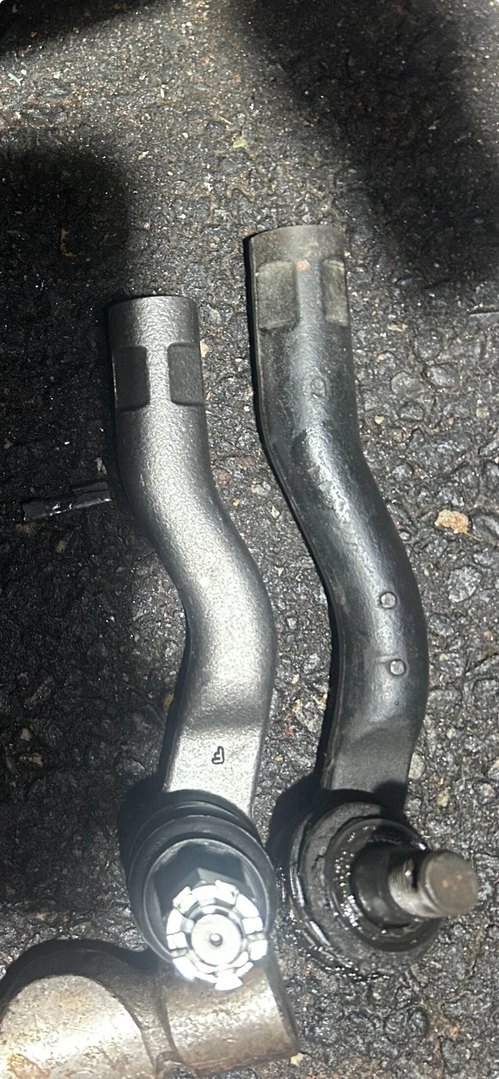

Just a quick help to anyone else who may be ordering 555 tie rod ends. Partsauq currently has the ends for a HDJ101 03+ listed for my 98-02 LC VIN. Guessing this will display the same for others with similar years. Emailed them about the error so it may be fixed before too long. Good reminder to verify parts even though partauq VIN ordering has never let me down before!
03+ ends are the same shape but a decent amount shorter. Quickly realized 3 threads connection was not going to cut it lol. Thankful this is such an easy job and I already had the front apart changing the rotor. Correct part numbers from Sankei 555 for 98-02 are as follows
Reference numbers
Driver - SE3811L
Passenger - SE3811R
Part numbers
Driver - 45047-69100
Passenger - 45046-69195
Thank you cruiser yard, Yota1, and onlineautoparts.au for the cross verification

Interesting. I'm surprised there's a difference, i didn't think there were any chassis changes through the production years
