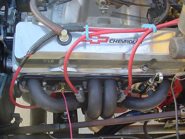

I run a short water pump and ended up running a PS pump circle track racers use because it mounts directly to the "old style" motor mounts on the lower front of your block. No other brackets were needed. Pic is poor but can see in lower corner:
