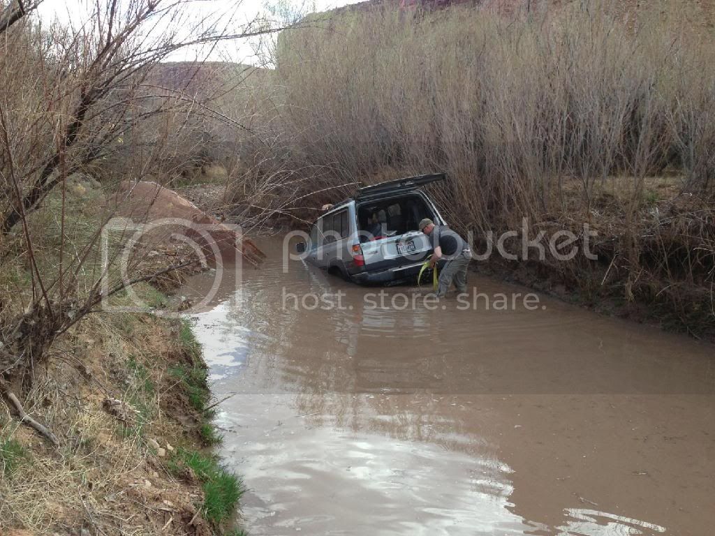

I have had a couple 92s and a few 96/97s. I am generally more cautious with the newer ones. While the 3fe is not a speed demon it is a tank. Sunk my last 92 on at least a few occasions. The pic below sat like that for at least a 40 minutes. It originally sunk to over the side mirrors must I was able to throw it in reverse and got it up to there before I shut it down. Only problem was a vac line had come off the distributor so it got water in it. After drying it out we were able to complete Kane Creek and drove home back to Salt Lake.
