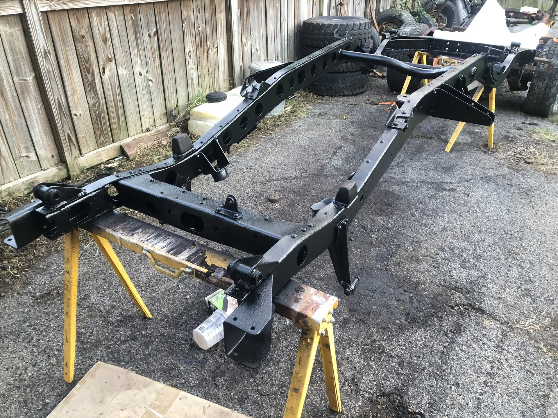

I need help finding any 40 series Land Cruiser conversions that used a 95-97 1FZ-FE with automatic transmission. Guessing there was stretching of metal on the frame and other thoughts. I really want to learn from others mistakes and success stories before embarking. It has been as close to a zero dollar budget build so far, that’s why it’s has been two years in the parts acquisition mode. End of April is my start date to box in the rear, rebuild and outboard a 60 series rear axle, regear the front to match (spacers for now) and flip springs to give some additional length between axles. Pictures because WTF.

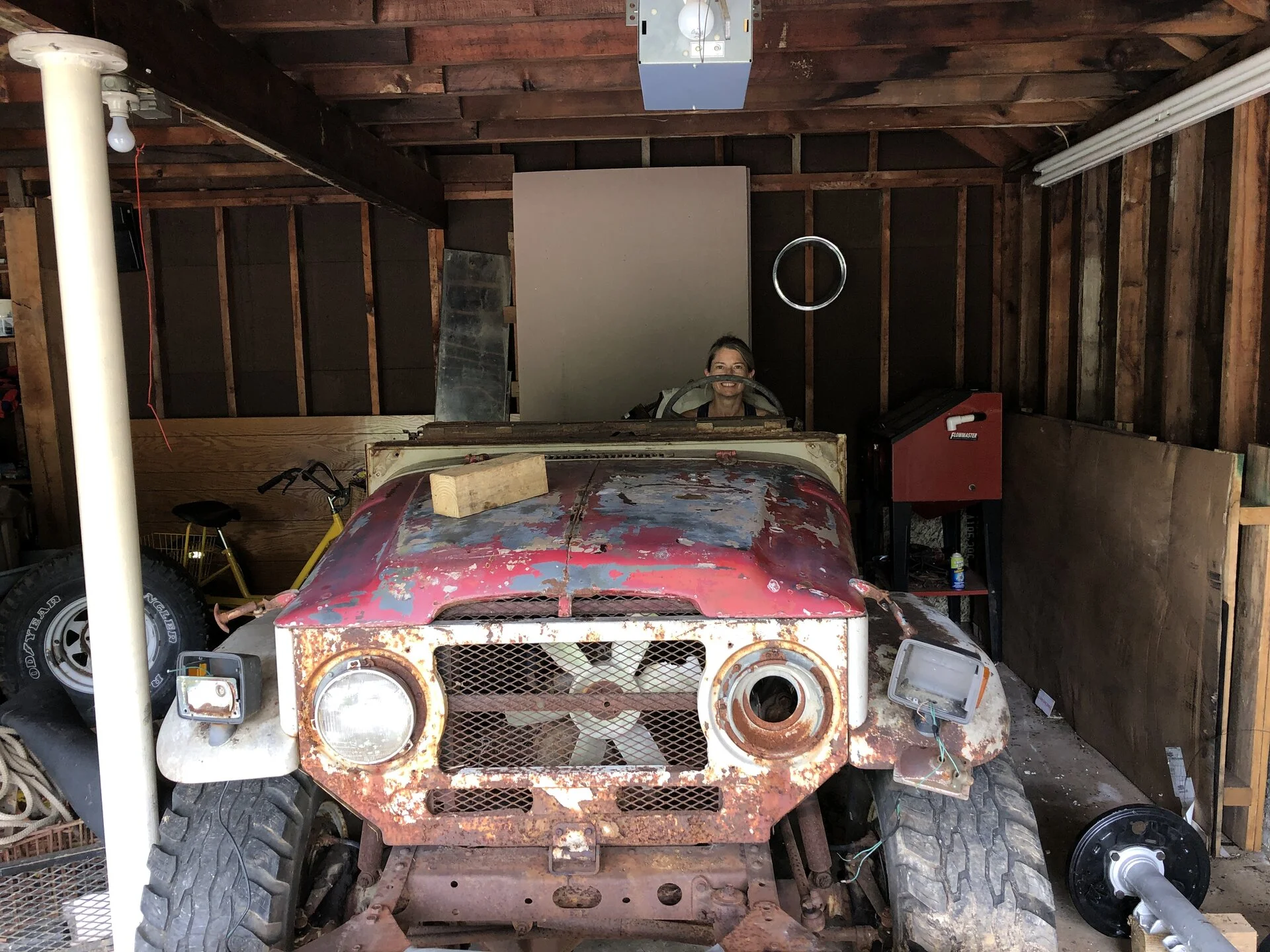

@Mike Shull thank you. That is my vehicle. I should have mentioned that I am cross posting from the 40 forum. I have condensed salvageable parts from three different 40’s in the hope of resurrecting one. I am to the point of moving forward on a couple aspects of the build.
Edit: I am posting in this section of Mud because of the nature of the build. It’s not a traditional or purist resurrection of a 40 sitting in a barn or a field. Plus, all the out of the box thinking members can provide will help me create a small tire wheeling rig I can hopefully drive and enjoy before my time ends on this rock (timeline yet to be determined on both counts).
