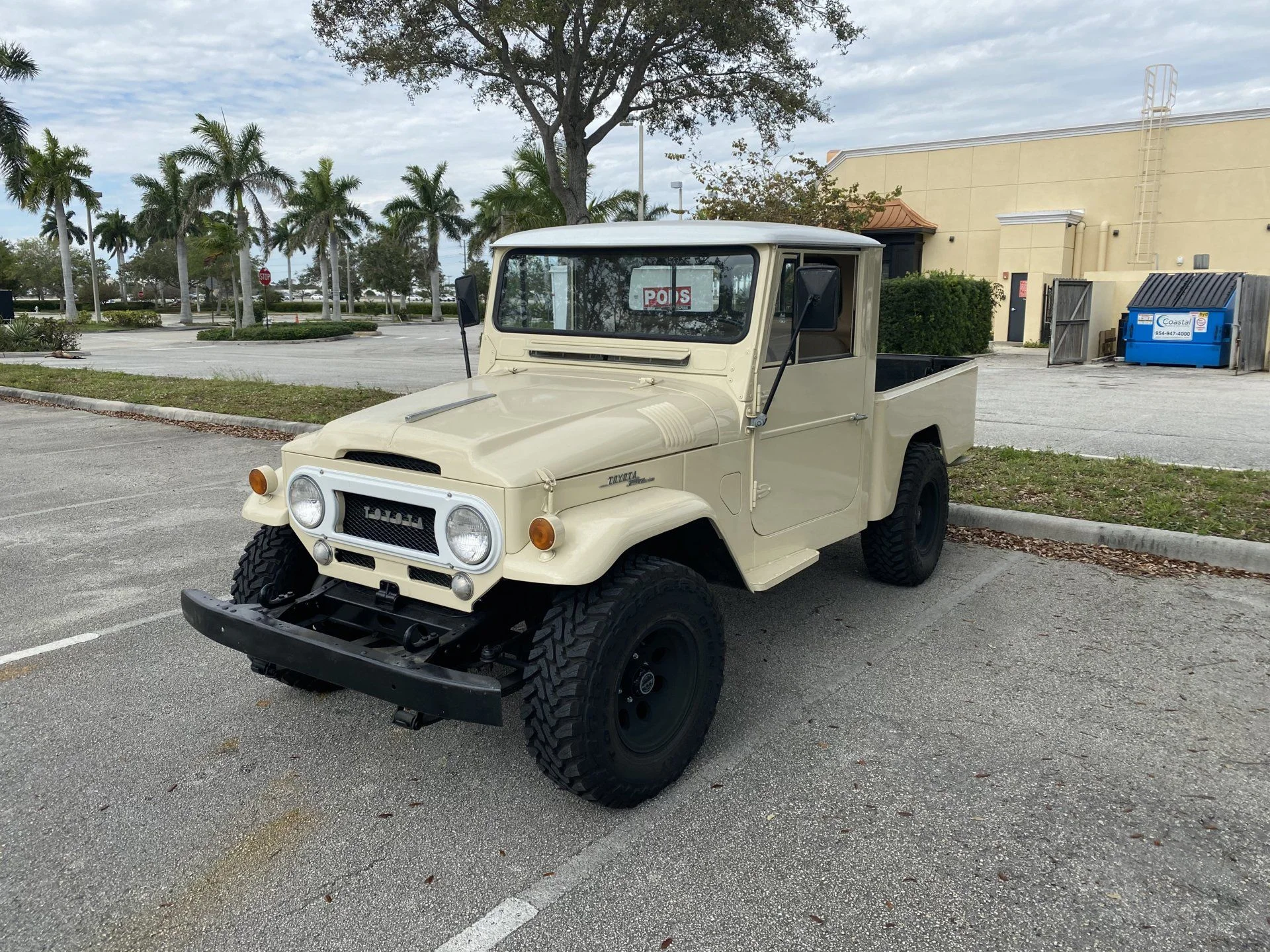

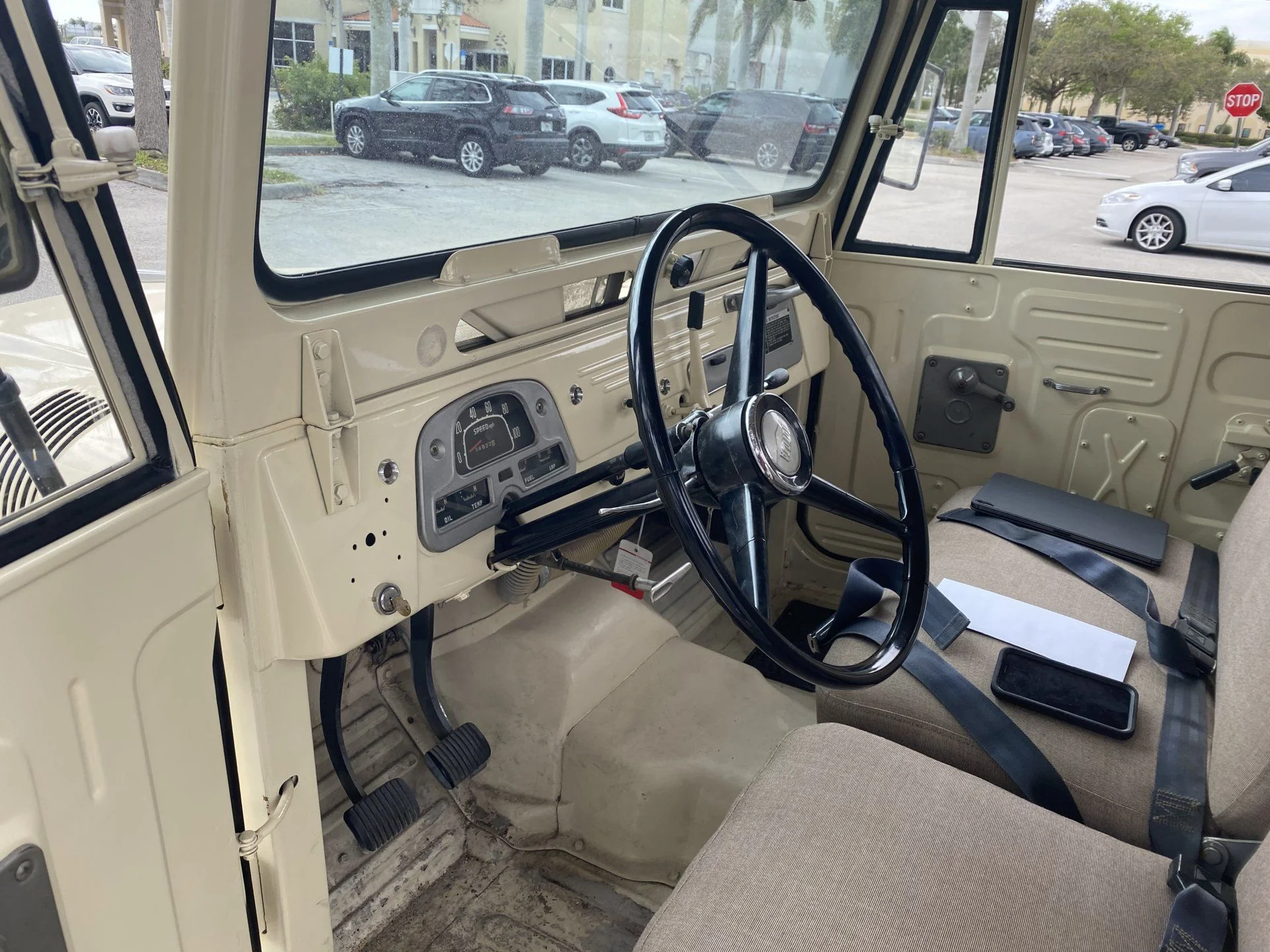

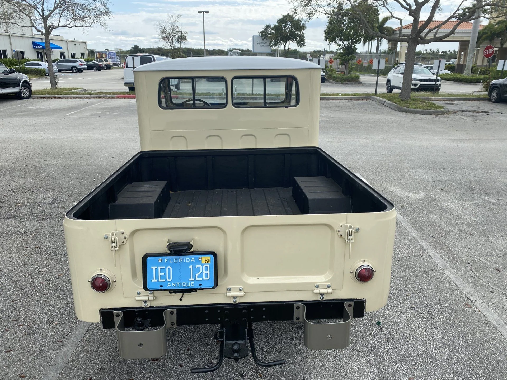

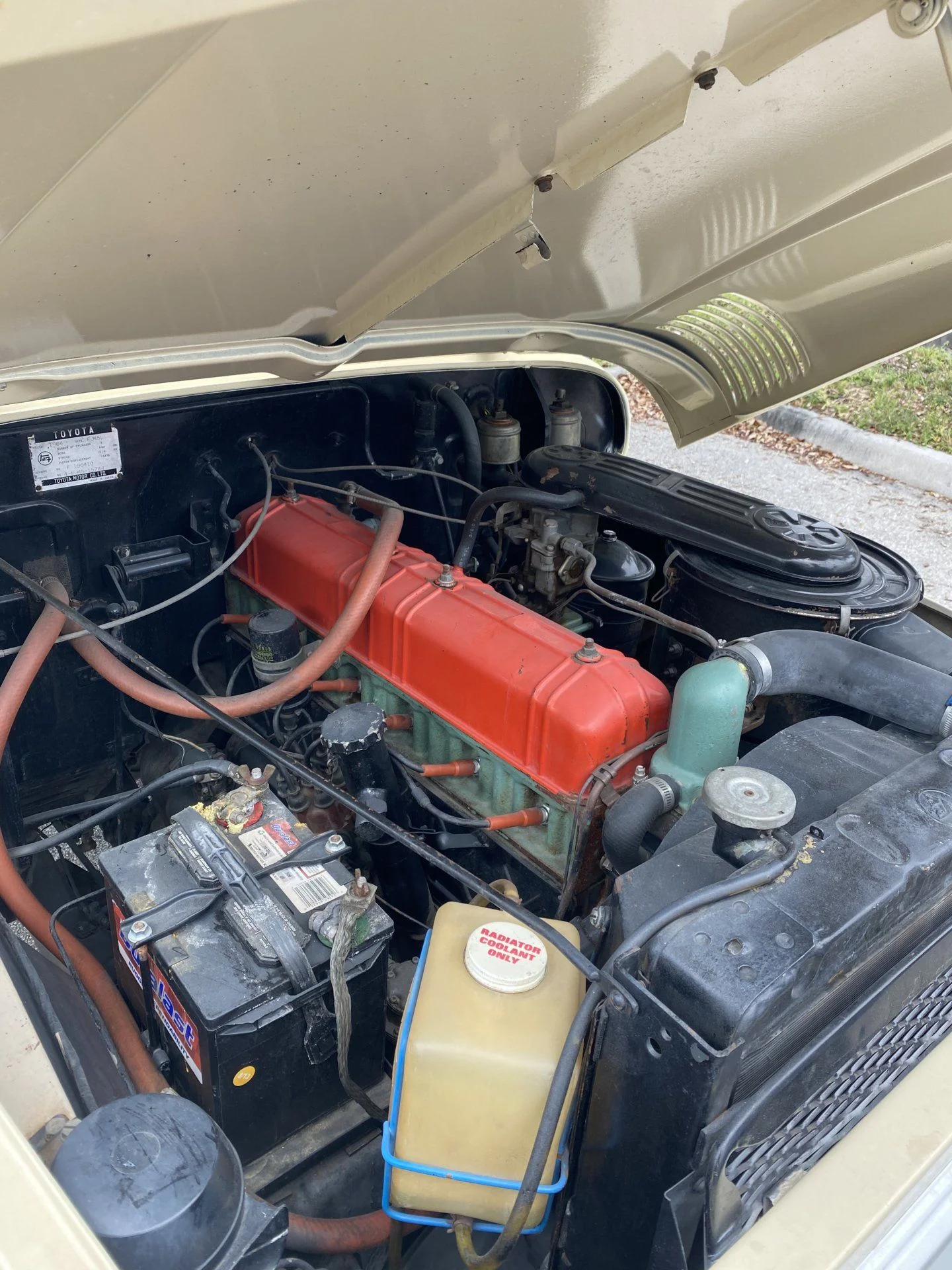

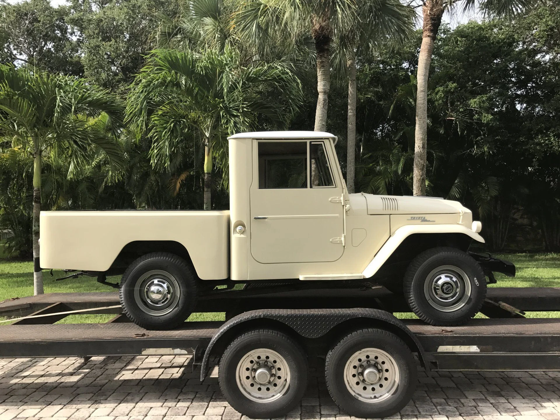

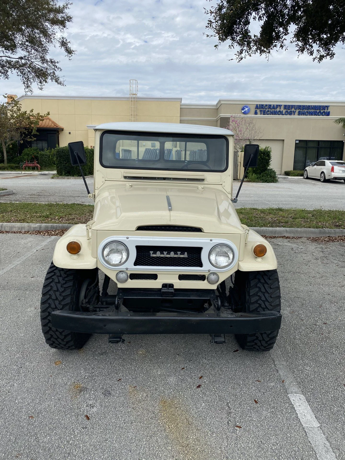

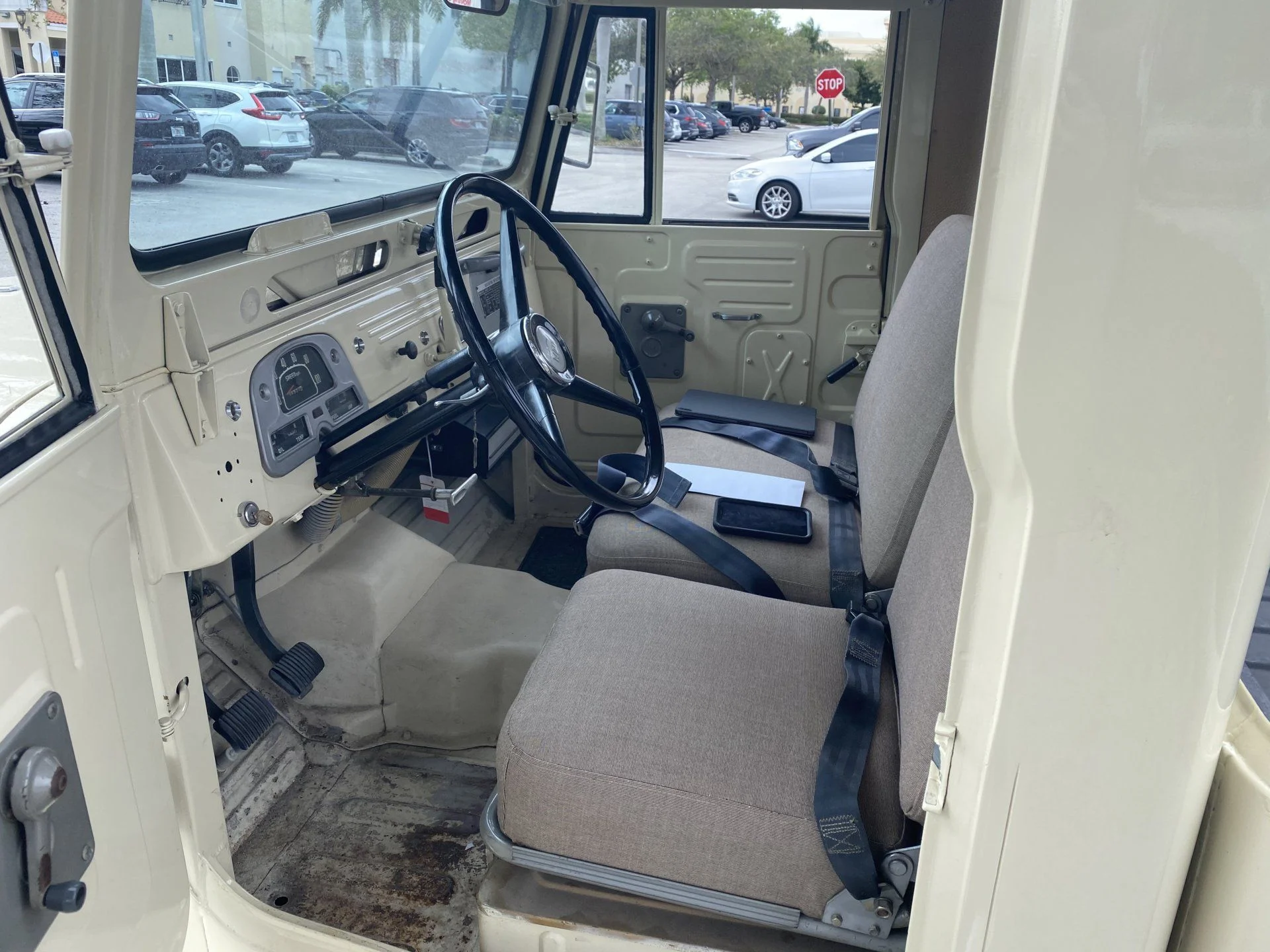

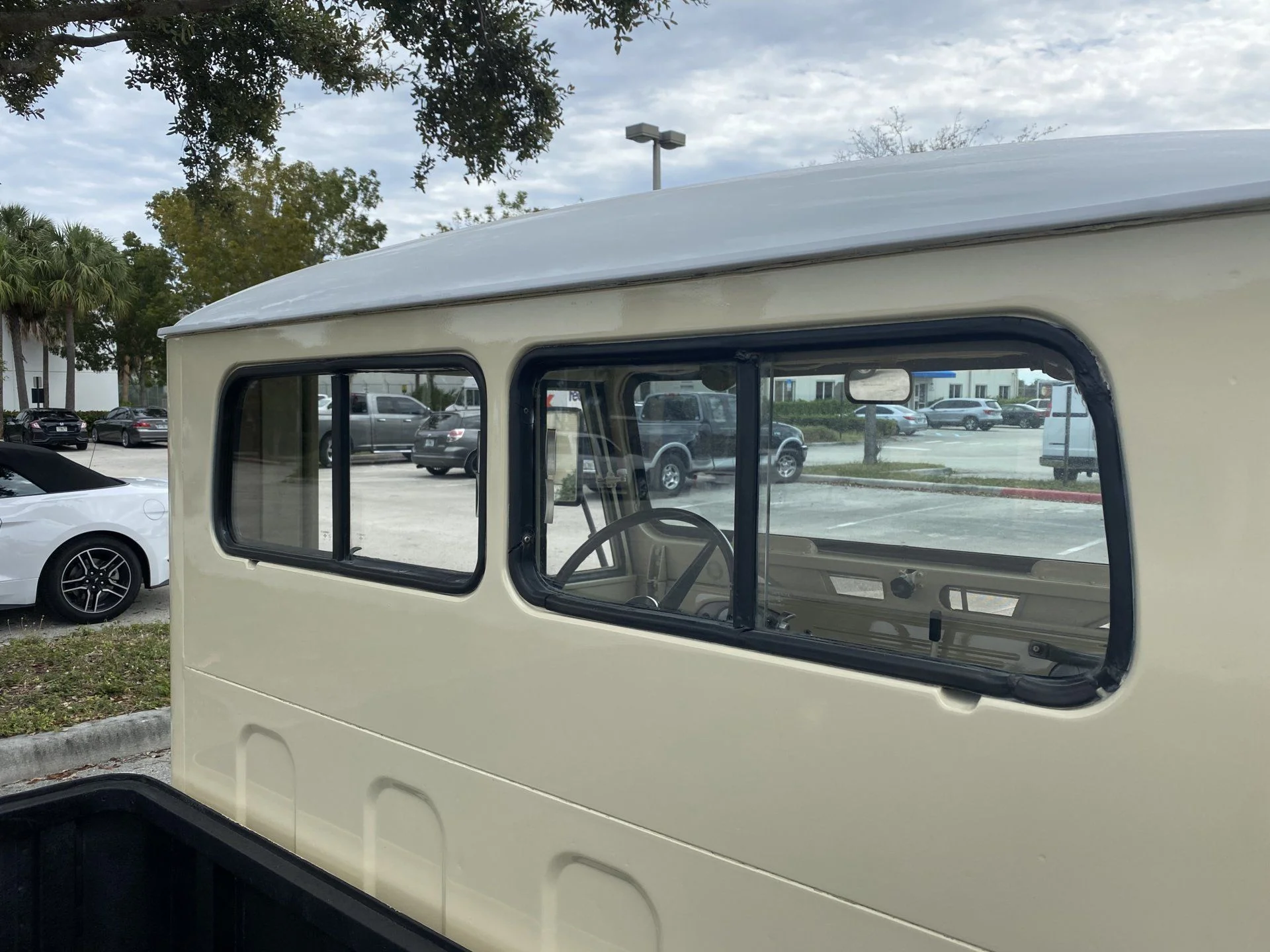

Here are a few photos of the truck from our impromptu meeting yesterday. Leroy was kind enough to drive the truck down to Signature Flight Support at the Boca airport for a quick viewing before I went to lunch with a client. This thing is an absolute gem.

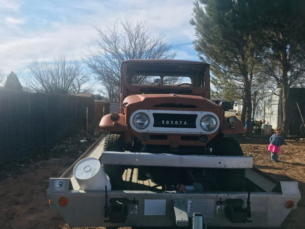

LeRoy: “Well, I have another and it's in storage in New Mexico. It’s a 1963 with no engine.”
I am pretty sure my knees buckled slightly when those words came out of his mouth.
Me: “Would you sell it to me if I saved this one?”
LeRoy: “Yes.”
Me: “I’ll take it.”
JACKPOT
And that, my friends, is why this build thread is for a 1963 instead of the 1964.
The 63 is just perfect for what we had planned for the 64. It doesn’t have an existing engine/transmission. And it needs a few things. But the body is very solid and a great platform for this build.
Plus, what is better than one short bed 45? Two short bed 45’s. I’m going to start a thread in the 45 section for preservation of the 1964 and this thread will get going with the 1963 in its place. Both trucks are headed to @wngrog as it will be good to have the two trucks sitting next to each other to compare and contrast.

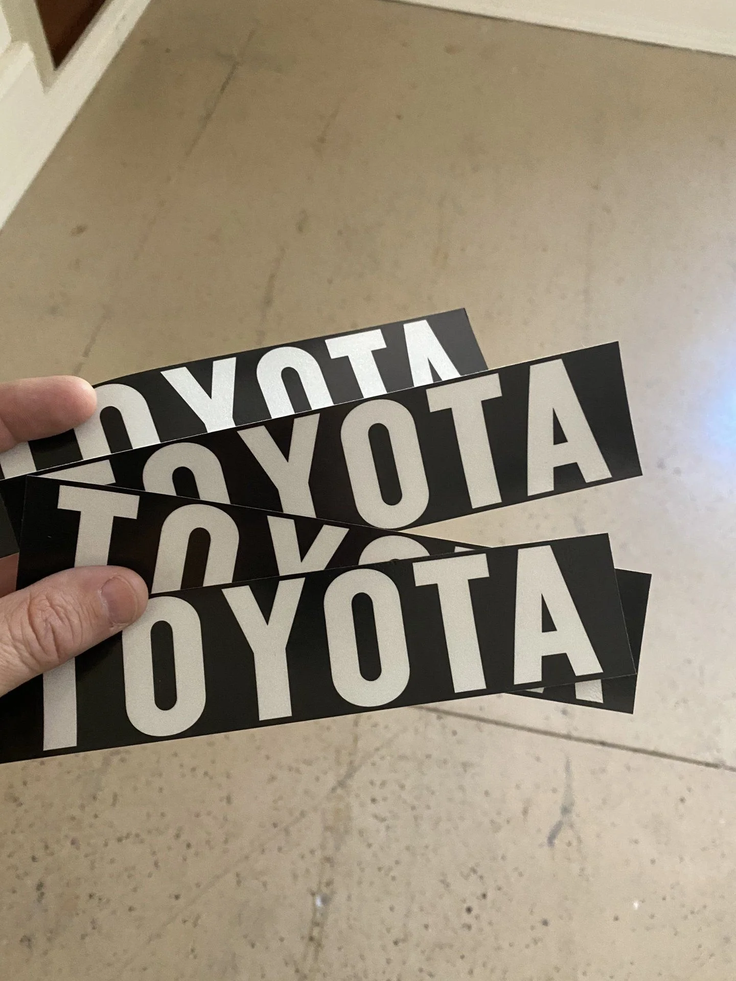

Here is what I mean about the stickers. I bought four of these rear sill stickers a few years ago from @oregon fj. He made some awesome reproductions of these to match the OEM stickers for the real sill on the early 40 series. I only had an early 1964 corrugated hardtop model at the time but I guess I ordered some extras for some reason - maybe @oregon fj was making an order and did not have enough signed up or something who knows. But I now have four stickers. I casually mentioned to Nolen that I had four stickers and only one 40 series that required a sticker - so 3 more to go. Well now we have three of those stickers spoken for so only one more to find a home. PM if you have a candidate ;).
