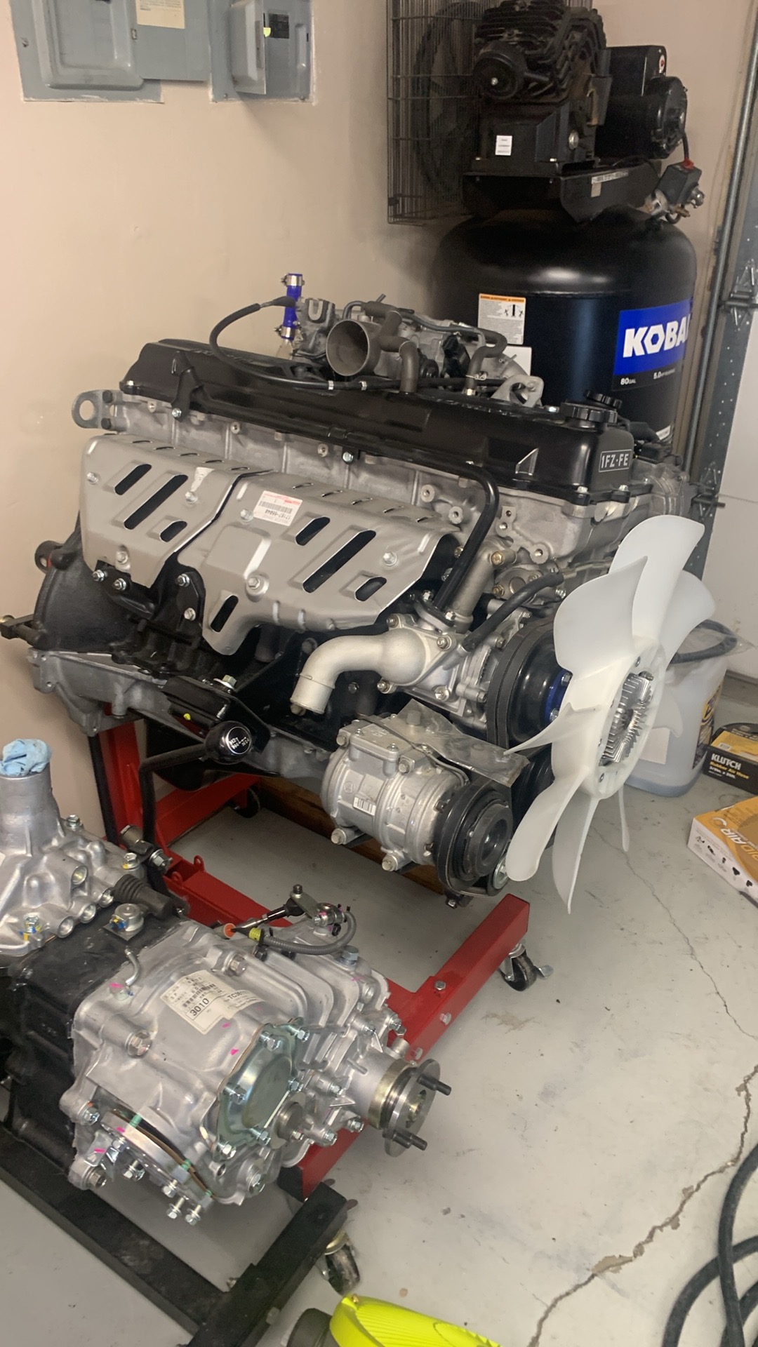

Pulled the trigger. Will have the engine this month and then start the rebuild process. Not sure when it will actually go in my FJ40, but when I do, I will start a build thread.
Now I have to read up on all the 1FZ-FE stuff. Plan to keep it pretty mild. Full rebuild, balance and blue print, Haltech ECU, mild Kelford cams w/springs.
It's used for street and off-road/overlanding. No rock crawling/extreme stuff.

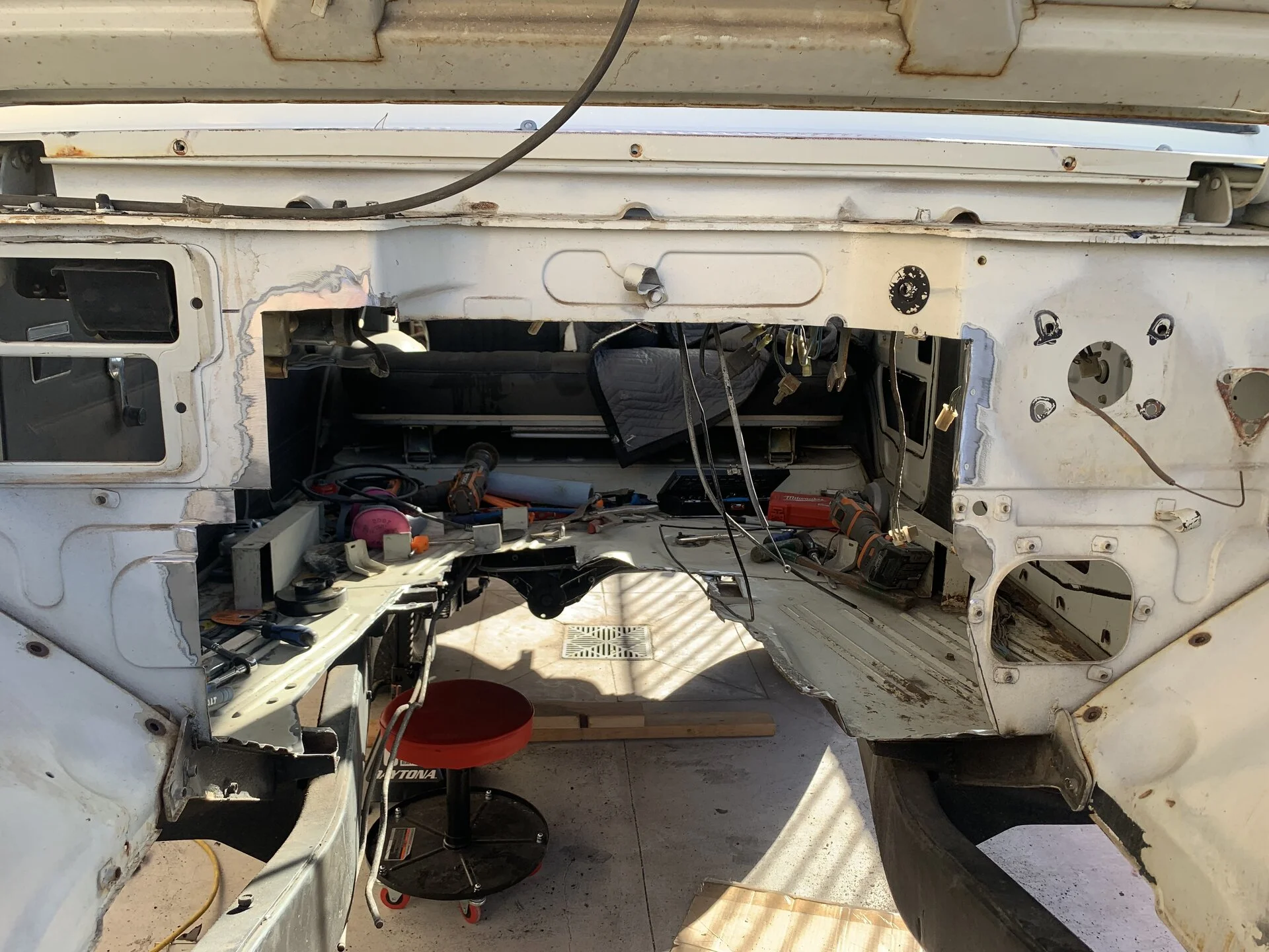

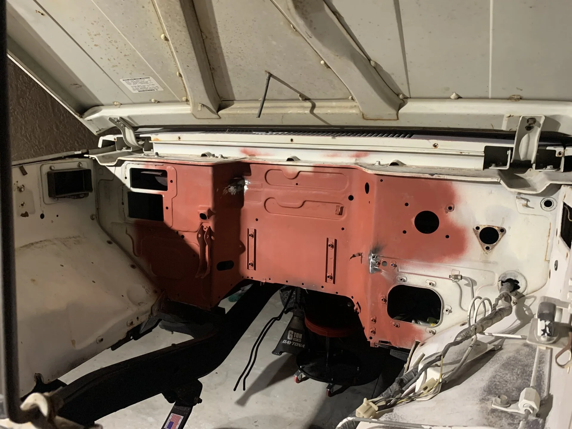

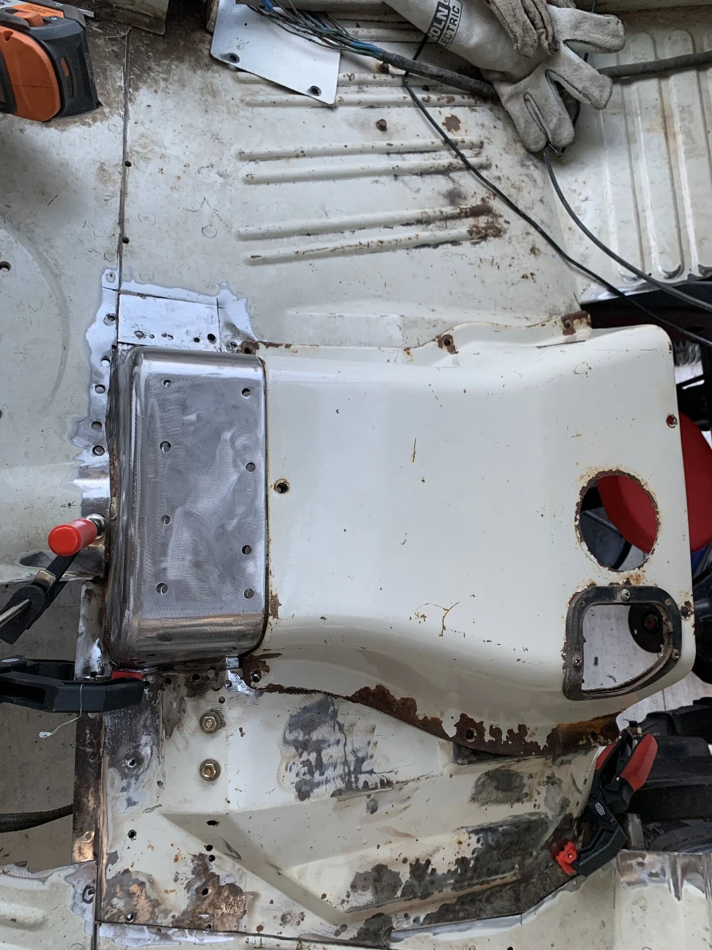

My current build .. 1973 FJ55 , 1FZ with H55 , split case .. I’m almost ready to start fitting it into the frame and engine bay . I haven’t been able to find any info on engine mounting when I search . I had to weld my firewall and floors back in first . Someone hacked into it with a blow torch to do a 460 swap in the late 90’s then gave up on her . They also removed all the mounts for the engine and trans etc .
My fj55 firewall to core support distance is 39 3/4” and the engine is 36” overall to the front of the stock fan . The stock radiator is 3” , so leaves about 3/4” . . So with my stock radiator or aftermarket in the factory position will be way to close for comfort . So I plan remove the oem fan clutch so I can gain another 3.5” of clearance and run an electric fan setup .

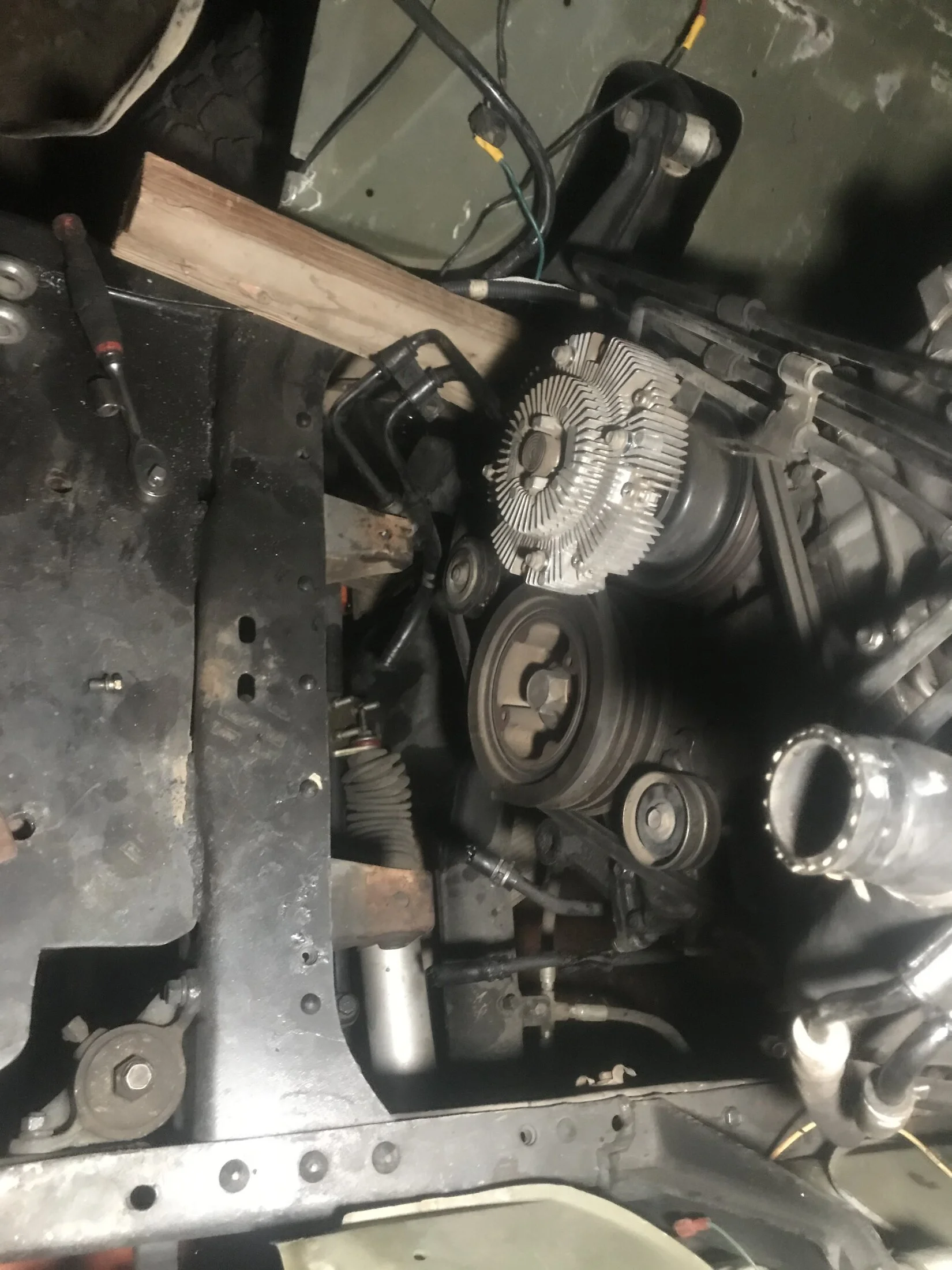

I’m trying to do the same thing i already have the engine and transmission with its own stock transfer case what I been looking for is the motor mounts no luck on them I seen pics of people building them but no detail explanation just pics of them already welded to the frame did you ever finish this swap I have the motor and transmission in my 40 but the transmission is very long I did some digging and read that the h55f transmission that comes on the 60 series 4-5 speed housing will mount to the 1fzfe engine and just now I read that the 151 will also fit it which cruiser does that 151 comes

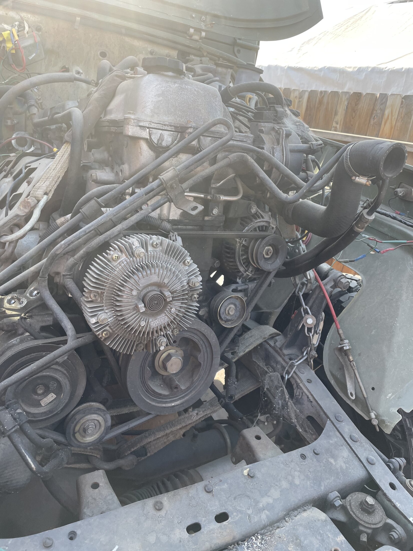

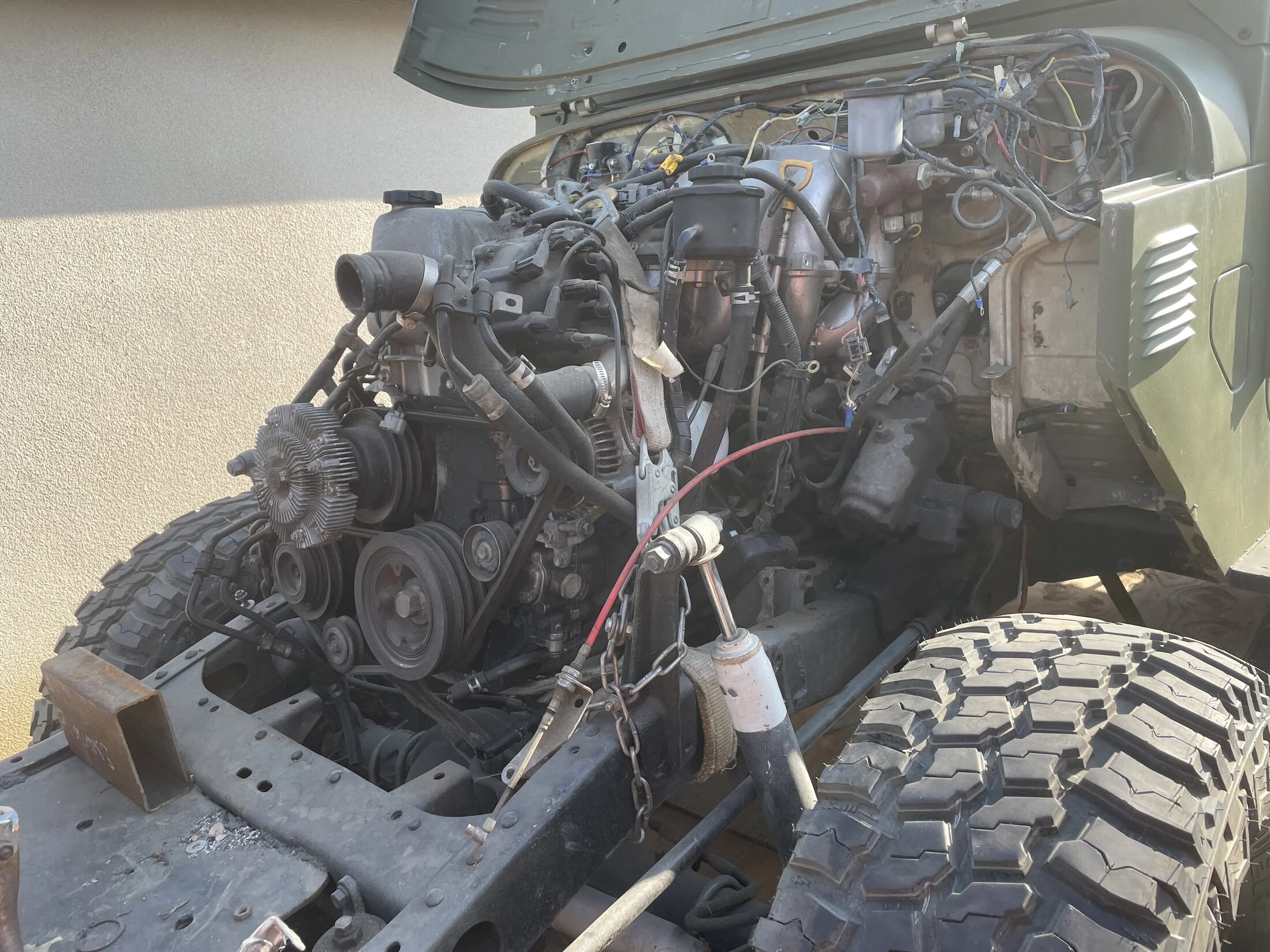

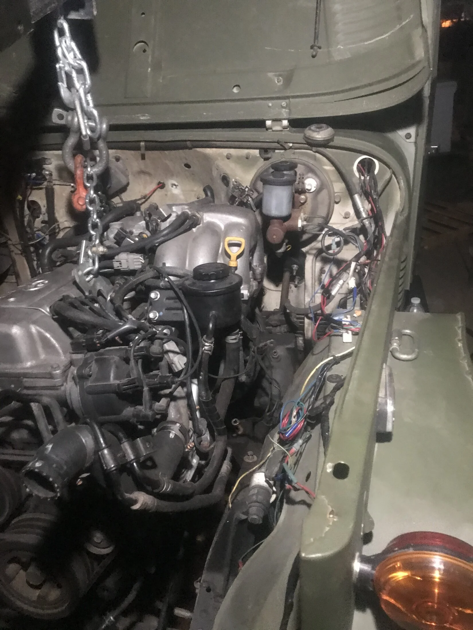

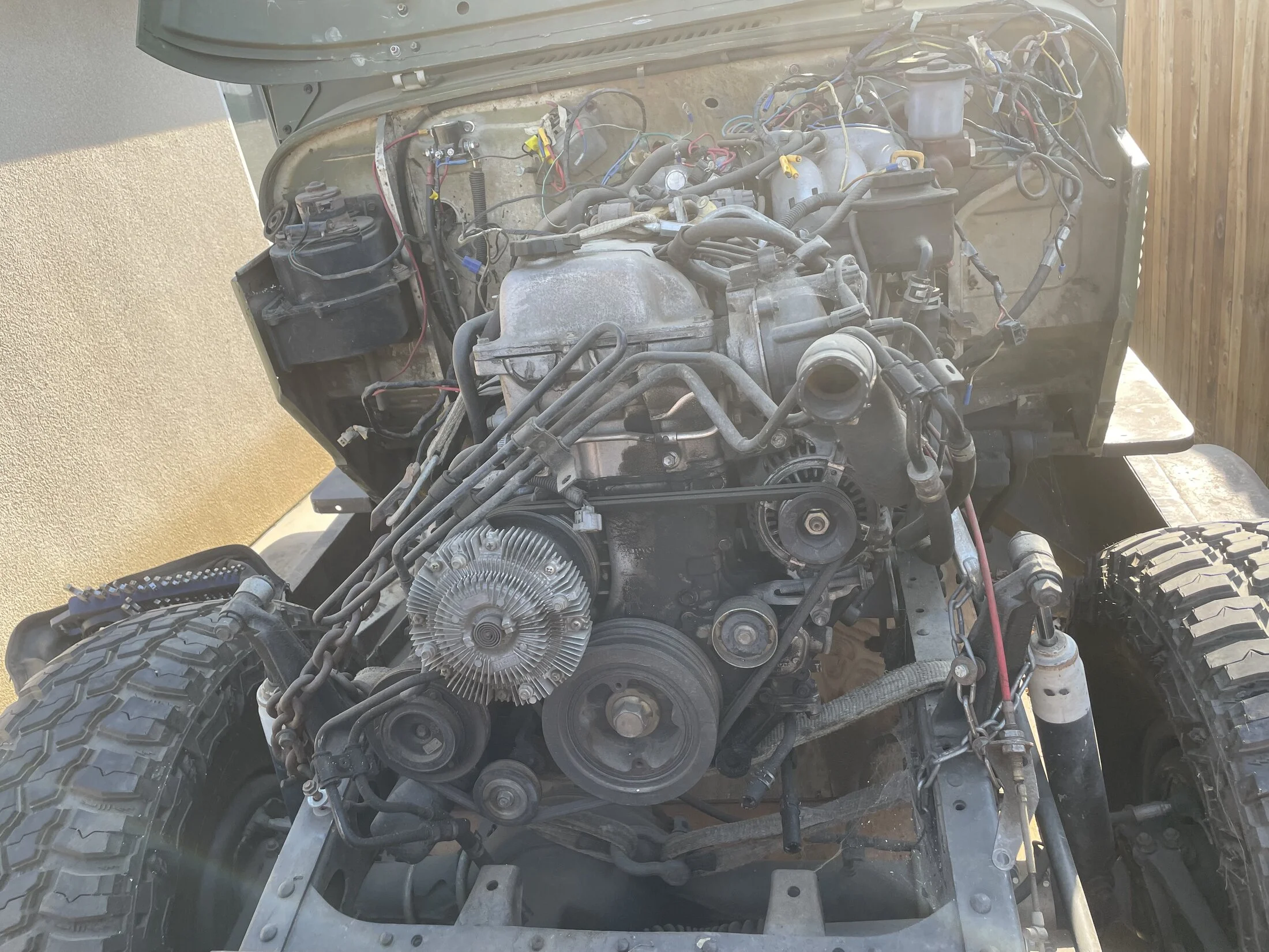

Here’s a few pics of what I done so far that’s with the original automatic transmission if anyone has any info on the mounts / and transmission that could be use like the h55 or the 151 i would really appreciate it palfaro48@yahoo.com thanks everyone
