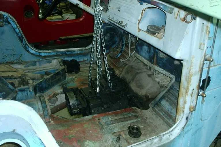

That be a tranny going in

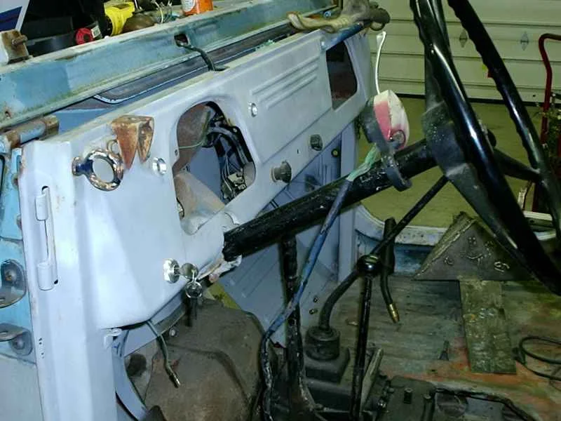

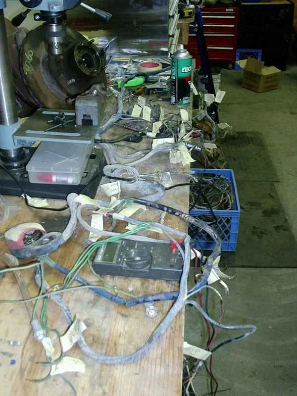

Cleaned up the dash, removed and repaired the wireing harness, filled holes

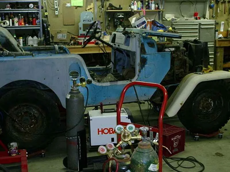

Welded up old heater hose holes on the firewall, then rattle can
Right now I'm trying to get the windshield back in shape, removing broken wiper screws, repairing the broken stud on the right side ws hold "up" thingy, which bred three broken screws holding the thingy to the ws...so I might as well do the left side while I'm drilling and taping

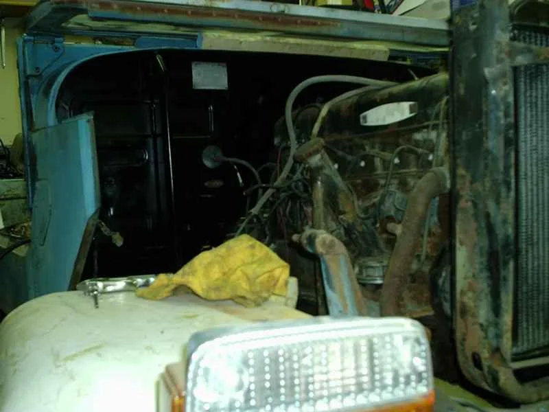

Cruiser Chick stated that fuel and sparks, when added to an engine, would produce smoke and noise, so I put the theory to a test....and you know She was right! The darn thing lives:bounce: :bounce: :bounce: It is going to need a head gasket for sure, impressive frothy milkshake spewing from the radiator when reved, BUT IT LIVES! (for a little while). 155, 45, 110, 65, 55, 130. I will be happy if it is just a gasket, oil pressure seems good, 25 at warm idle, 45 when reved.
I guess POs didn't park 'em for working good!
Motor needs to be rebuilt:frown: I feel a serious case of "while it's out might as well" coming on :eek:
Bah. Lap the valves and a head gasket, better than new. :D
Spent some of the day at the machine shop going over the engine...one of the cylinders looks like it was rifled by broken rings, a couple cam lobes worn bad, four burned exhaust valves, two cracks in the head...it was kinda nice to have a couple extra 135 heads on the shelf to give the machineist, maybe make one good one...
I was thinking that maybe the valves got burned when two of the locator rings between the intake manifold and the head got buggered, they were kinda sideways and crushed and probably made great intake leaks...just a theory:rolleyes:

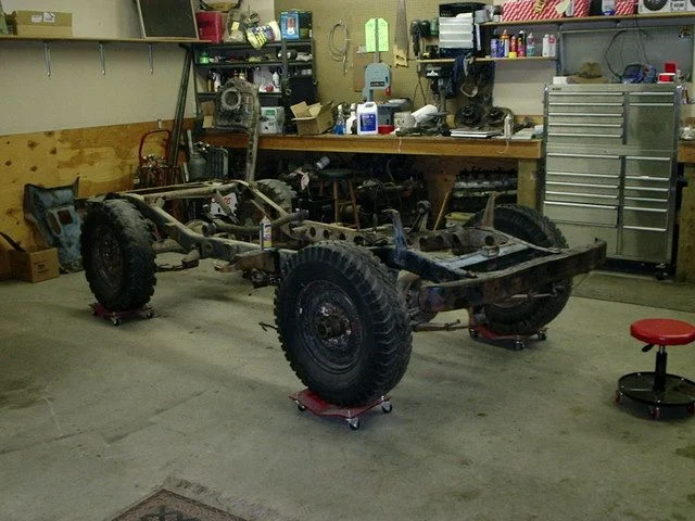

Tonight's progress, no suprises, getting it ready for the sandblaster...I've blasted frames before and I just don't want to do it anymore!
Pretty soon you'll have a shiny frame to roll around like the rest of the 25 projects! :D Check to see if you have body color and then yellow zinc chromate primer underneath......just curious.
