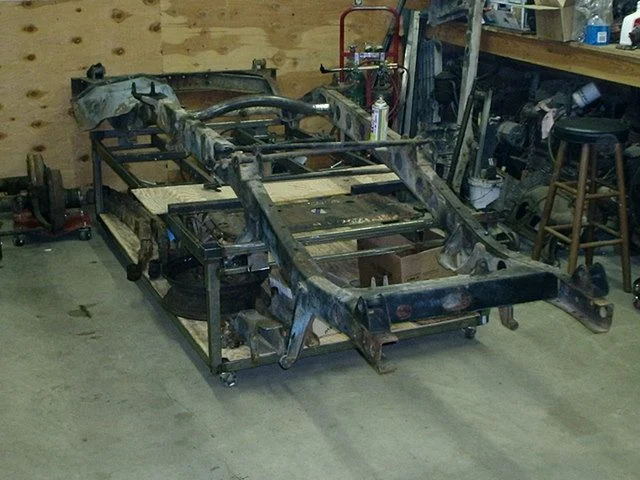

Project Two Speed's original color was grey...yes, a painted frame soon I hope, though I just got an estimate for blasting a frame, four springs and five wheels :eek: . I'll be buying a honkin big blaster and a ton of sand and still be coming out ahead

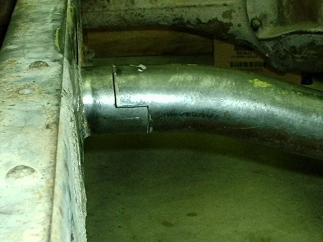

I chose the low road on the crossmember, let future generations worry about tranny choices!

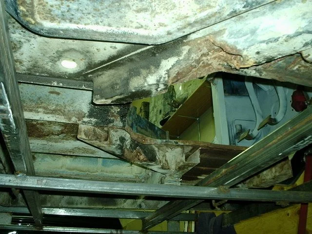

Nice of them to leave you a stub to work with. Why do you think they cut it anyhow?
The cross member and some of the underbody support sheetmetal was cut to make room for a later model four speed, and later suffered from some sort of drive shaft disconnect...the body is tore up pretty good underneath but repairable

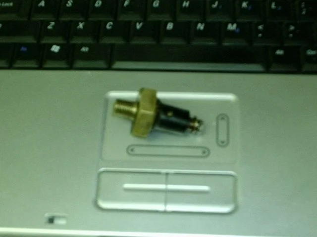

This is where Two Speed comes to a halt for a couple weeks...oh, and found this oil pressure switch in the frame rail!

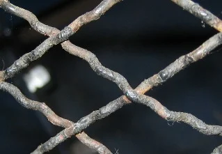

Yep, screw terminal...I was high-grading parts and taking decorations off of the wall when I noticed a difference in grill meshes, one has about double the crinkles per inch than the other, anybody else notice this?
And yes, Archie, I'm thinking of you;)
The white one is a 1960 production year "model 1960", while the black one is a 1960 "model 1961"...though I do have a 1959 Model 1960 crinkle-ee one and a 1960 model 1960 uncrinkle-ee one....my guess is they can go either way, though I'm just now noticing the difference:doh:
OMG...we don't need crinkle cops, do we?
Thanks Phil. So which one is mine? :)
One extra-crinkle and two crinkle light. With the extra-crinkle in the middle of the consecutive numbers. :rolleyes:
I think some Japanese "saki" was involved with this radiator screen just to fool with us some 50 years later than these parts were made! I see no other reasoning. BUT these vehicles were construed from the Toyoda Automatic Loom Works. Soooo, They knew weavingI I'll check out Old Farts "crinkles" tomrrow. Who has what?

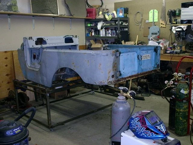

Time for an update. The frame is off to the paint guy, he is trying to match the color on the white seat frame to a current Toyota color, first try was "Too white". I am leaving on another trip so the Girls will have to make the call! So this is how the project sits now, the body is not all that bad. Work neede on rear sill and quarters, one of the crossways stiffeners under the rear floor, transmission arch betwween the seats, gas tank area, and the damaged supports under the seats. More spot weld cutters!
