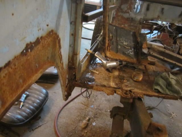

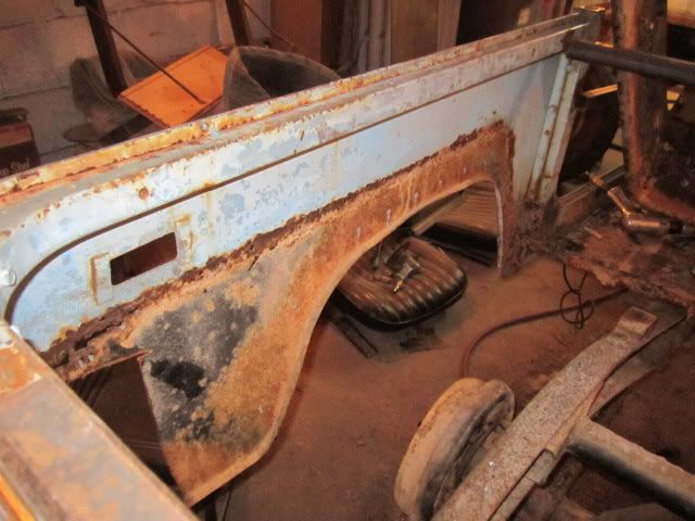

I only got an hour to work on the tub today. Got the upper wheel well removed and did an inspection of the rot. Not too bad, but still will have to go under the knife.

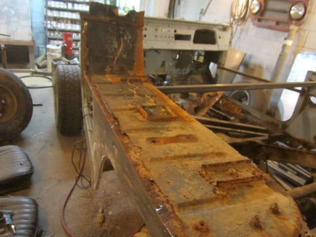

Here's the panel removed. No surprises thank God. Still got some patching to do.

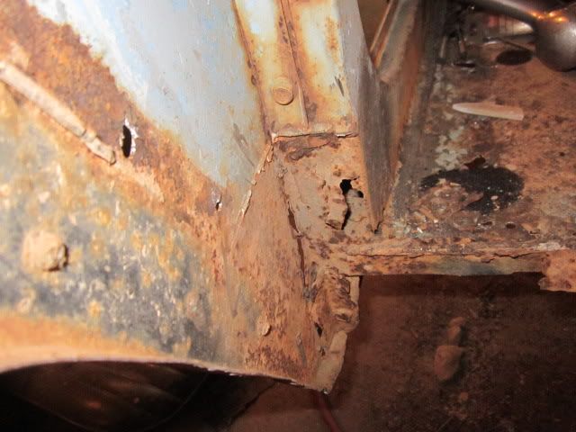

This is the infamous Toyota "triple lap seam" flaw they also had on the 84-88Toyota P/U beds.

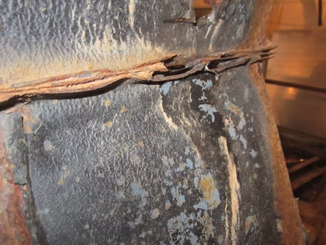

The final pic shows the under side of the upper wheel well. Cut, cut, weld, weld...............grind:cool:!!!
