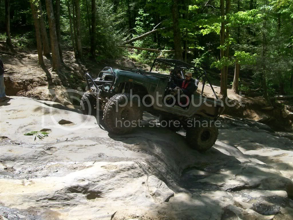

When I first did the spring over on my rig, I did it with stock FJ40 springs and no body lift. It cleared 38.5" SXs with no problems. And I had the front fenders cut back to just the inners like you want to do. Then I went to 39.5" Iroks, and they cleared fine also (I removed the inner fenders though).
Why the 1" body lift?
The first pic is on the 38.5s, and the second is with 39.5s:
