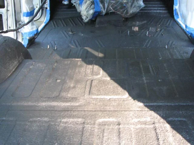

i have never used Lizardskin but have done a 55 and my 80 with a combo of Dynamat, Fatmat rattle trap, Damplifier pro and Spectrum and Spectrum Sludge and Firewall which has ceramic properties.
With the second skin products they recommend applying all the coatings on top of the Dynamat/Fatmat...
It might have have something to do with the mat sticking to the coatings... I would check with Lizardskin unless you already know the answer
Spectrum Sludge Firewall with ceramic
attachment.php
Spectrum Sound Deadener
attachment.php
80 doors ..inside of the outer panel and the inside panel with Fatmat and Spectrum Sound Deadener

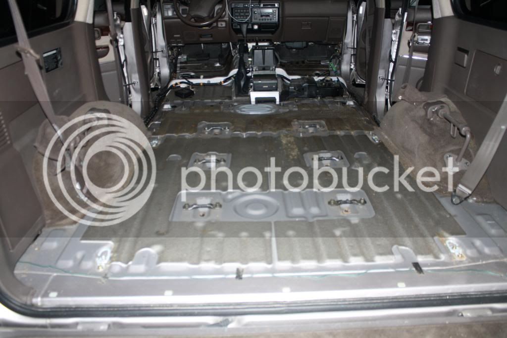

The 450 was pretty dang clean. for being as old as it is

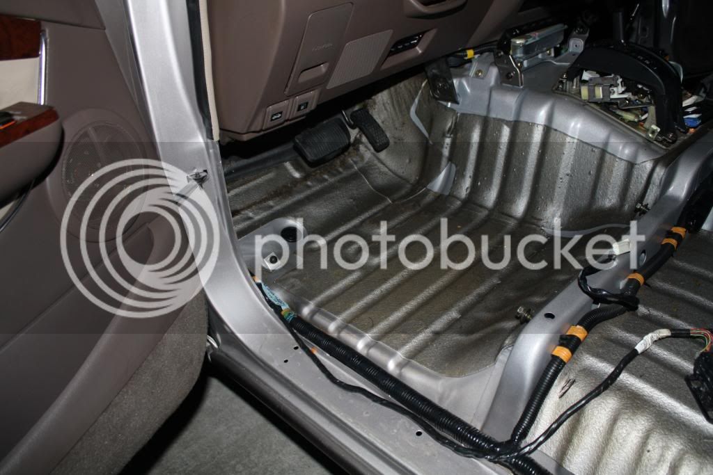

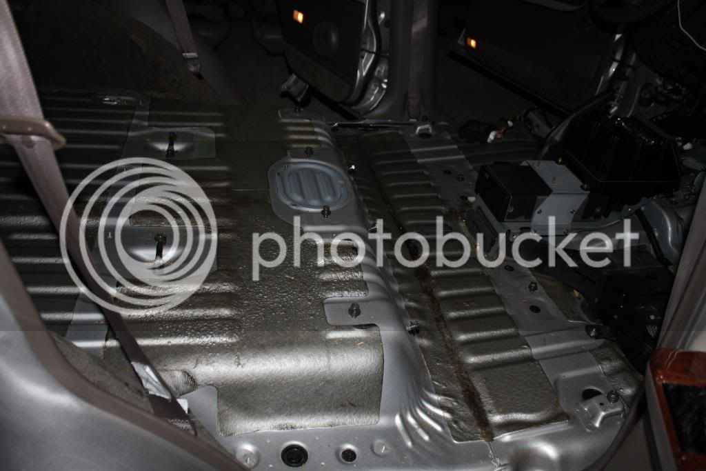

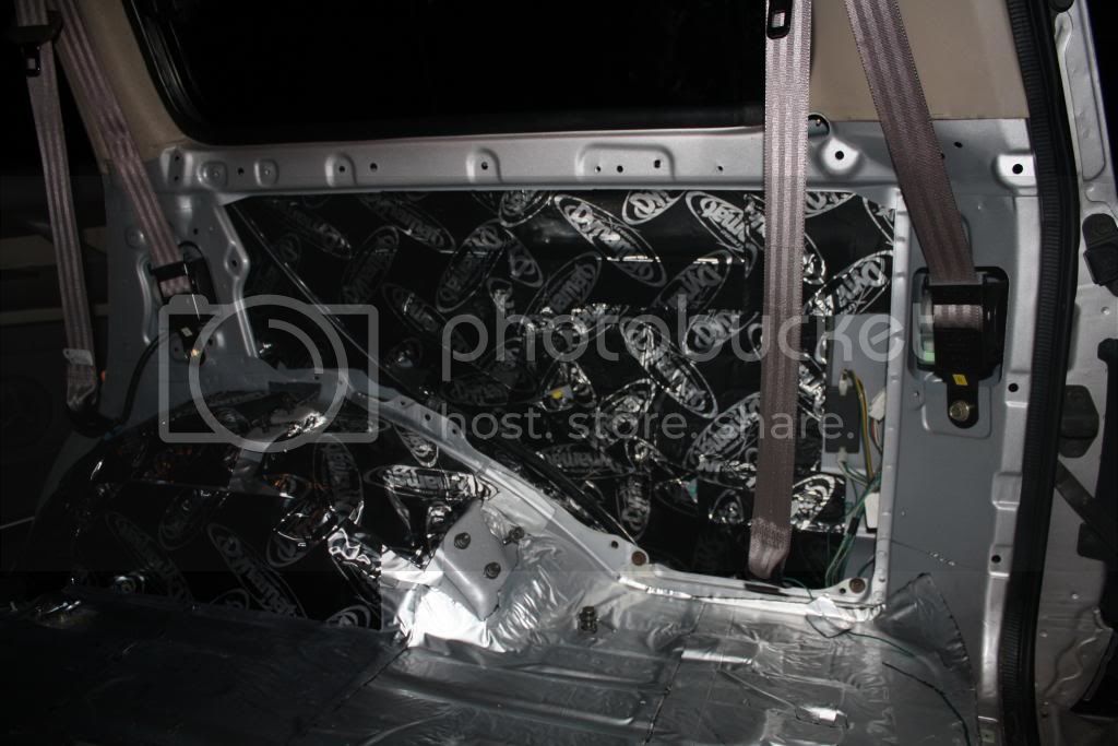

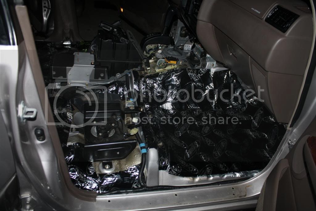

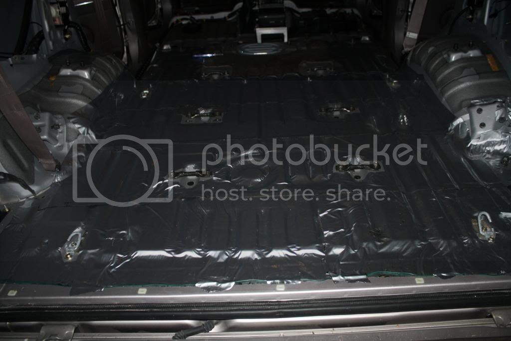

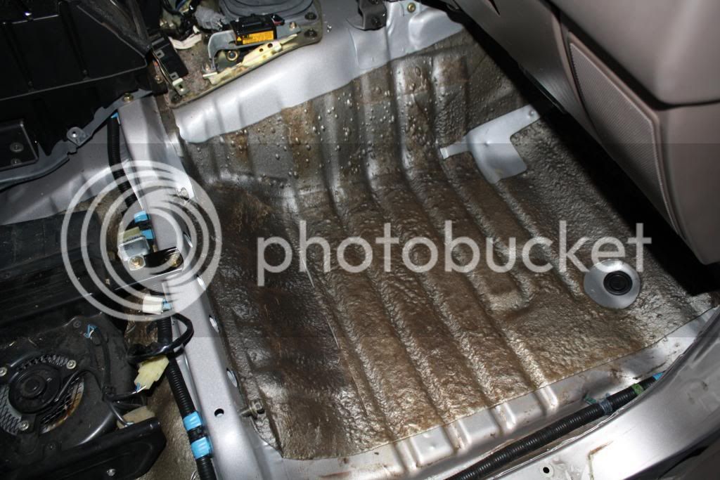

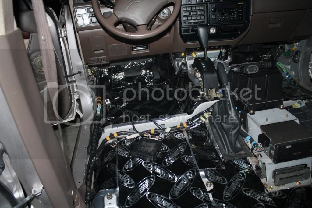

striped

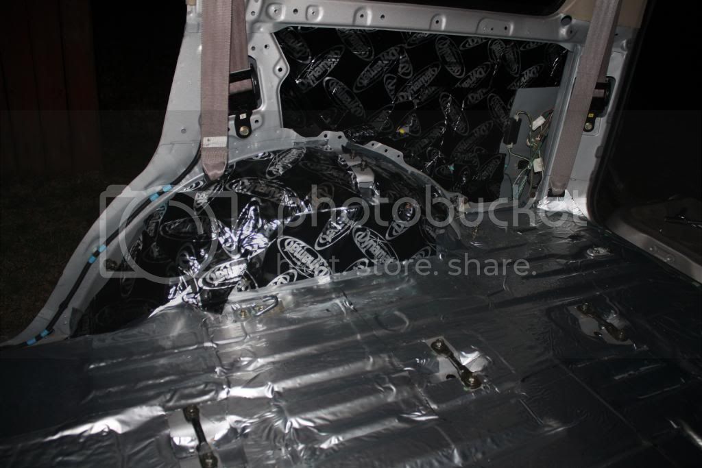

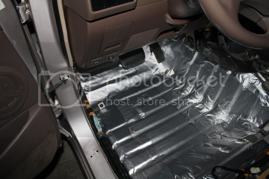

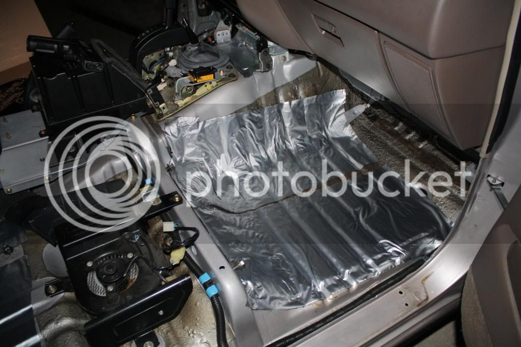

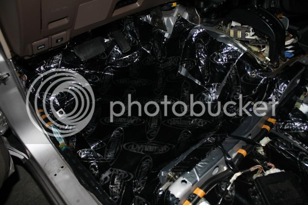

First layer
The first layer is mainly to try to cover most of the floor board with thinner and cheaper material, i believe its called hush mat.
I will hit some areas with a second layer with the Dynamat extreme, which is alot thicker and way more expensive.

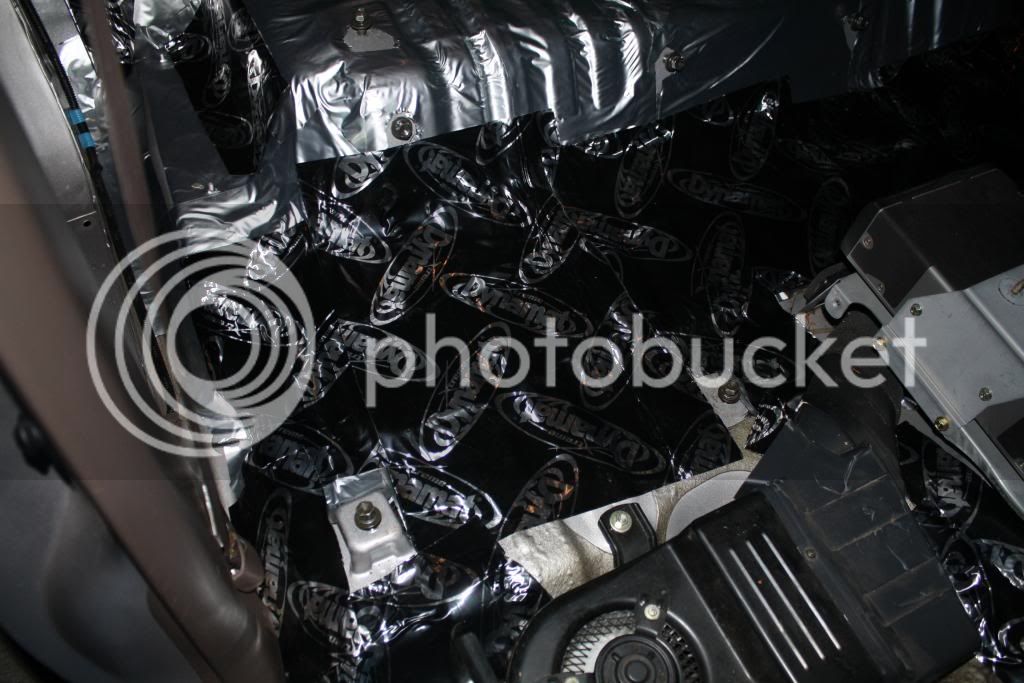

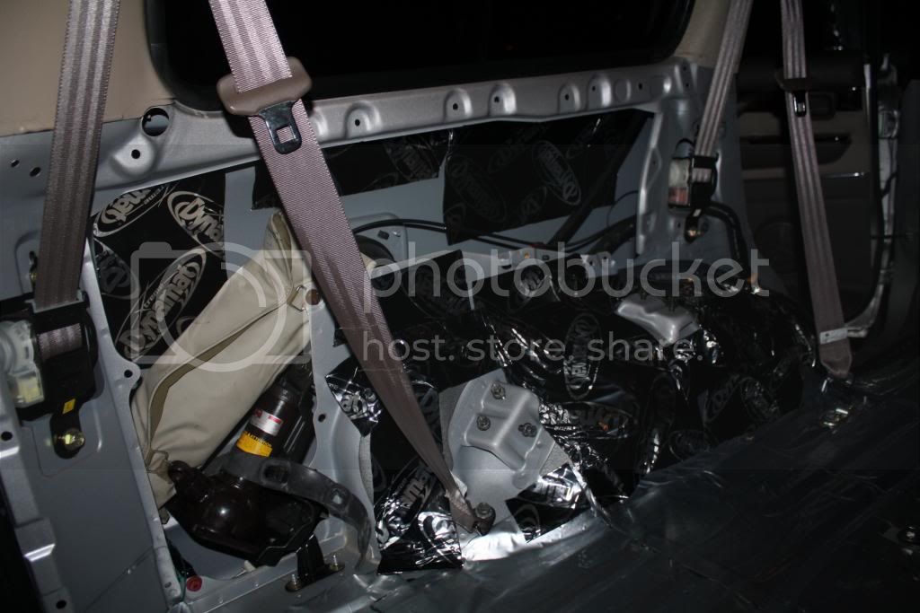

The second layer with the thicker dynamat extreme was used in the
rear quater panels, and wheel humps, which is where most of your road noise will come from since it is right above the tires
passenger rear and front floor boards
driver side front and rear
here is another picture of the rear passenger side finished
