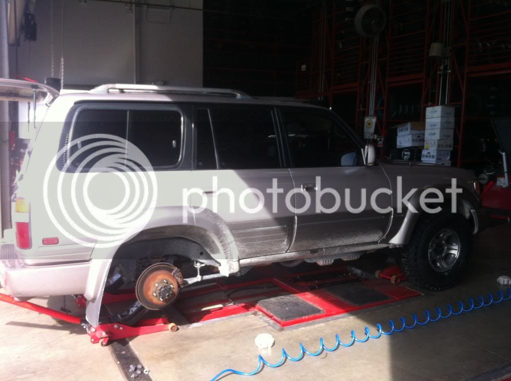

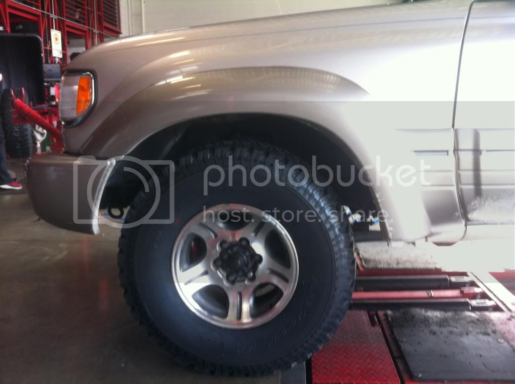

Here are some pics-
At discount
http://s1353.photobucket.com/user/shooter6577/media/LX450/IMG_1652_zpsc56c34e1.jpg.html
http://s1353.photobucket.com/user/shooter6577/media/LX450/IMG_1651_zpsc0e1f9a1.jpg.html
http://s1353.photobucket.com/user/shooter6577/media/LX450/IMG_1650_zpsd8dd2c39.jpg.html

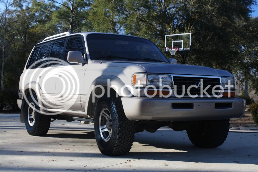

here are a couple of pictures I took in the driveway
http://s1353.photobucket.com/user/shooter6577/media/LX450/IMG_9492_zps8558ebb6.jpg.html
http://s1353.photobucket.com/user/shooter6577/media/LX450/IMG_9486_zpsb0a6e35e.jpg.html
