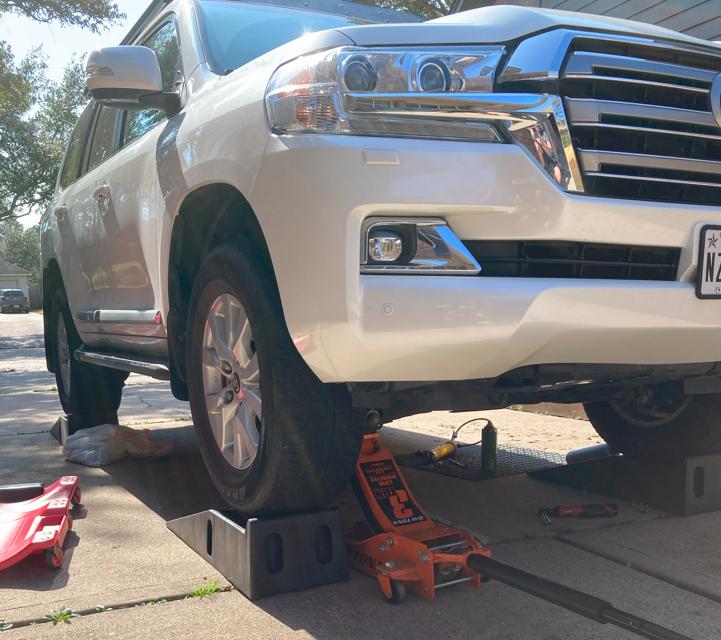

As long as at least one front tire is in the air the conditions that let the rear turn should also work on the front.
I use two ramps and a jack to make this easy..
I have the car on all 4 jack stands with the wheels off. The rear shaft is very easy to rotate. I just don't know why the front shaft will not budge as much.

The rear diff and transfer case universal joints had enough 360 access and the front diff I was able to line up by:
- Jacking up one wheel so you can rotate it
- While having the hand brake firmly on and the vehicle in neutral. I think I did in accessory mode, may also have had the engine running. It throws a warning buzz as you release the foot brake and leave the car in Neutral, but it is a 2 min job. Also had blocks behind the rear wheels on the respective ramps.
This method allows you to turn the in my case passenger wheel and turn the front drive shaft until good line up of the zerk.

If your 200 was on jack stands with all the wheels in the air, trans in neutral, handbrake off, t case not locked, you should be able to rotate driveshafts freely and relatively easy. Car shouldn’t be “on,” but to shift to neutral iirc you will have to be in ACCESSORY mode - annoying tone and all after shifting to N.
If all these conditions are met and you’re having issues, there’s something else going on or you’ve missed one of the above steps @Phantomx33
I am not fond of putting the 6000lbs 200 series on jack stands all the way around and find driving onto 4 ramps and jack up one wheel quite easy and safe.

As far I know you cannot unlock the transfer case (edit - i mean put it in neutral and free spinning). Lifting one front wheel and turning the same to align the front drive shaft to differential grease zerk works with the automatic transmission in neutral. This with the hand brake firmly on and some blocks behind the rear wheels.
