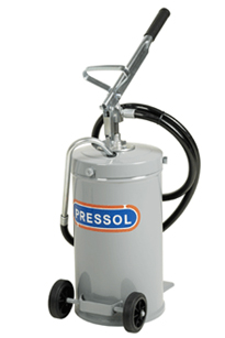

I've been fortunate enough to steal something like this from the workshop when I need to pump grease. It has a long flexible hose and manages to reach every grease point
