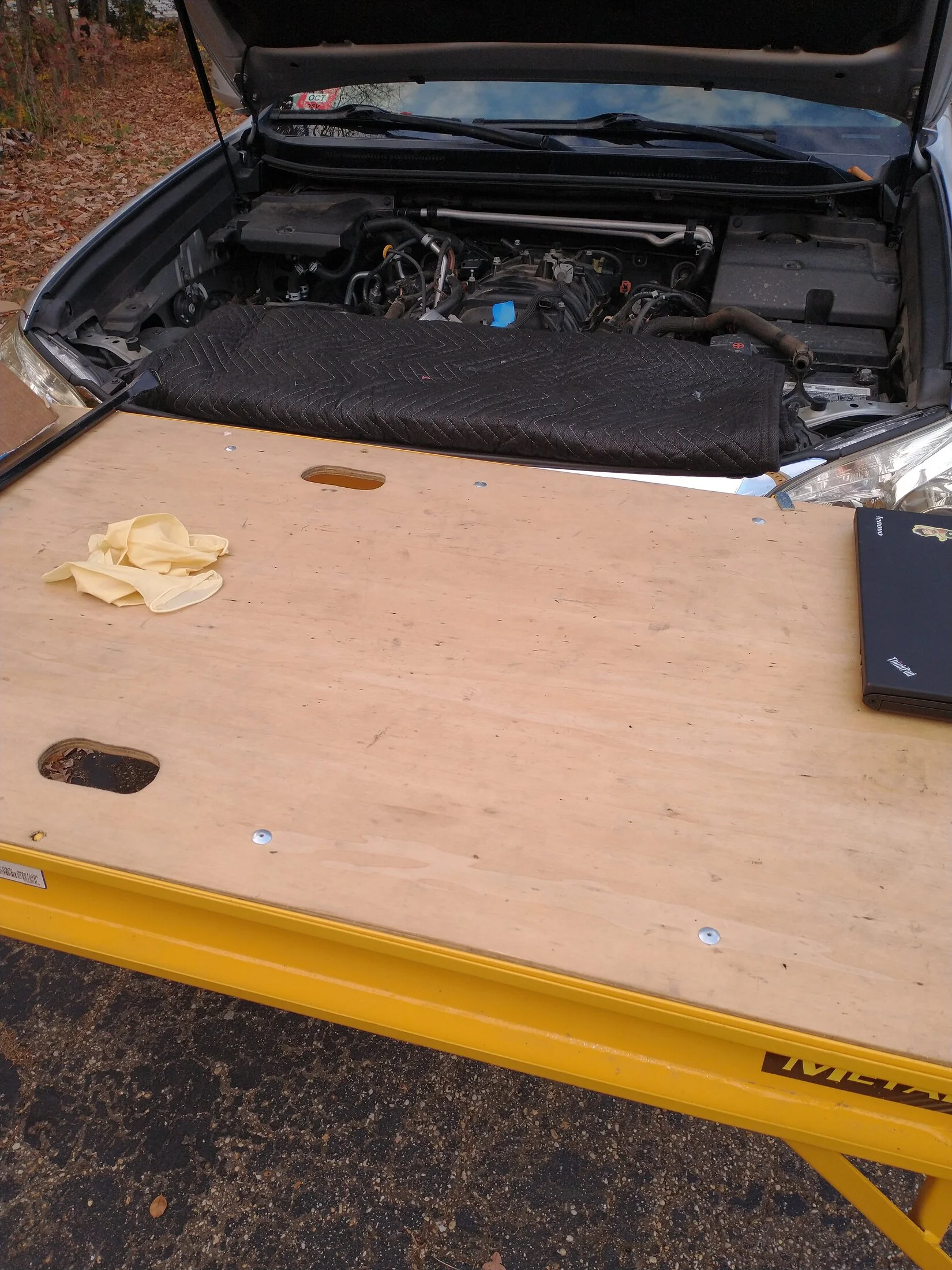

So I mentioned here that I had been losing coolant at a very slow rate. Because of my mileage (134K) and frequency to tow our camper long distances, I wanted to make sure this wouldn't impact future travel if preventable. Utilizing research from @jmanscotch and @agentmm, I devised a plan to complete the task without breaking anything. That failed.
After everything you see here reconnected I experienced a transfer tube leak (at valley plate). I disassembled enough to where I could create a rough coolant loop to test against this failure before reassembly.
Circled is where I connected the coolant hose to throttle body directly to EGR manifold temporarily to isolate fluid loss. The first time I did this was a complete failure with a pinched packing. Coolant really does pour out as fast as you put in.

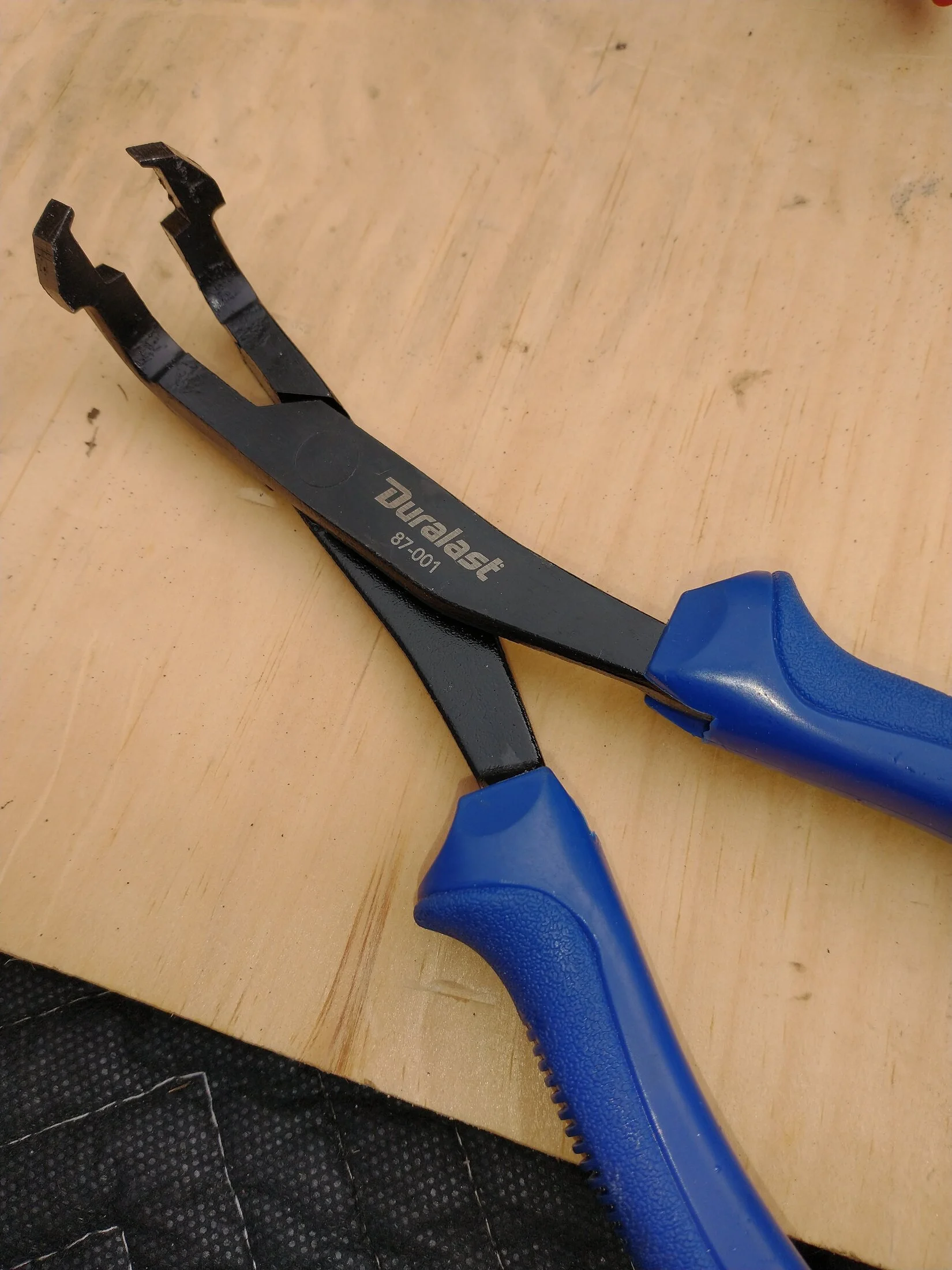

Back to the drawing board, I used Permatex O-Ring Lubricant instead of soapy water to lubricate the transfer tube packings. Much better result. No leaks. Put everything back together and tested on a decent run. Just to note, If you have issues with disconnecting the fuel connectors, something like this can come in handy:
Second time was easier.

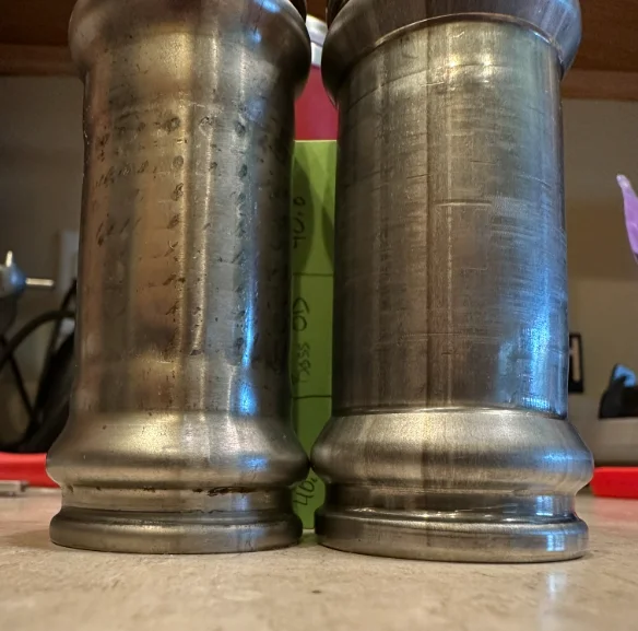

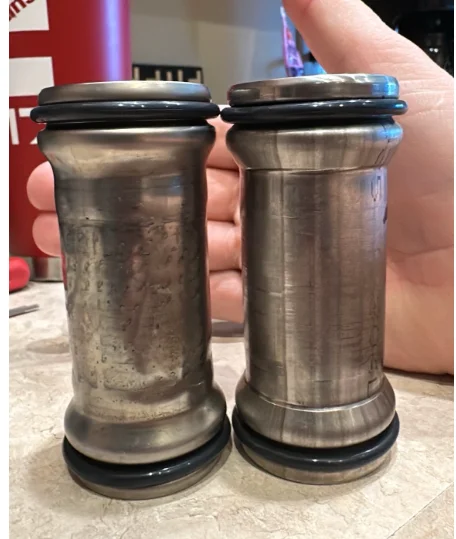

It's been a few months, but I'm still feeling pain of the same thing-- doing the cover plate-- TWICE because the crossover tube leaked upon first reassembly.
I ended up ordering a new crossover tube because Toyota has superceded the design. The design differences are minor, but they are real.
It seemed easier to assemble the 2nd time. I used Hylomar Red for my coverplate as well as a dressing on the seals.
Revised part is on the right (IIRC it was slightly shorter as well as had minor changes to other dimensions like tube ID and gland geometry. I suspect these changes improve the resistance of the o-ring to rolling up from the gland.
That is interesting that they changed the design of this part. It would be difficult to prove as a solution without going back to that place and repeating. 😉
The fact that I had success after application of rated silicone treatment to the new o-rings gives me confidence. If I have to do this again in another 150k, I may give the new part a shot.
