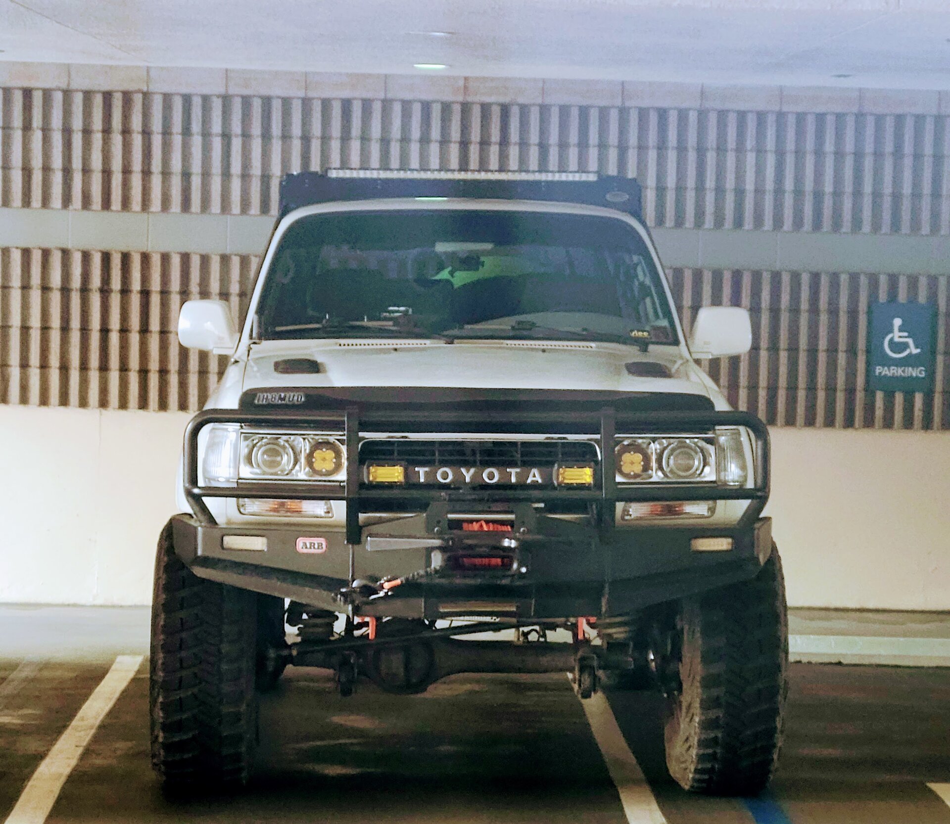

I am running Freedom Retrofit LED headlights, they are projectors in Depo housing. They have been great so far.
It looks like you have amber lights on the low beam. The freedoms I found in a google search don’t have that, did you modify them or get a custom set?
They were an option with them a while back. I run the Baja spot in my high beam and it was a great combo.
