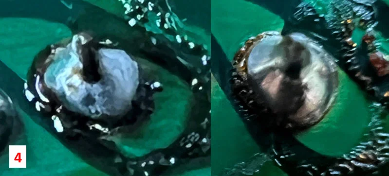

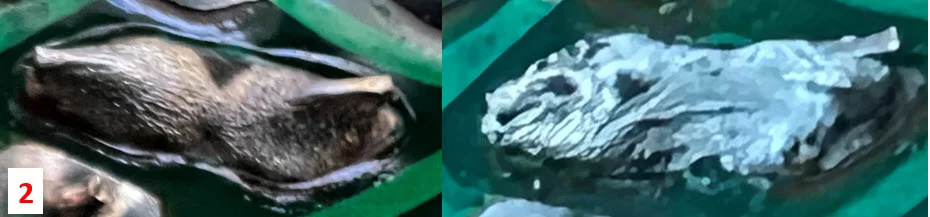

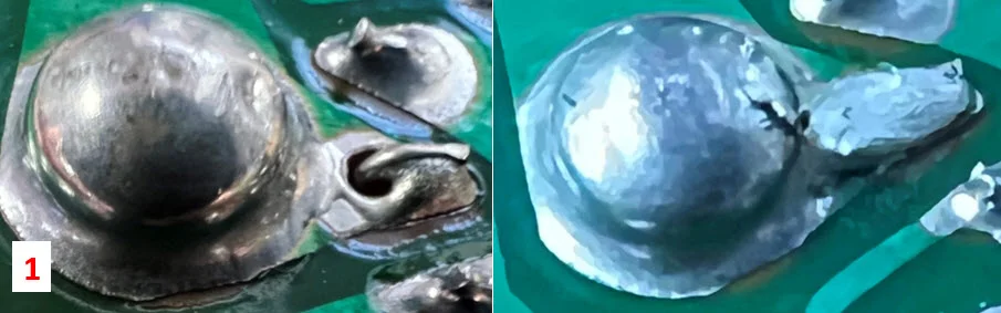

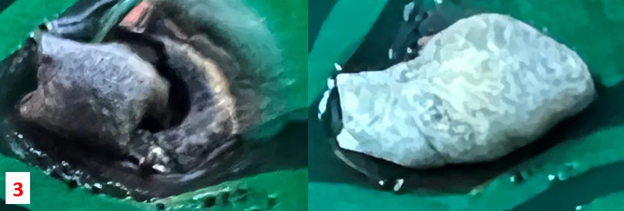

Both power windows were not working, Door Locks worked fine. All grounds good. All Circuit Breakers/Fuses good. All switches good. Power to the Master window switch and Passenger switch is supplied from the Power Window Module (passenger kick panel behind ECU on my Truck). Removed Module, opened case and found (4) questionable solder joints. Repaired all four and now all windows function properly. Before picture of module shown below with four areas of concern. Before/After details of each repair included as well.
