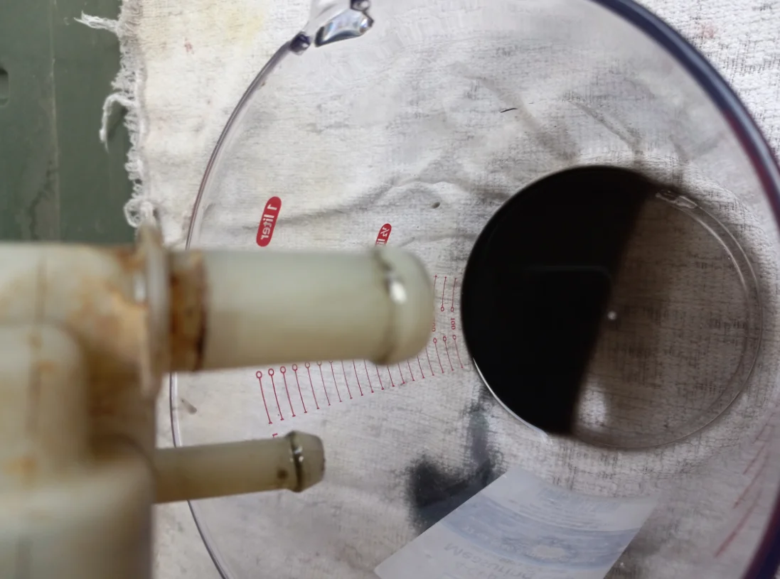

I had the happen a couple of times when making a left turn onto a boulevard from a side street. It turned out that my PS reservior (and screen) was collecting dust and dirt. The cap was not properly sealing. So it sucked dust and dirt into the system. It must have been starving the system for fluid during turns. The fluid in the reservior was on the full line. Eventually the pump became so noisy from ingesting dirt and mud that I had to replace it. The pump had been replaced a few months earlier to remedy a constant whine.
I would start by cleaning out the reservoir and the internal screens.

The reservoir needs to be drained and removed to clean the screens in the bottom of it. There are some threads that walk you through the process. Mostly drain, clean with hot water and soap and a brush, and dry.

Here's a new reservoir where we can see the new micro screens inside.
