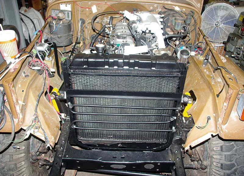

We have put the above cooler on several FJ40's, they are likely too big. Have been watching the temps and they run somewhat cooler than I would prefer, but they fit nice!:hillbilly: These are "nice day" rigs, wheelers not DD, much more likely to be run at 100F+ than below 50F and likely never at 32F, so in this application, can get away with it.:hillbilly:
This is another one that we run, it's simply copper tube. Works great most of the time, but can be less than needed when playing in the rocks at high temps.
