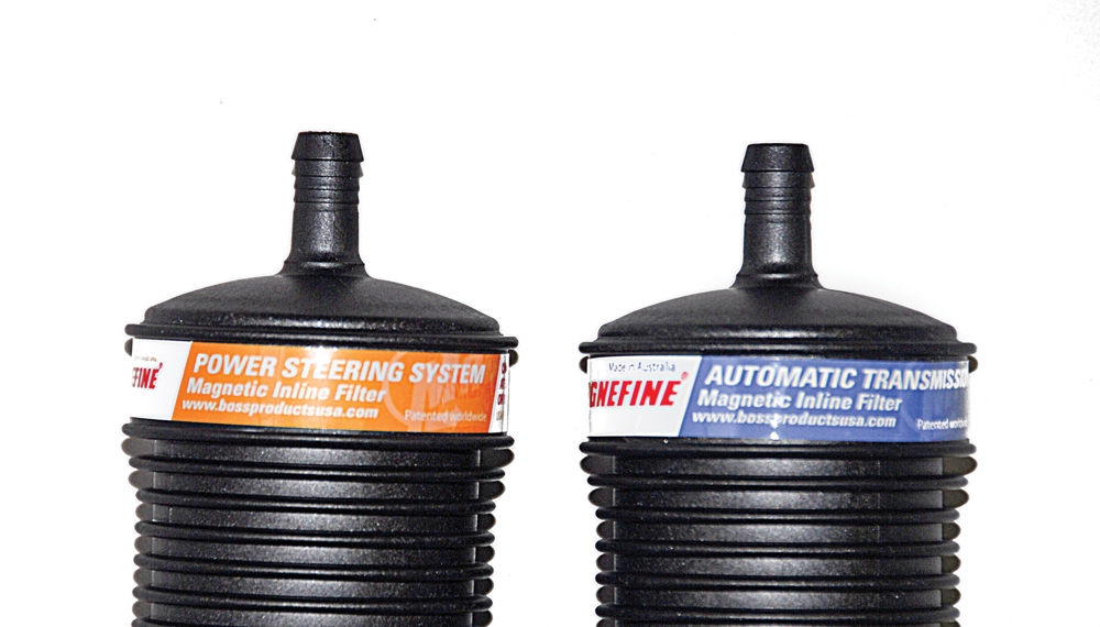

If you're replacing yours, now is the time to put a tranny microfilter in the return line. And use a synthetic Dextron fluid.
Looks like NAPA is selling a better hose than the one I bought 5 years ago .. I also used the cut to fit trans/power steering line.
http://tinyurl.com/p8gv48g
Any indication that this filter will reduce flow (BEFORE it gets clogged) or cause more problems than it solves?
Your filter looks better than the Cardone...

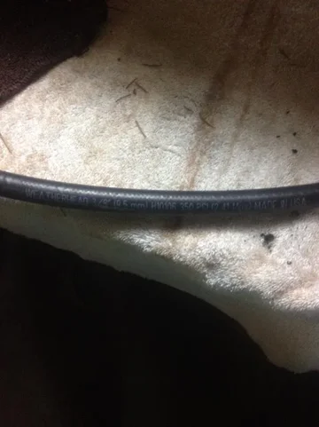

Sorry didn't get til late last night. Here is the hose and Dan is right it was cut to size was pretty cheap too if I remember.
The return line is relatively common, from most parts stores, 3/8" TOC (transmission oil cooler) hose. Don't want fuel, water, etc, hose, the oil will affect it, making it soft, fail in a relatively short time.
You reminded me I didn't post the size I got. 3/8" here as well.
Edit: Sorry Greg the pic of your 3/8 came up after I posted.
