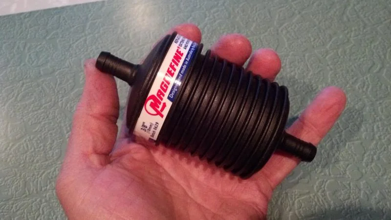

Mark - thanks for the Amazon link - that's a steal for those PS filters. I think I was quoted $26 at NAPA years ago for that filter (or an equivalent).

Waiting for delivery of the inline filter... I MAY add an oil cooler too...
Thanks all...
Mark

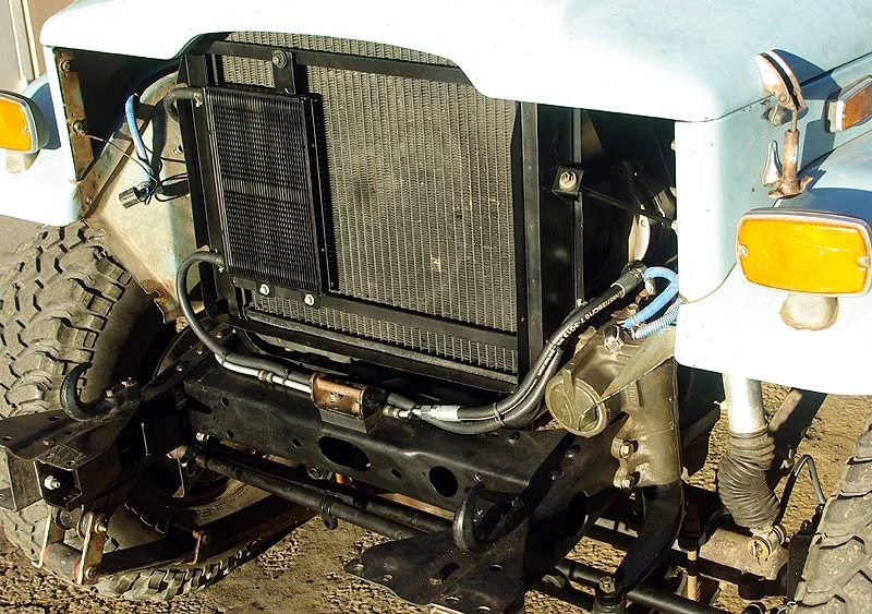

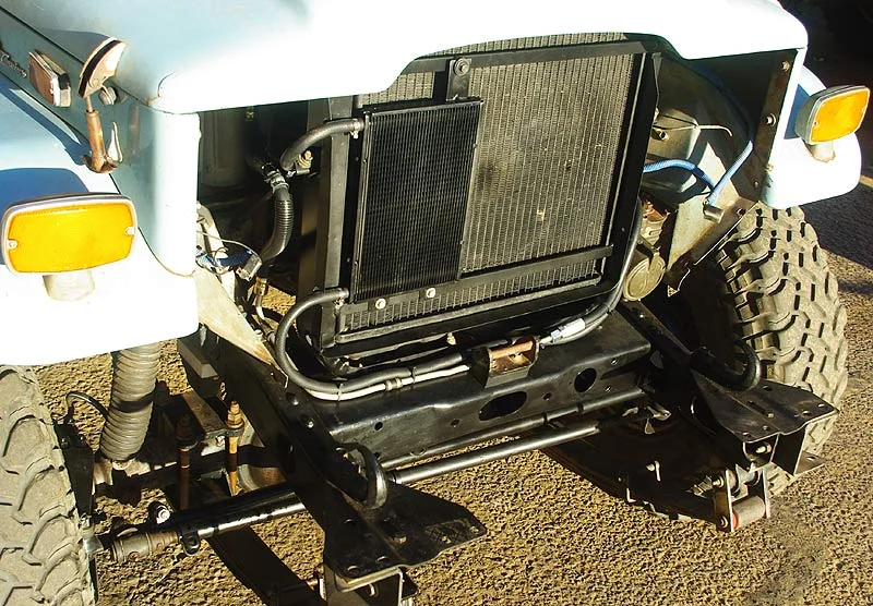

Too bad MAFs website is still in limbo - they used to have a tranny/PS cooler that fits perfectly on the side of the radiator support and is far more efficient than that tube that runs under the radiator ...
I'll see if I can find it somewhere else...
Thanks.... I don't mind having to build a bracket but if I can avoid it it will get installed more quickly....

OK I guess I don't quite understand the need for a PSP filter? Is there a way that contaminants can get into it or are we just talking about filtering out wear products from the steering box and PSP itself?
Agree, we never use a filter.
Have to be somewhat careful with coolers, you want the system to get to operating temp, it's easy to over cool, especially important in cooler climates. In some applications, the oe mounts the cooler under the hood, so fan output is blowing on it, warms the fluid in cold weather.
Our favorite coolers are OEM, pick & pull. Some of the Lexus models have very nice PS coolers. Where space is an issue, our favorite is off a Ford Explorer, AT, it is a nice stack plate type and very thin, fits FJ40s well. Works great in the desert, maybe big for cooler climates?

Nice work Kevin.
I am getting ready to install an 80 series tranny cooler into my 60 for the PS as well.
Nice work Kevin.
Yowza, that a big cooler for P/S, likely way too much?
