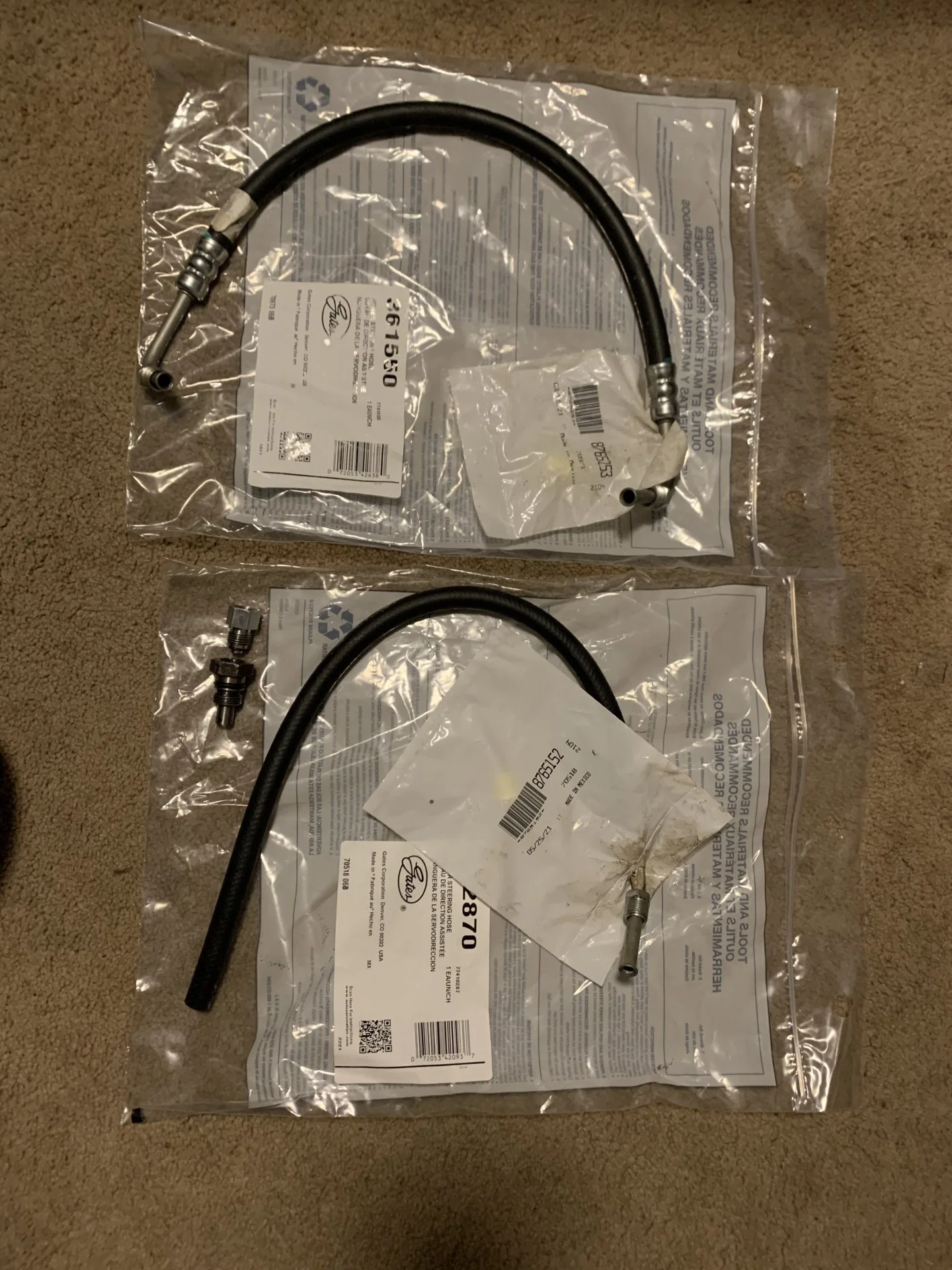

Good to know. Based on the prices of lines at Bumper to Bumper, and fittings an Princess Auto I decided to buy Gates Scout II lines this afternoon. The pair of lines were $47 including shipping. 3 of 4 ends should fit perfectly. The lines are a decent length and the bends at the ends will work.
The high pressure line going to the pump has male threads and an inverted taper. I’ve got pumps with female threads & an O-ring seal or a male taper and male threads.

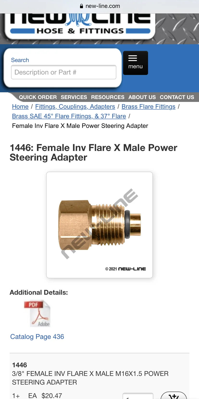

It looks like they have just the fitting I need… if I have enough space.
I’ll know once the new lines arrive. If a $20 fitting will solve it, I’d be happy.

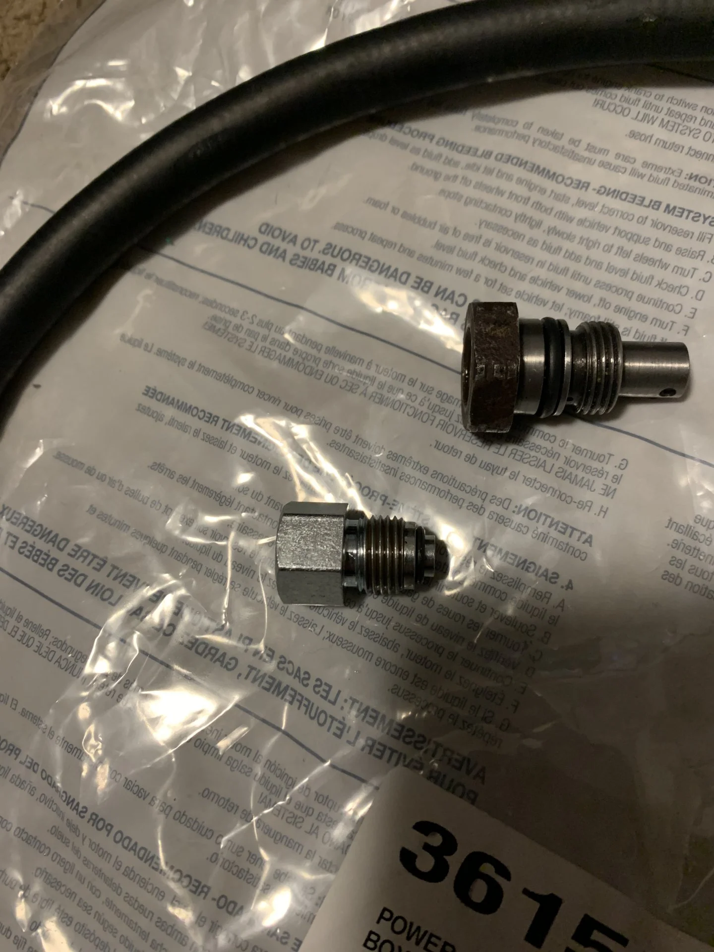

Bought a steel version of the above.
Coast industrial indicated the brass fittings do I paid a couple bucks more for the steel one.
And the lines from Rock Auto. Gates lines made the beginning of this year.
The local shops said they’re NLA and speculated that RA must have bought up old stock… apparently not the case.
These lines were the perfect length for a V8 install. They may not be long enough for a straight 6.
