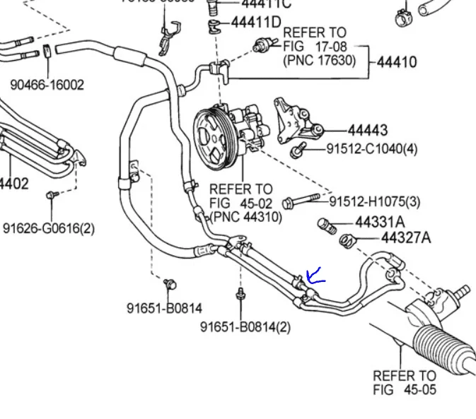

Hello,
I just purchased a 2003 land cruiser with a power steering line leak. The return line is leaking from the location below in the photo. The previous owner replaced the power steering rack so i am guessing they bent the line or torqued it while swapping the racks out and caused the seal to break. I can get a new gates return line, but was wondering if anyone knew the size of this hose to just replace this short section of it since it is already held on by hose clamps? The best i can find is that its either 3/8 or 5/8 transmission line hose.
Thanks!

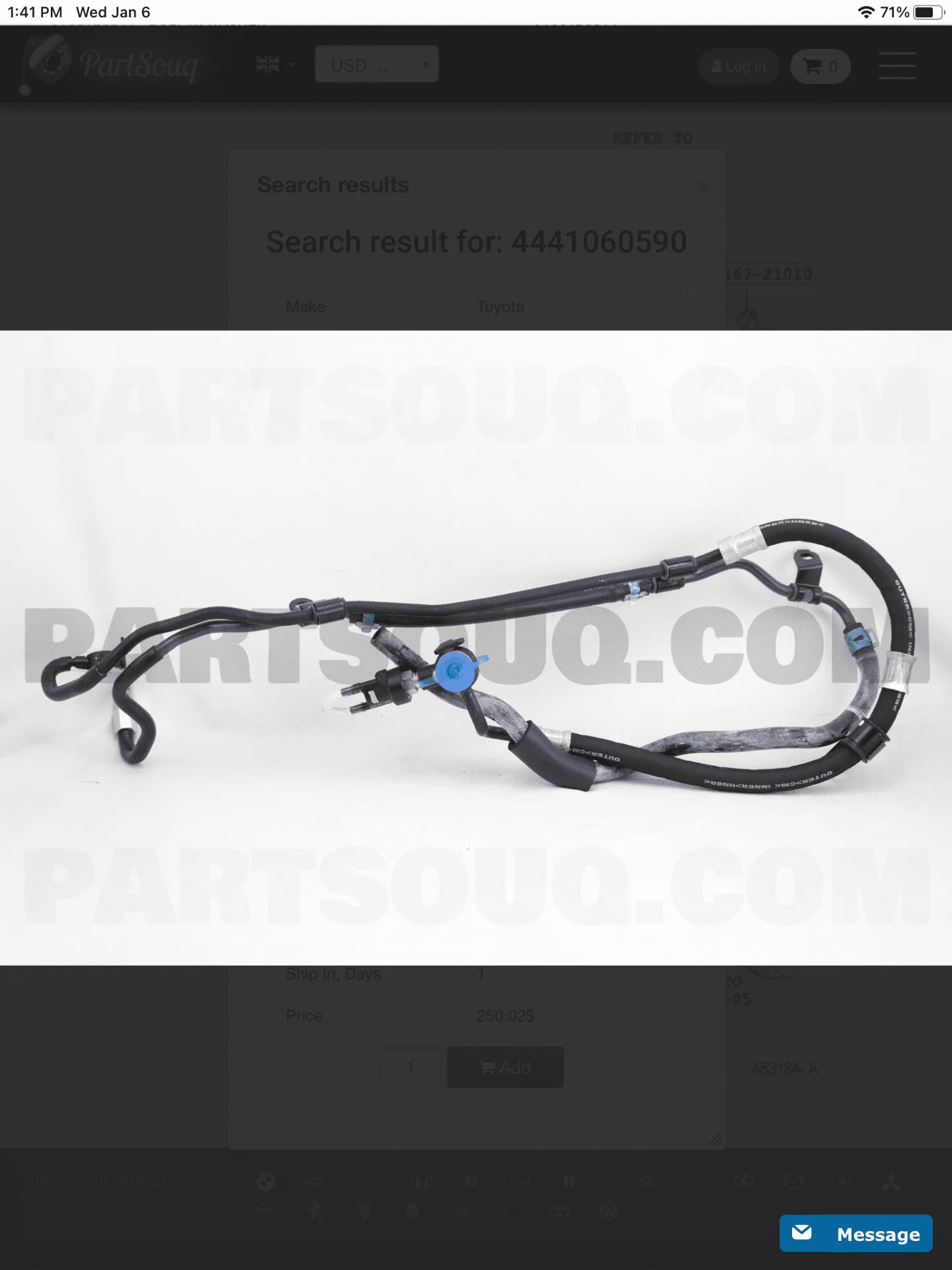

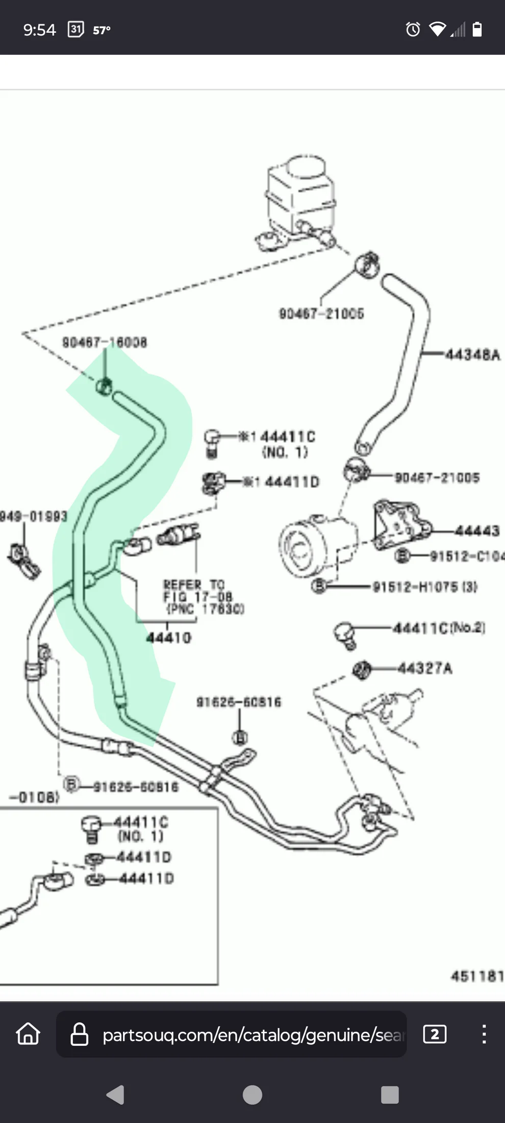

does anyone know whether this power steering pressure hose number that is shown above, part number
44410-60593​
will fit my 2002 LC. Online parts website says it is backwards compatible. But original (2002 and prev.) part number was
(44410-60510)​
but the former is much cheaper at partsouq. If so is there any preference of one over the other for the 2002 model year.
I actually just had the assembly replaced in mine a couple days ago. PN 44410-60510. Total cost including new fluid was around $600. Took a couple hours to do. Removed some panels from underneath while on the lift as this is only way to work on it.

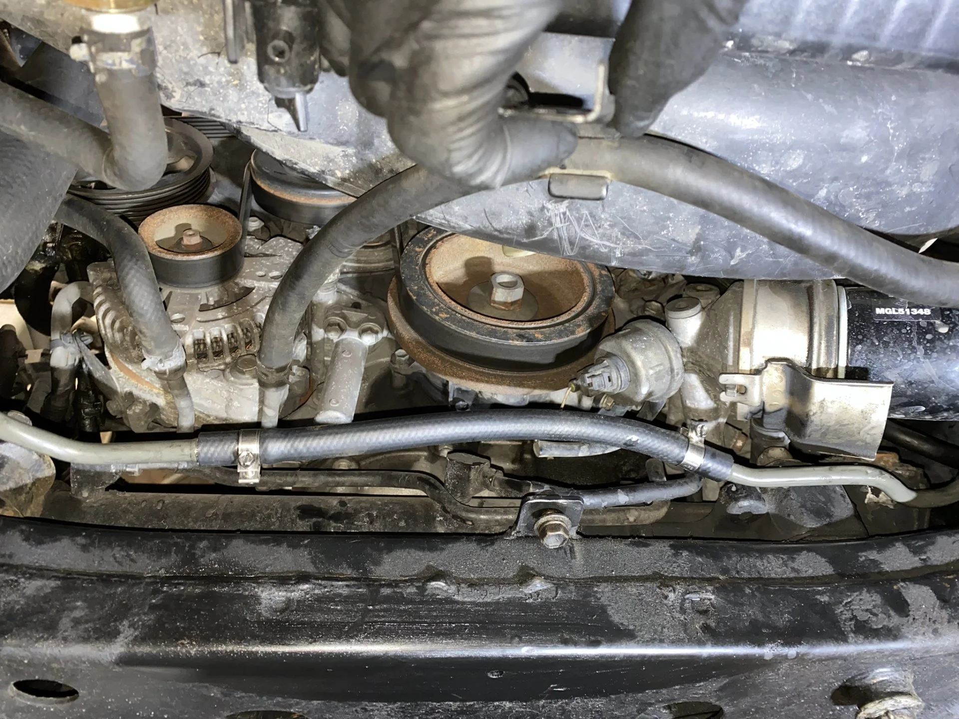

Actually the 3/8" ID transmission cooler hose works well (a little tight) here, and for reservoir return hose of the 98-02. Some parts stores' have a thicker walled hose, which OEM clamps can be reused on. Some are a thinner walled, so clamps should be replaced. In those I use fuel line hose clamps.

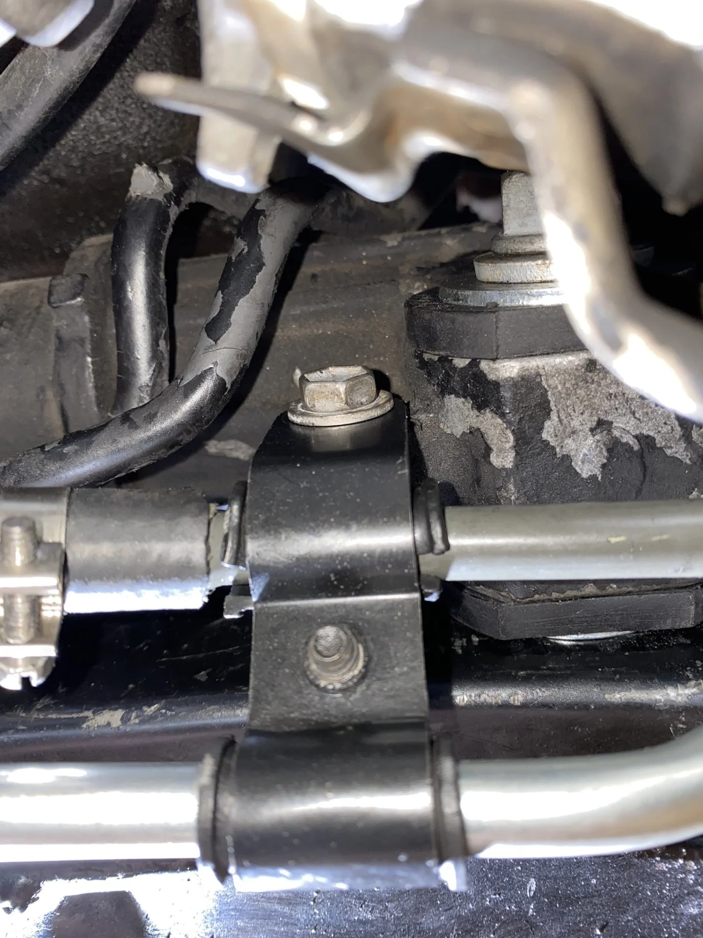

The number one reason flex hose weeps, it's not properly secured. It then vibrates/bounces around causing it to loosen from hard pipe end and go bad. This bolt holding line bracket to rack, was missing.

You asked about/said "pressure line" which I'll assume you're speaking about LOW Pressure line. 3/8" transmission cooler line w/fuel line clamps works very well.
3/8" transmission cooler line w/fuel line clamps works very well. It's a bit tight on the reservoir return nipple, depending (various manufactures) on wall thickness.
