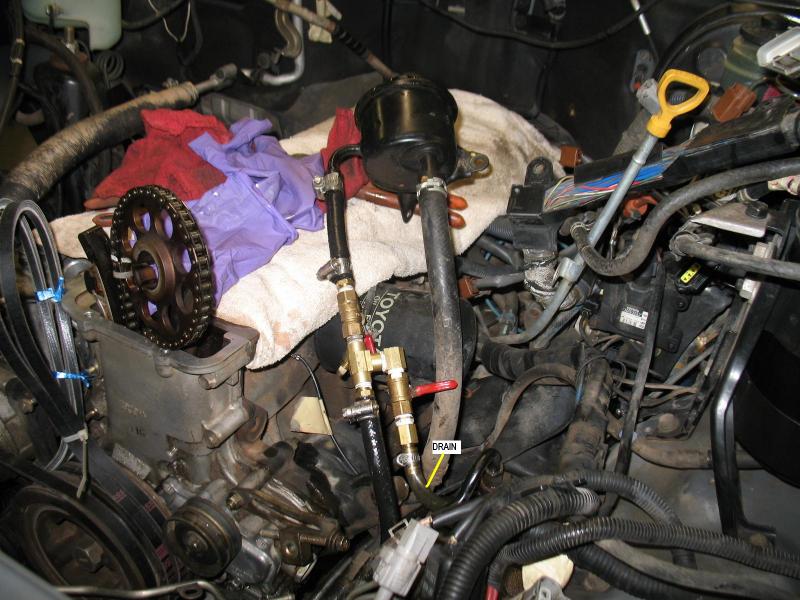

I don't have an in-line filter or anything but while I was installing the PS cooler, I re-plumbed the PS hoses and added two valves so that swapping out fluid is much easier. I'm hoping that by swapping the old fluid out frequently, the PS fluid will last much longer.

Care to elaborate on the valves you added? Sounds like a plan for mine...not much volume so the ATF cost is nil...but shortcutting the labor time would be attractive given its twice per year for me too.

It's a simple system. I installed two valves on the return line that brings PS fluid back to the res. When it comes time for fluid exchange, one valve is opened, the other one is closed while the engine is running. You can partially open either valves to control the rate of fluid expel.
I usually run one full quart of ATF through the system when I do the fluid swap. Usually takes about two mins. Caution: don't run out of fluid in the res while doing this!
The drain hose is pointed downward and a catch container of some sort is placed before the start of the procedure. After I'm done, I'll just coil up the hose and tie it to the frame or something similar.
See, told you it was stupid simple :D

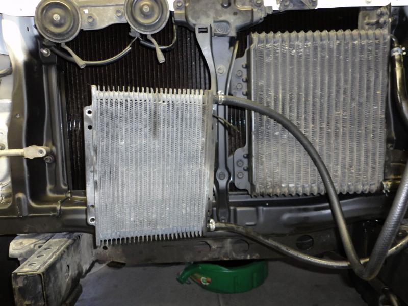

I went to PNP and browsed around for a bit. Left with a unit from a late 90's suburban (I'm not sure on the year) and it looks like it will work perfect. Every fin is untouched and straight! I tried to find another truck with one, but that was the only one...

Here's the cooler....
I'm thinking about mounting it to the left of the tranny cooler in that open space. I know you can mount an aux fan there, but i havent tackled that mod yet. I'll think of another place to relocate it when I instal the fan someday.
Ooooh, I'm not too crazy about the size or the location. You're cutting off vital air to the A/C condenser and we need all the air we can get for cooler A/C.
yeah i thought about that... Honestly, I used the AC in the Rover maybe 3 times in the 8 years I owned it. I actually thought about just getting rid of all the parts while I was in there since I never use the AC.
I can't think of a different place to put it...? Maybe under the tranny cooler at an angle. It all depends on where the valance and grill go though... :meh:
Well, this ain't a Rover so you'll have decent power while using the A/C :D In a dusty convoy situation the A/C will be used on recirc mode quite frequently- at least that's the case with me anyway.
If you had a smaller, narrower cooler, it can easily be placed in front of the trans cooler. That's a popular place for it from what I've seen.
