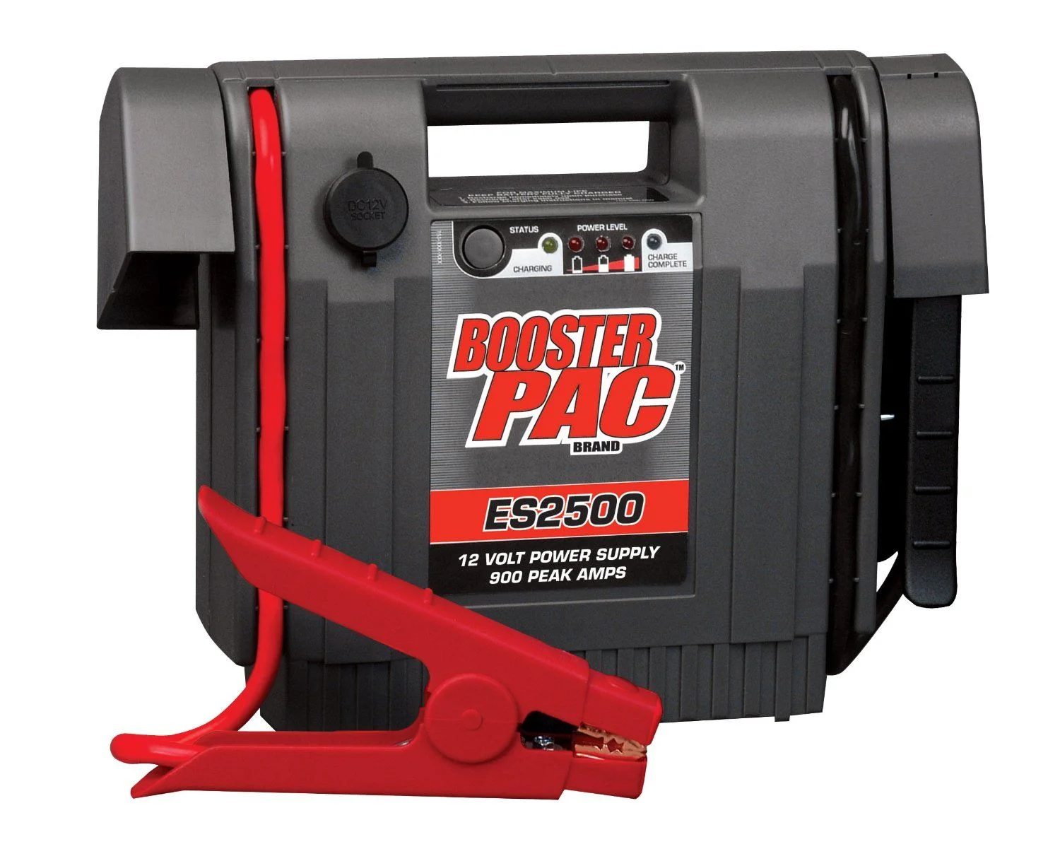

I went real simple. I've had this thing for years.

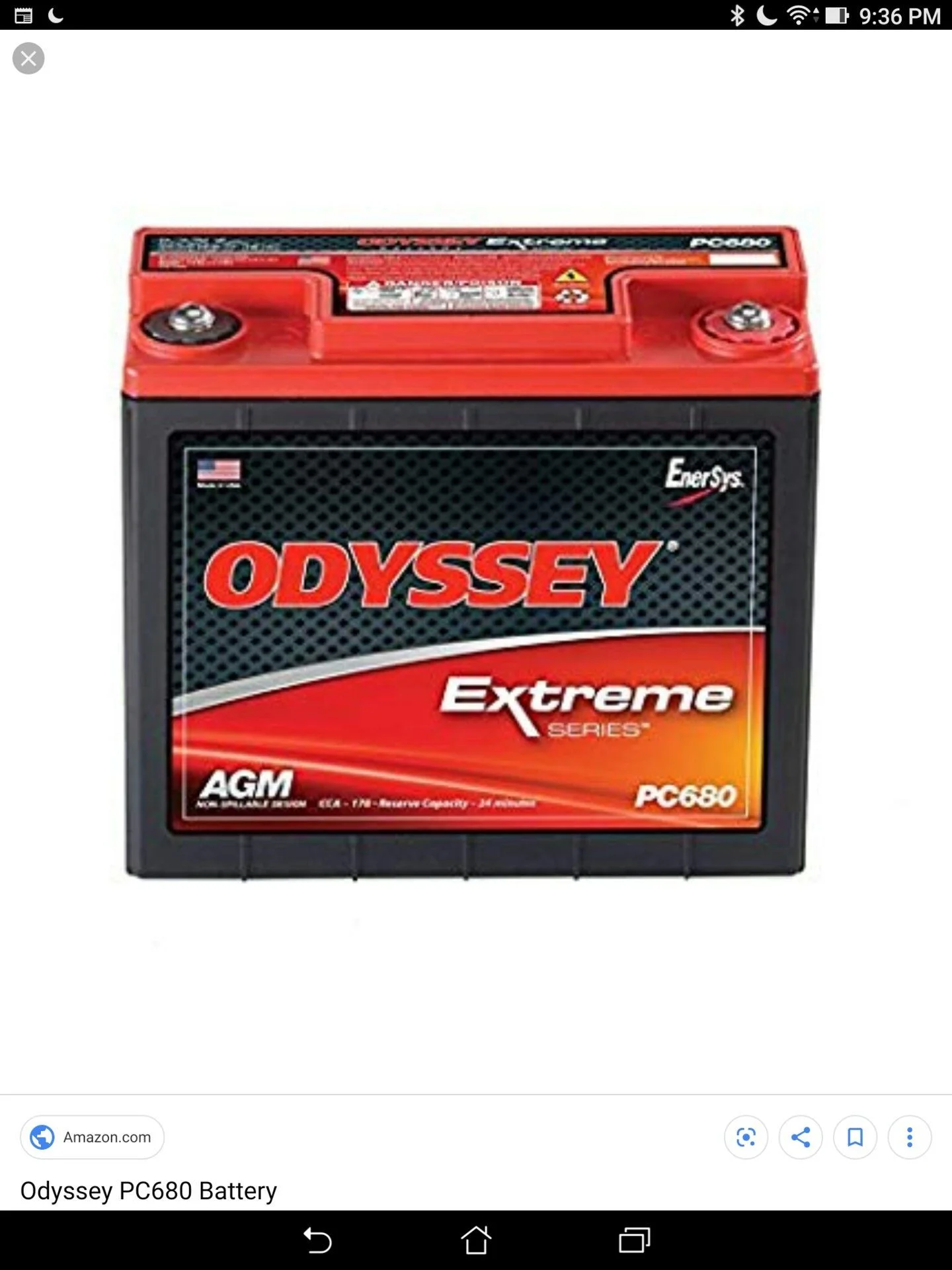

I keep an Odyssey PC680 agm battery in the truck. It packs a powerful punch in a small size. I have used it temporarily in several vehicles as the main starting battery. My first lasted 9 years and I just bought another. Make sure to evaluate the ah capacity when you compare options.

As I said earlier, I had the same Booster Pack as surfpig, above. I used it for years, to bail me out of dead/low battery situations
