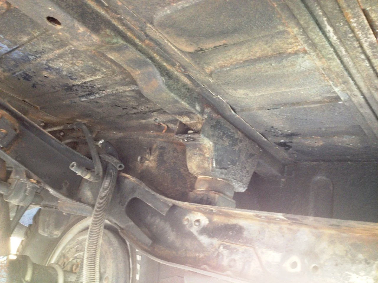

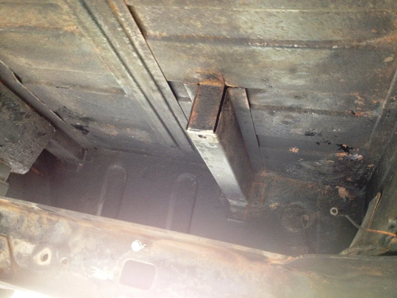

While the tank was out, this seemed like the right time to clean up the bottom of the Pig.
Make no mistake, my Pig is no frame-off resto unlike some of the stellar work exhibited in here. I really liked the look of these body mounts before I bought it, and the bottom is pretty darn clean. No matter how nice it was, the undercoating on the bottom was 40+ years old. When I dropped the tank, I took the pressure washer to the bottom and a bunch of debris came off. Last weekend I got serious about this effort and got after the bottom with a drill-mounted wire brush. Lots of debris rained down on me while I was struggling around under Pig on the creeper. Out came the pressure washer again - more debris falls off! Then a quick dry with compressed air - more debris. Wipe the bottom w/ wax and grease remover - more debris. Wipe the wax and grease remover dry - slightly less debris. :-) Apply some Chassis Saver to what looks like some mild surface rust and go mess with the lawn for 3 hours. Finally shoot the fresh new undercoat and realize I should have bought 3 cans instead of 2!
When I get more undercoat I can do a before and after set of pics...

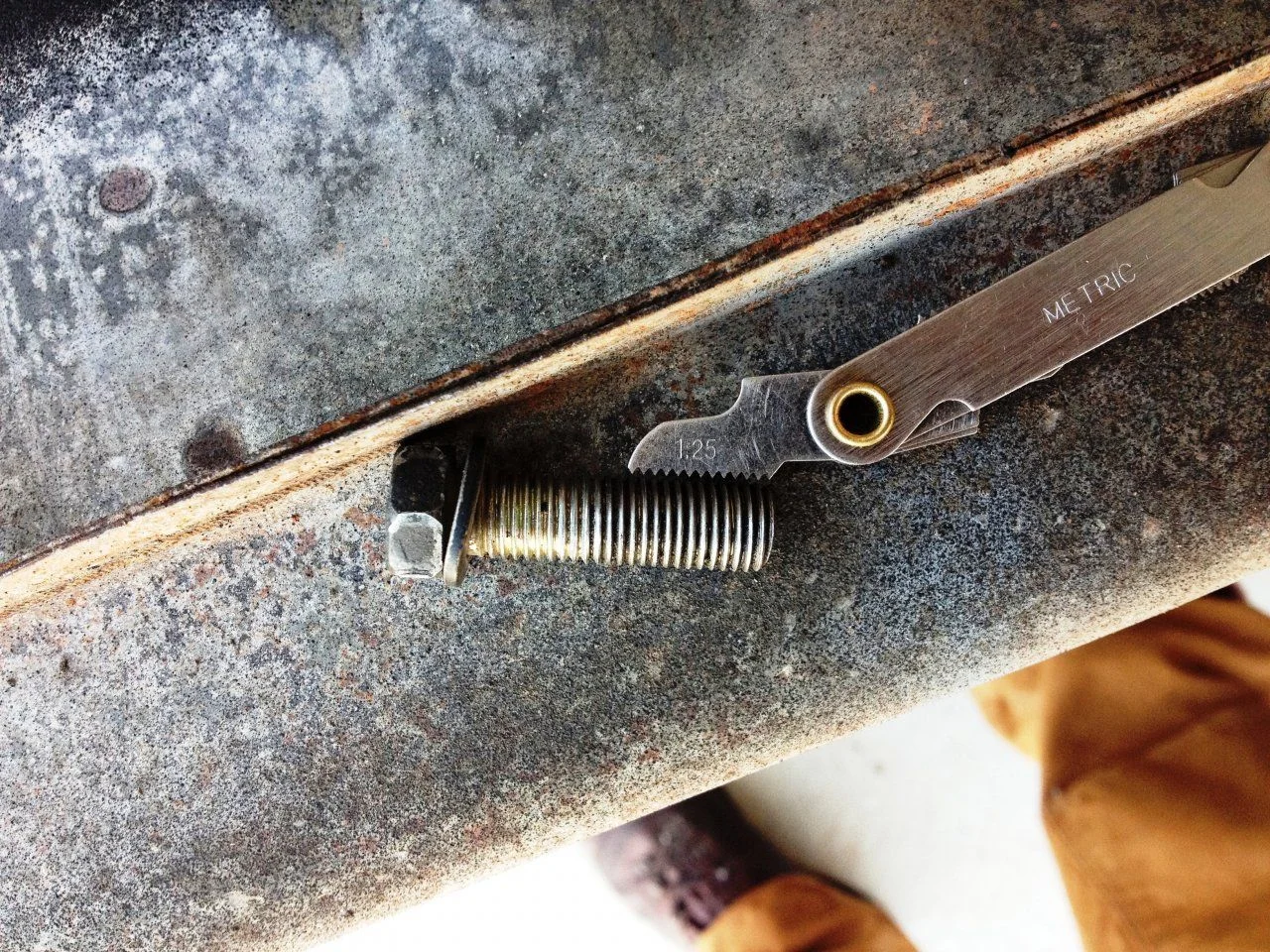

When I was dropping the tank, I got the feeling that the fasteners on the driver side were stock, and the passenger was all messed up.
First off, for my '74, the proper fasteners were M10 x 1.25, unless you were a real ass-hole, and then you could force a M10 x 1.50 into one of those holes, and then you could break off the forward passenger side bolt and then resort to a sheet metal screw to hold up that corner of the tank. I s*** you not...
I hit the JIS fastener store in Denver to get some nice new bolts. I noticed that it looks like Toyota may have set things up to run a longer bolt on the rear of each side of the tank - perhaps so you could sag the back end of the tank and then suck all the fuel out? I don't know, maybe, but I got shorter bolts for the front, and longer for the rear should I ever need to pump that tank dry again (I hope not) I will try this theory. I got an M10 x 1.25 tap to clean out all the holes as well - especially the one that someone crammed the M10 x 1.50 bolt into.
Last item was the broken off bolt. I had been applying Kroil to the top exposed threads in the hope that I could back this out. I grabbed the top of the bolt with some vice grips and was able to walk it up in the threads - then more Kroil. I was going to run out of room to get it all the way out through the top, but at least it moved! So I screwed it down as far as I could and broke out the Dremel to cut a slot in the bolt. It was a little resistant to getting backed out with the screw driver. so I screwed the bolt back in and used that drill-mounted wire wheel brush to clean all the way around the thread. More Kroil and then she screwed right out - nice!

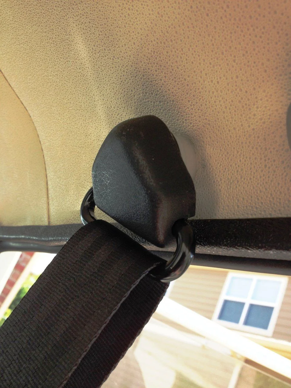

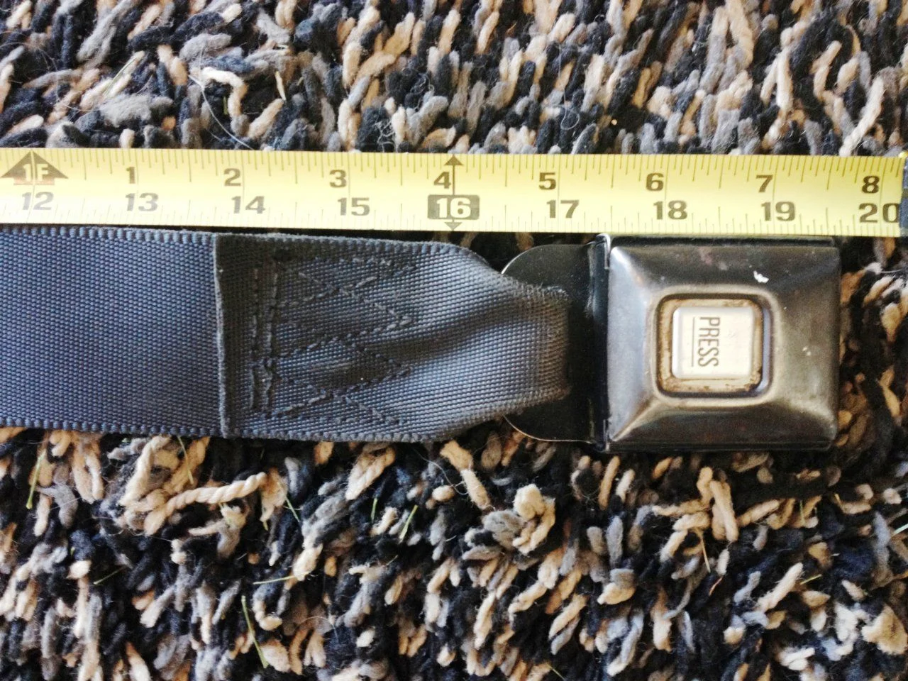

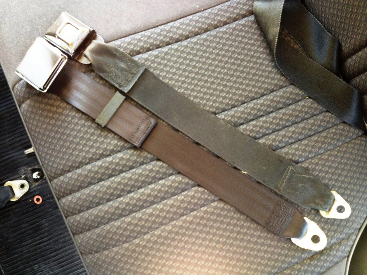

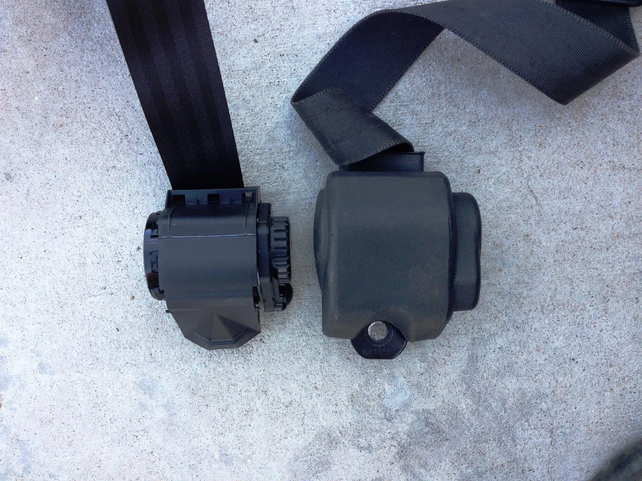

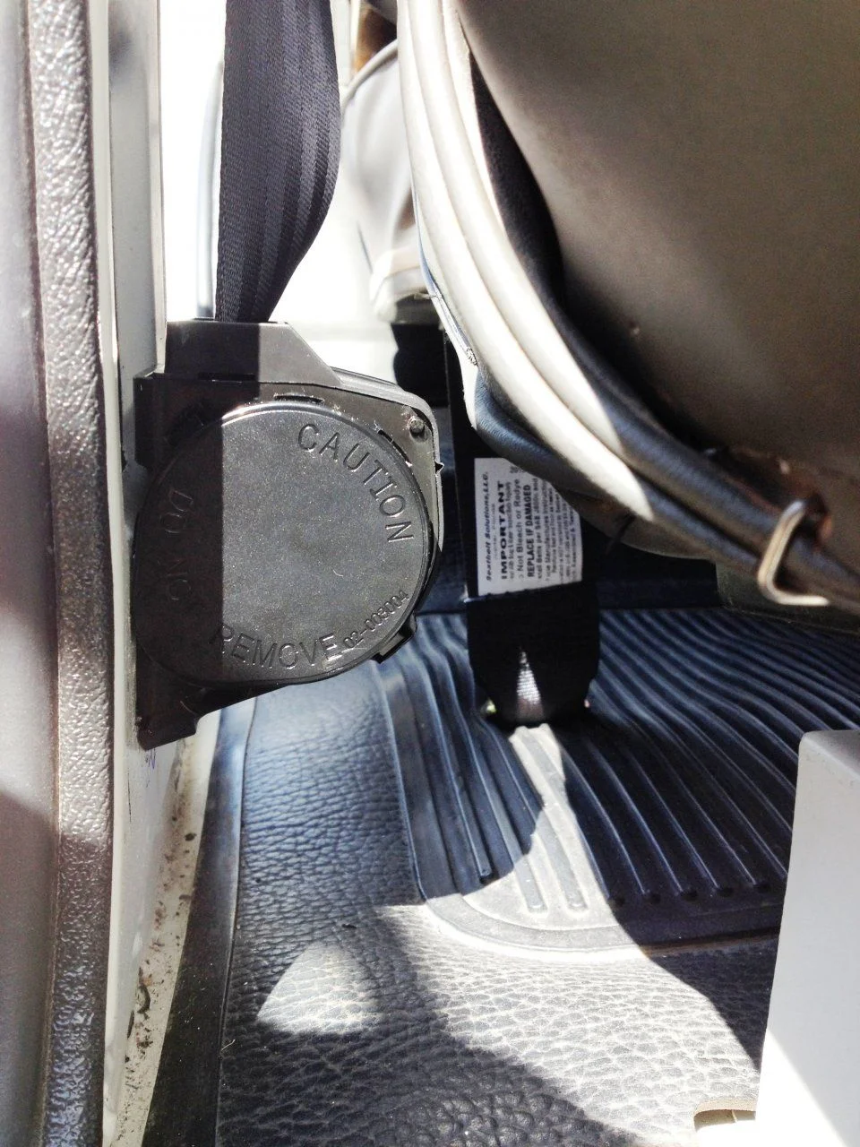

At the same time I decided to get serious about 3-point retractable belts for the front. The adjustable were okay, but a little bit of a pain. I gave up on my idea of finding some original belts after thinking about the retractors and the webbing being ~40 years old. Given that I'll have my :princess: and my child in the front with me, I decided to go for new. I was really pleased with a set of 3-point belts from seabeltsplus.com:
http://www.seatbeltsplus.com/product/WSCH300.html
I went with this set because the belts were 133" long - perfect, and the buckle end was adjustable out to 25 inches - should be nice when the :princess: drives Pig and needs the bench all the way forward.
The retractor housing is smaller than the reference set out of a '76 Pig, so they clear my bench well with the holes I added to my B pillars.

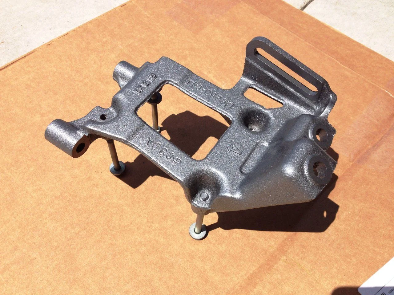

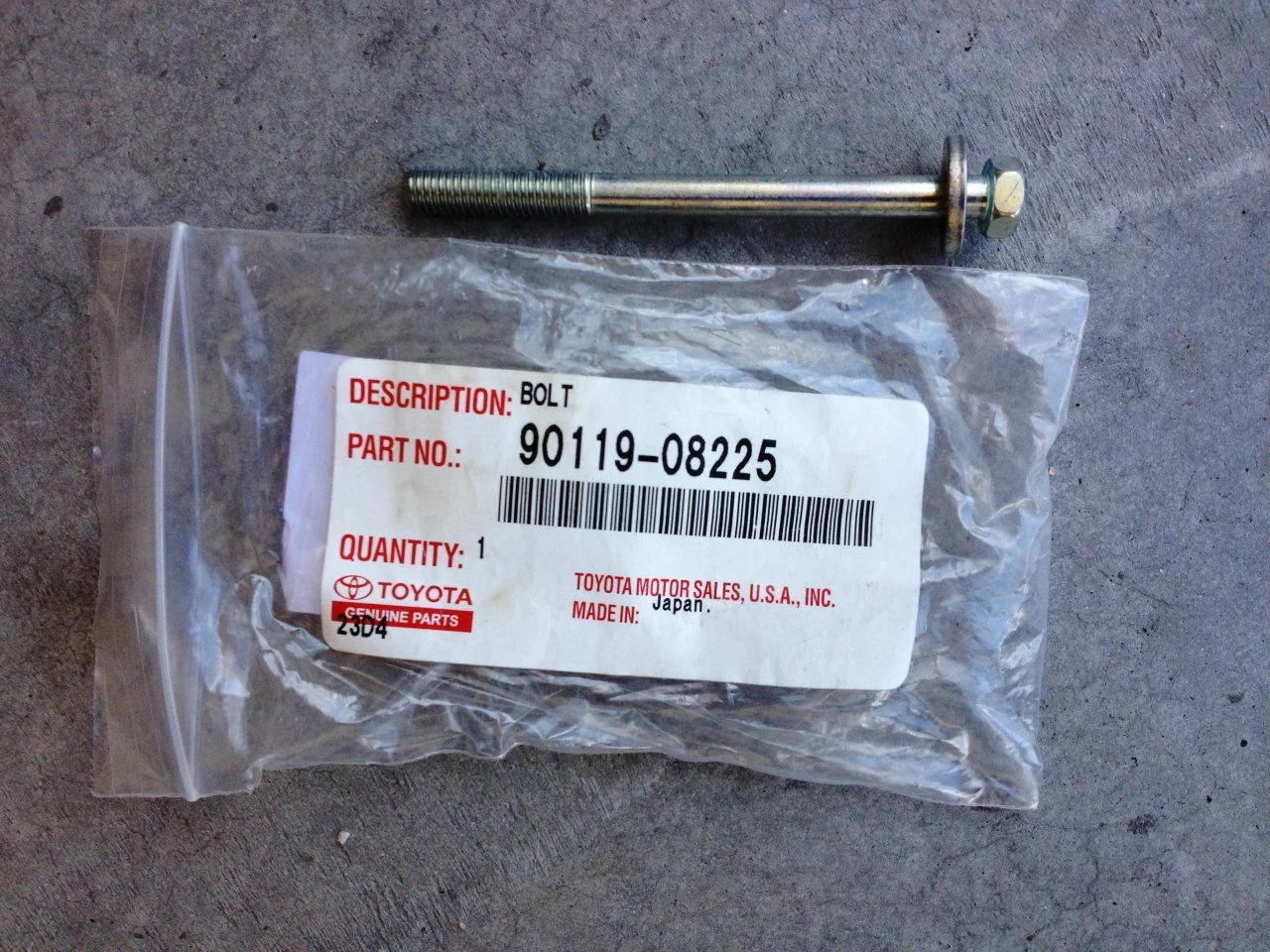

About the only other thing going on is I am still pressing forward with the idea of reviving dealer installed AC in conjunction with the 3FE AC compressor. I cleaned up the compressor bracket I got and have been locating the hardware to use this. I found the bolts to mount the compressor to the bracket, and found a used tensioner bolt as the one that came with my bracket was actually rippled! Oye...
