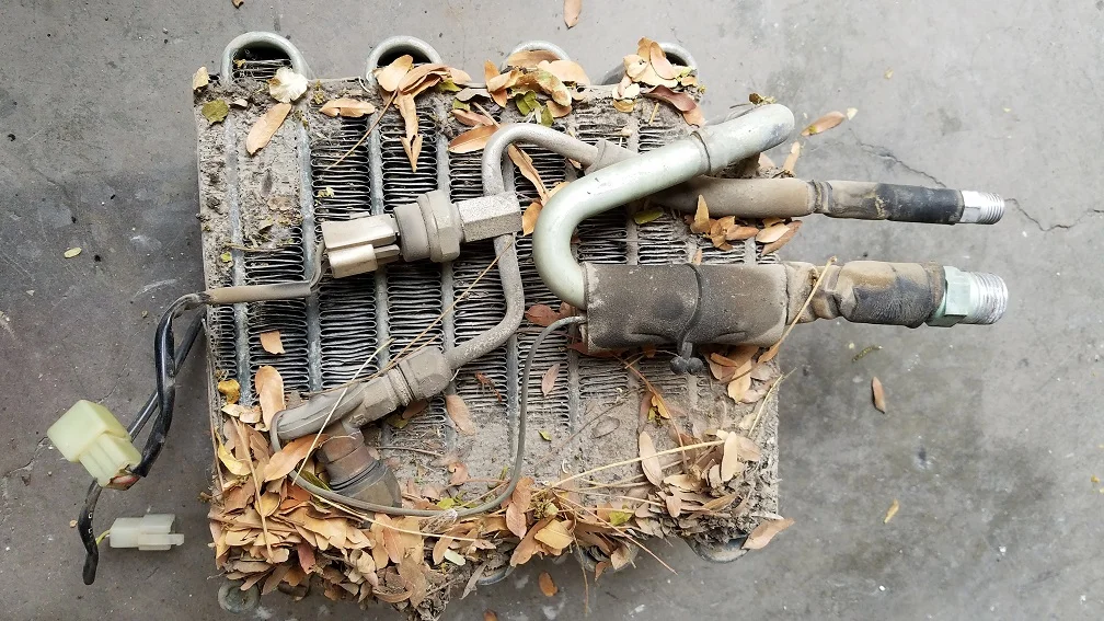

How do you know for sure the core is not plugged externally? I've seen a LOT of them so plugged with dust that they looked like a solid block. I'm in DUSTY Arizona though. The water can still flow through but, you sure don't get much air flow.
There is no air filter so dust and condensation on the A/C coil equals a plugged evap. Isn't the evap in front of the heater core? Just a thought.
This is what he is talking about. The AC evaporator sits between the fan and the heater core. It can get plugged up.
