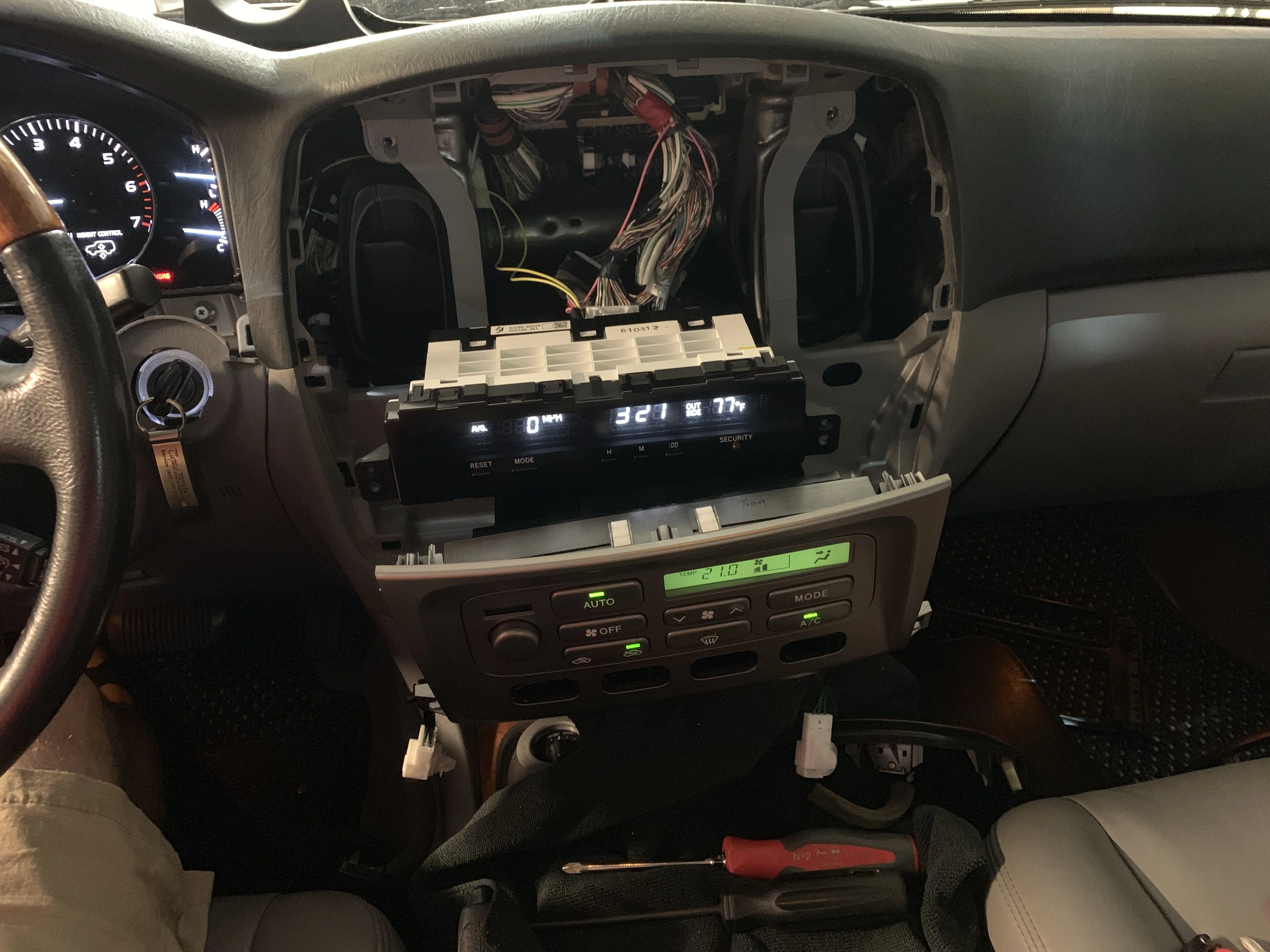

There is a button sequence to press and hold to change it. I’ll try to find it for you.
Edit again. Sorry, didn’t realize it was the bottom. I skimmed.
Edit... here.
the lower readout can't be changed.
the one thing I did find out a long time ago was other forums have info about changing the non nav into nav equipped units and then alter the ac amp to output C° instead of F° and add auto climate control.
you can leap pretty easily to the idea that it's not necessarily set by the AC amplifier and sent on to the heater panel boards.
But the combination with different AC amp boards and different heater boards between two models and a 5 year stretch makes it difficult to get correct information about which AC and heater boards go together for each specific region.
At least it was easy to stay with left hand drive.
it's C° times 1.8 + 32 = F°
easier not to translate, just accept it, know that 20 is good 35 is hot and 50 = don't go outside.
