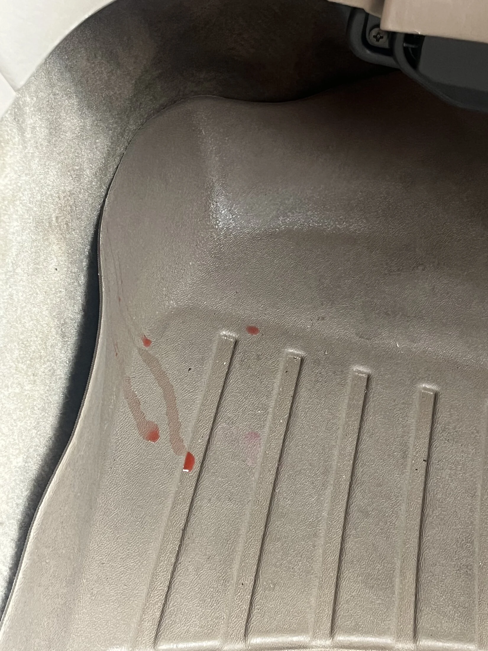

Hi All,

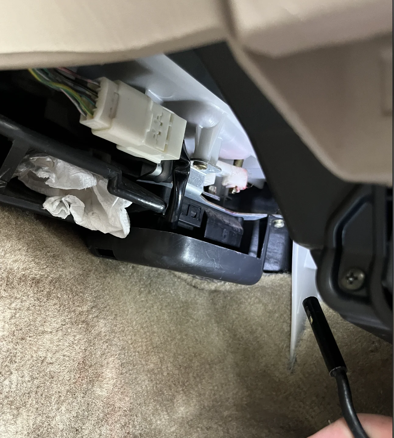

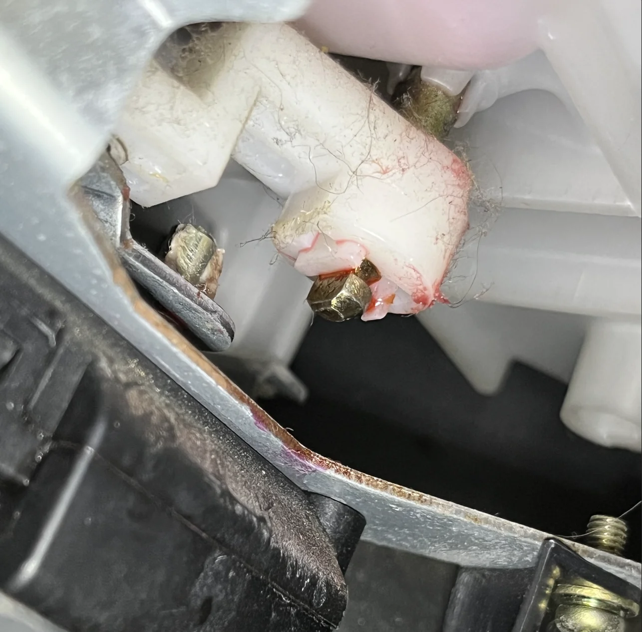

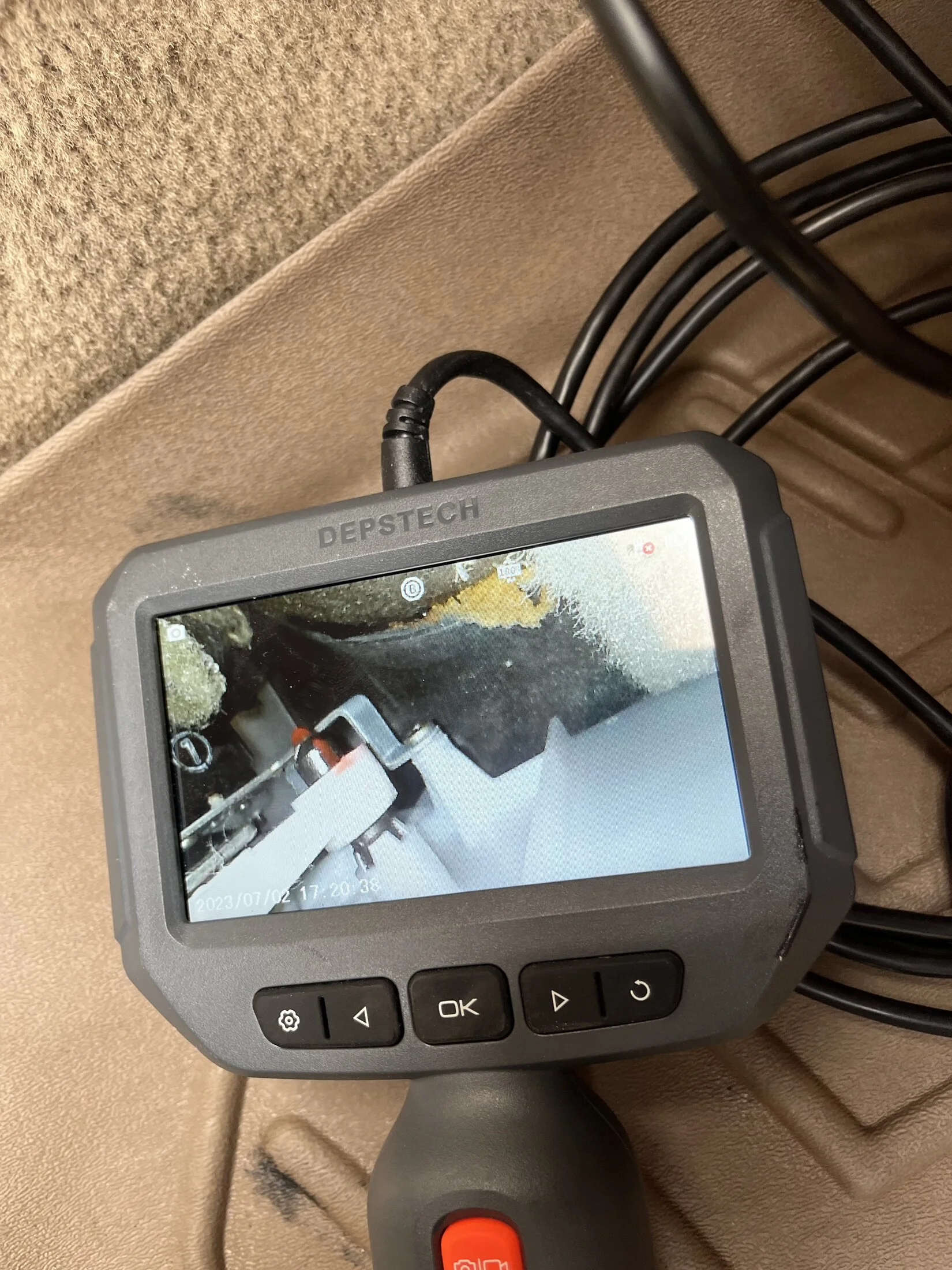

Back again for some assistance. I noticed about a week ago there were a few drops of red liquid on the passengers floormats. After searching the forums I fear it could be a heater core issue. I ran my inspection camera up there and saw what I hope isnt coolant. Apologize for the bad photos, I dont have an SD card for the camera so I had to take a picture of the screen. It looks to be multiple spots.

It doesn't look like the camera is looking inside the heater box, more under it. To see a leak you'd have to be looking inside.
wouldn't coolant on the outside of the box imply a leak from the inside? I attached a pic of what leaks down. This happened while I was at work.

Yeah, exact same as mine.
Sure looks like coolant to me.

What really gets me is that it's dripping in 2 separate places which means it might be above? Maybe this weekend i'll pull the HVAC controls and head unit out and see if I can get my inspection camera further in there.

update, I found the trail and where the coolant was pooling up. To the left of the evaporator, just above where the passengers feet would sit. Gonna try and follow it further but I still am going to bypass the heater core.
