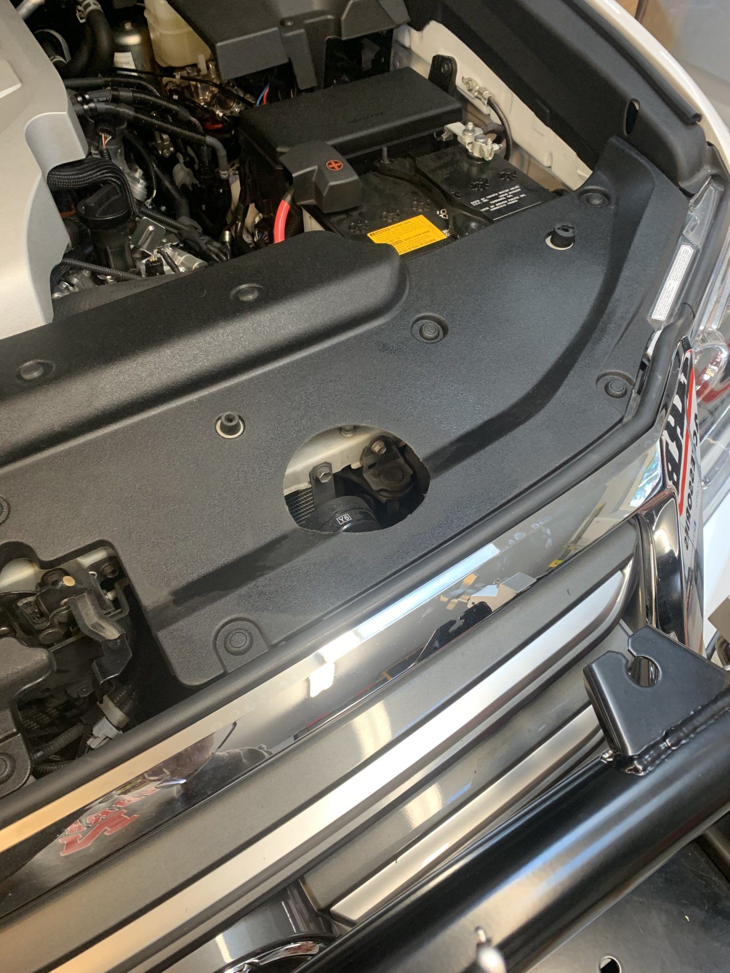

Follow- up on this thread. Ended up making a few mods to the plastic panel to ease accessing the overflow bottle and radiator cap. These will not affect airflow through the radiator - the overflow is on the inboard side and the air was not blocked around the radiator cap, anyway. MUCH easier to check coolant levels now.

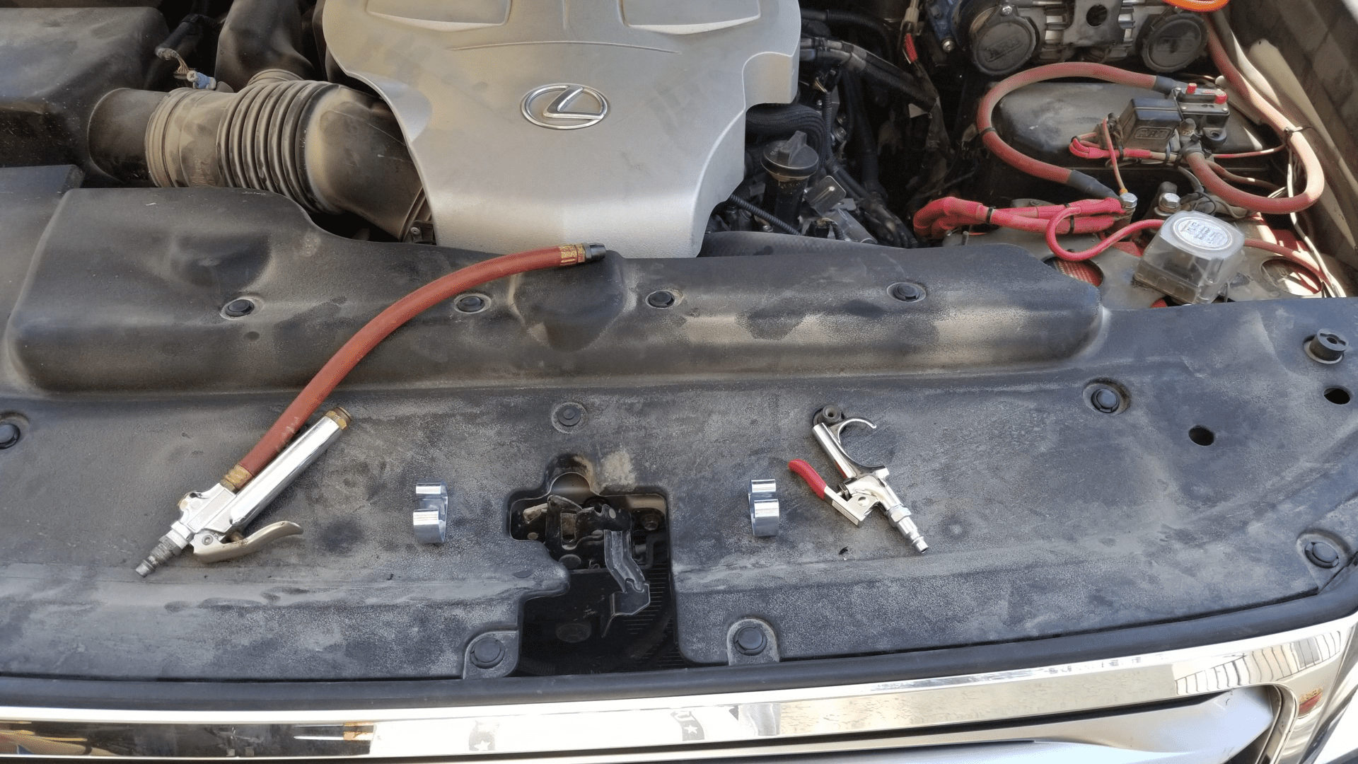

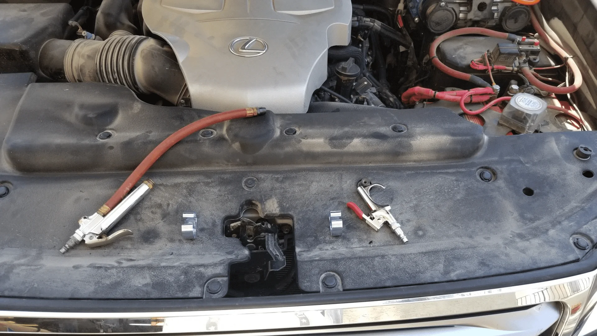

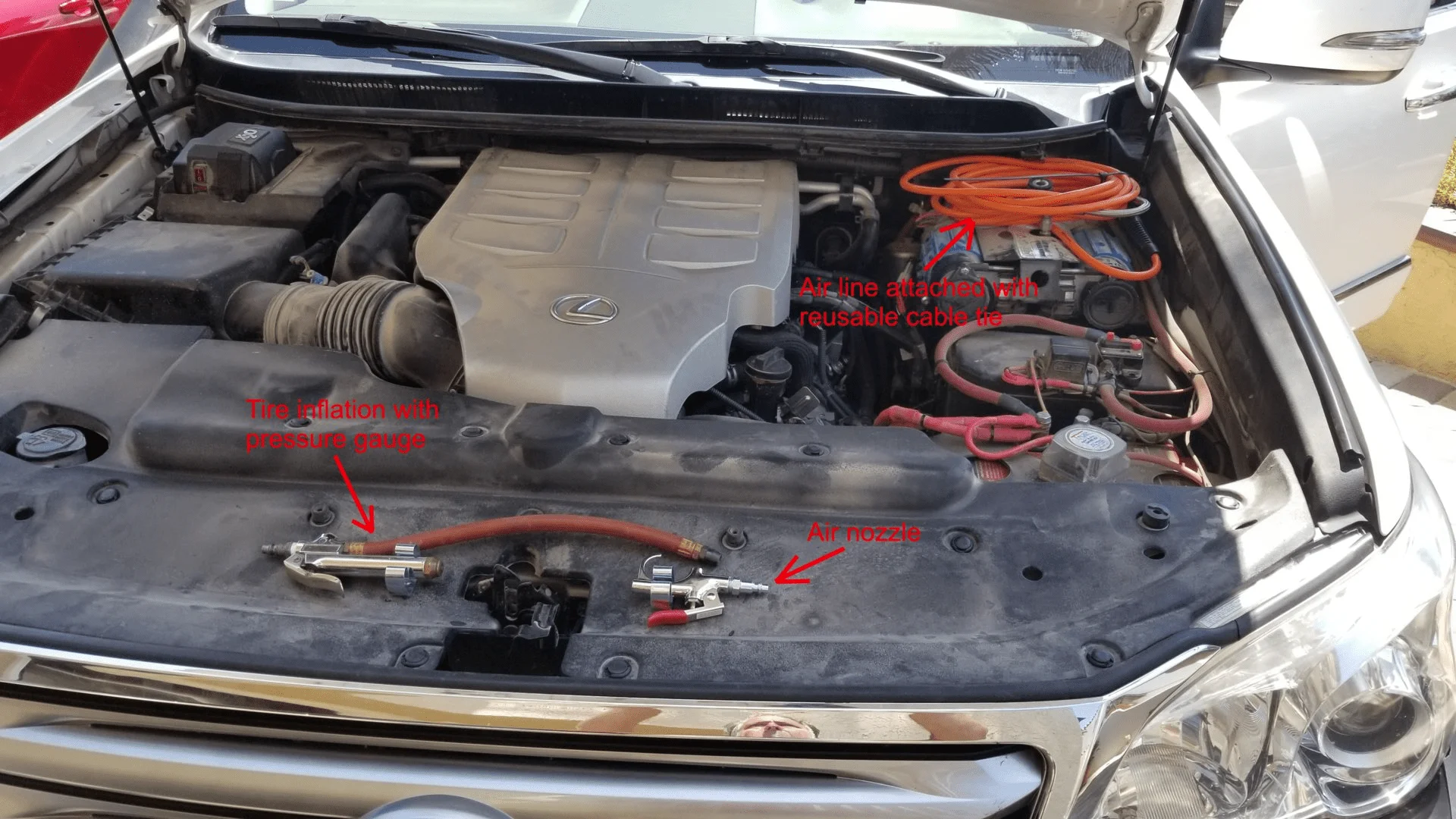

If you should bolt an air compressor under your hood, you use that plastic piece to mount your compressor attachments!

I trimmed mine around the radiator fill cap for ease of access.
