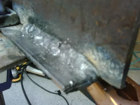

I bought a welder a while back with the intention of building a rear bumper and then moving got in the way. Now I am just about ready to roll. Bought most of my steel parts over the weekend, but I think I may have to go to 3x5x 3/16" thick steel for main bumper. We will see.
Here are my welds, let me know from the experts out there what you think.
A few of the thick ones are double welded.

One question I do have is when you are welding say a 6 foot section, do you have to weld the entire seam or just sections if it is not a high strength area. Reason I ask is I am concerned with warpage.
A
I'm certainly no expert on welding (Josh will attest to that) but I do ok. If you're concerned about warpage weld a spot and then move to the other end, weld another spot and work your way around. I think it's called a "skip weld" but those who know will set me straight I'm sure.

Ted's advice is on target. Also; your design, material selection and welder (stick versus MIG or TIG) may be critical for welding techniques. If you can arrange it, you may want to review your design and plans with an experienced fabricator to fine tune the details.

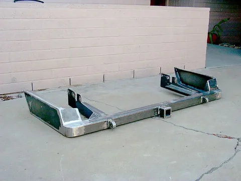

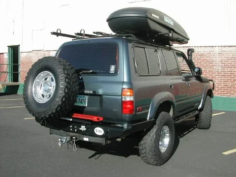

Here is what I am considering along with a gas carrier.
Start from Post 12
https://forum.ih8mud.com/95-gen-toyota-trucks/291658-looking-rear-bumpers.html
And the simplicity of this one
Andrew,
Don't forget about your recovery points. The bumper that you provided the picture of is using ~3/4 inch thick material for the recovery points. That seems to be the standard that you see on most bumpers. For the bumpers on the BJ70, I only used 1/2 inch but my recovery points are also my frame attachments. This lead to my use of 1/2 inch material because it offered more dimensional options for the raw stock and suitability for the application. You will be working through those details and a number of others as you dive in.

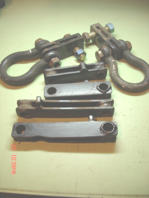

Very helpful picture and strength gained by the thick attachment points are a good idea. I have 3/4"tow points from iron pig,
but they would not be long enough to mount to the frame as they are about 3.5" x 6" overall.
My plan is to cut into the 2x5 tube steel bar to mount the tow points and the hitch receiver, I guess some surgical cutting into it. I could tie the 4" angle iron to them and weld the entire thing together.

You can also use the receiver hitch as a recovery point as long as you reinforce the welds and make it strong.

Andrew,
The DIY recovery points from IronPig seem long enough to pass through your bumper. What I mean is you would cut aligned holes through the fwd and aft surfaces of the tube, so you could weld the perimeter the recovery point to both surfaces. The result would be more weld surface attaching the recovery point, plus the recovery points would be welded to a total of 3/8" of material with the final welded tube-recovery point would be more rigid than the basic tube section.

I was thinking that as well, kinda a trilogy. Probably overkill on my end of things.
Of the 3 bumpers I've built, all of the shackle recovery mounts go thru the bumper & attach to the frame via 3/4" grade 8 bolts. The top one's w/ the shackles are for the 40 & the other 4 are for the :pig: I used 2 pieces of 3/8" for the 40's mounts & 1/4" for the :pig: I'm using a receiver mounted shackle for the rear of the 40 as I only have bumperettes. It's bolted to a 1/4" channel running transverse on the frame using 4 grade 8 1/2" bolts. Just another :idea: for 'ya. I wanted to take the load off the bumper when a snatch block will be used & rely on the shear strength of the bolts & material used. Build is lookin real good so far :bounce:

These are great ideas. One challenge with the 4runner is the frame does not extend to end of body, about 3" short I think. Hence, using 1/4" right angle bracket butted up against the bar and welded. I am envisioning 2 options
1) I could get fancy and do a cut out (on right angle frame bracket) so the bar lays on top of the horizontal portion of the right angle bracket and it would increase the welding area
2) Cut some 3/16" plate triangles and weld to bottom of both tube and right angle bracket.
Thoughts?
