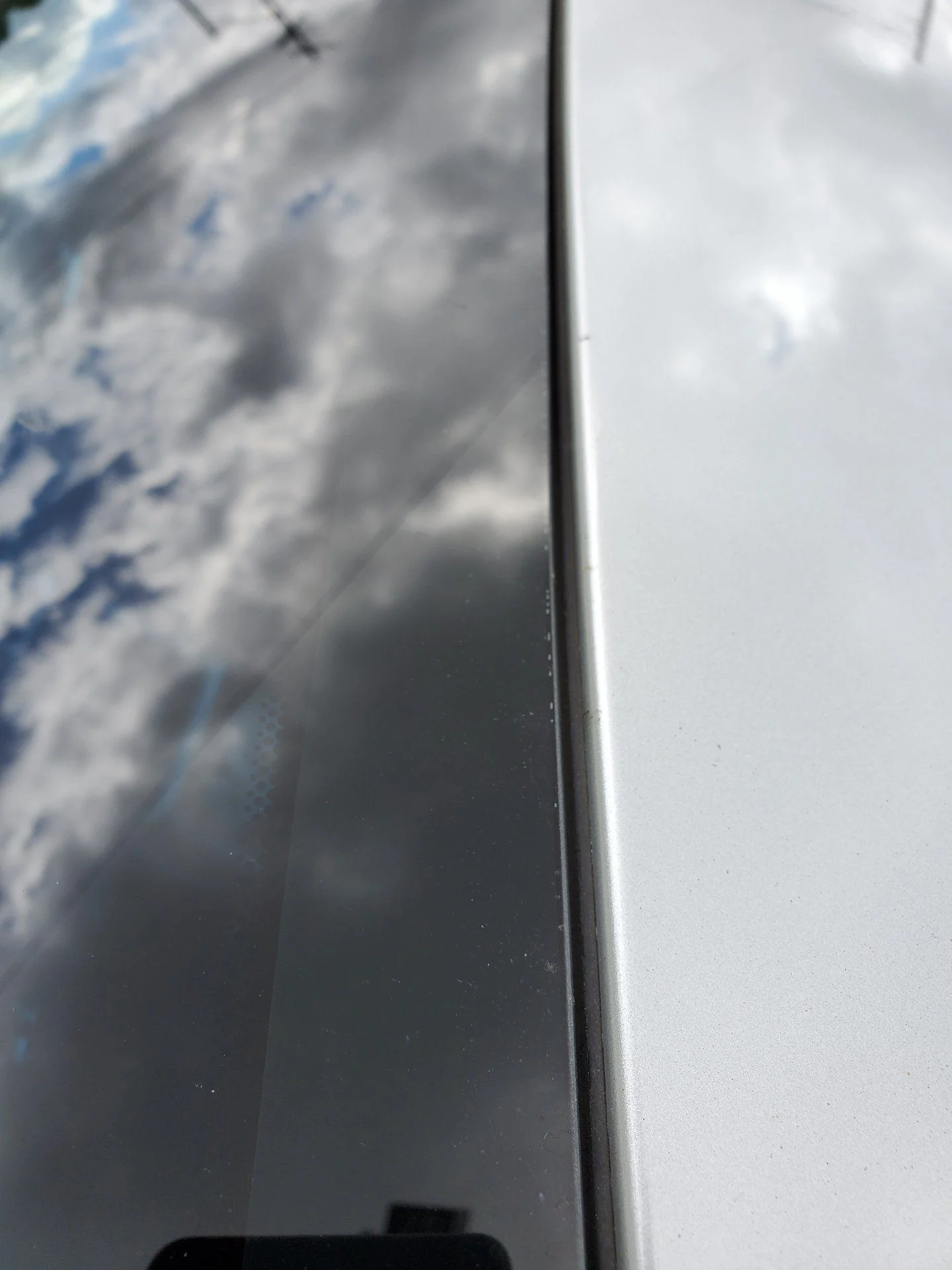

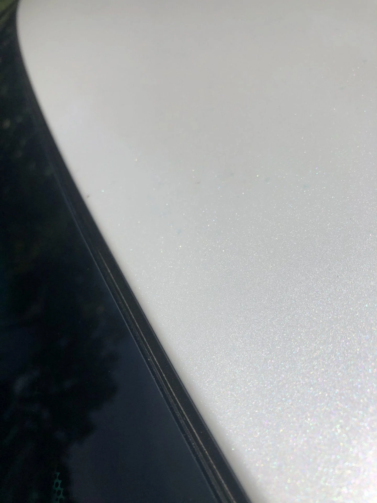

Check seams at the top of the windshield as well as corner molding pieces in the lower left and right. All should be flush and true.

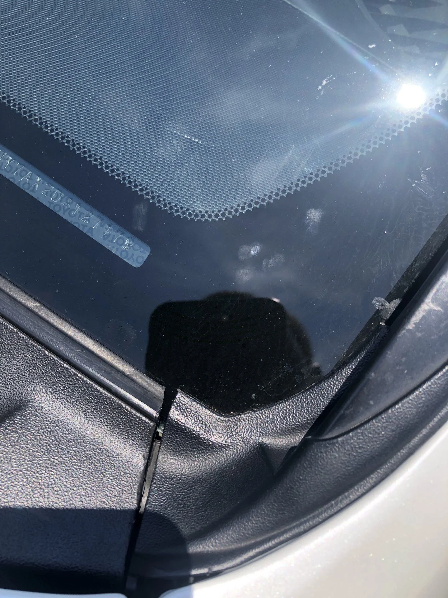

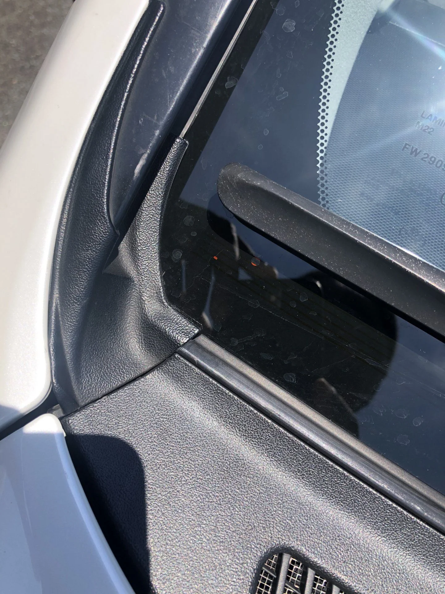

Some pics of the molding does this look off to you?
They got the top trim right at least. On mine completely wrong aftermarket trim was causing a loud whistle at freeway speeds. Maybe also confirm the garnish along the sides of the windshield is all straight and attached well.
In all likelihood you are dealing with what 40Man describes.. it's just not up to OEM specifications.
